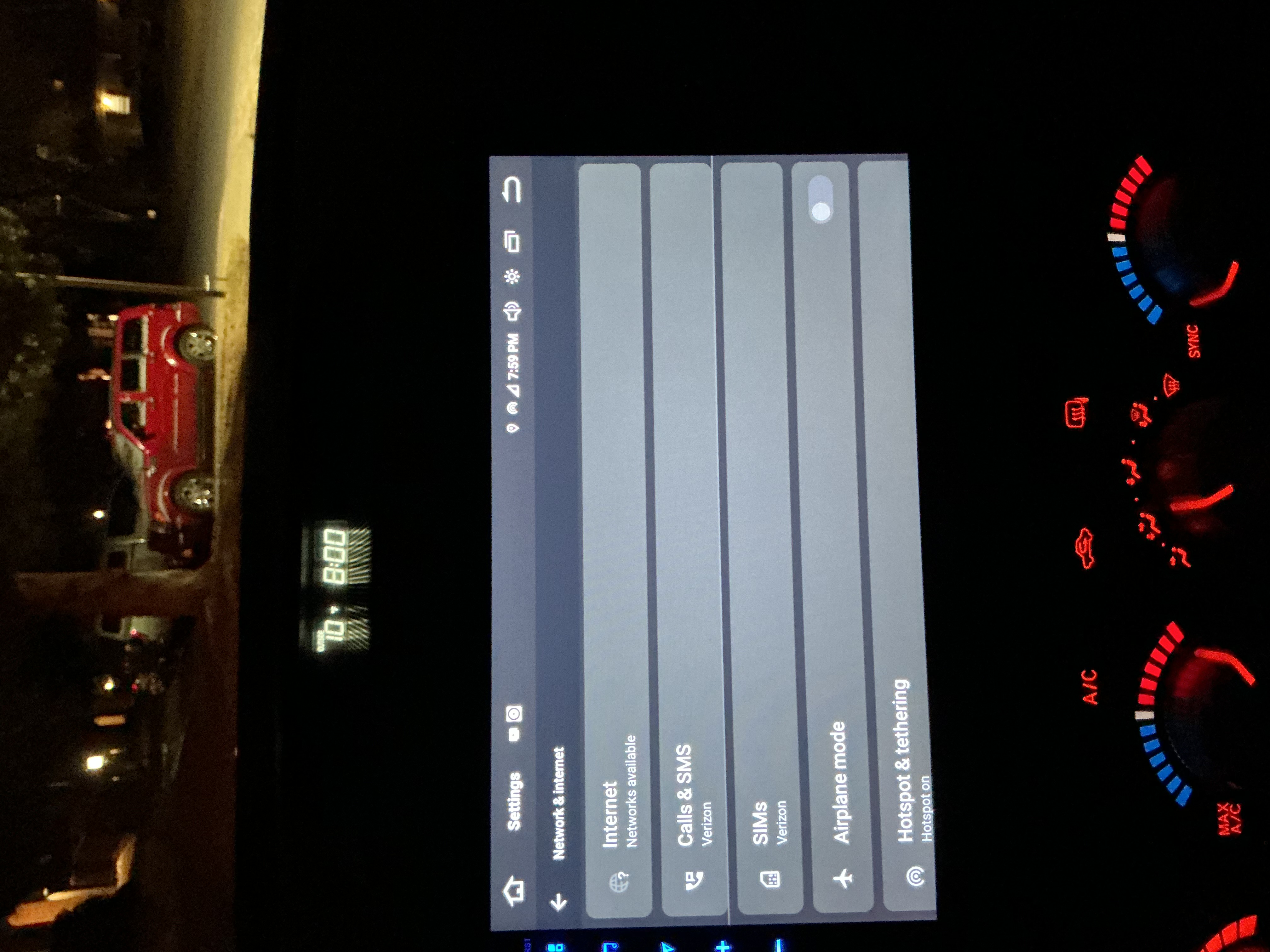

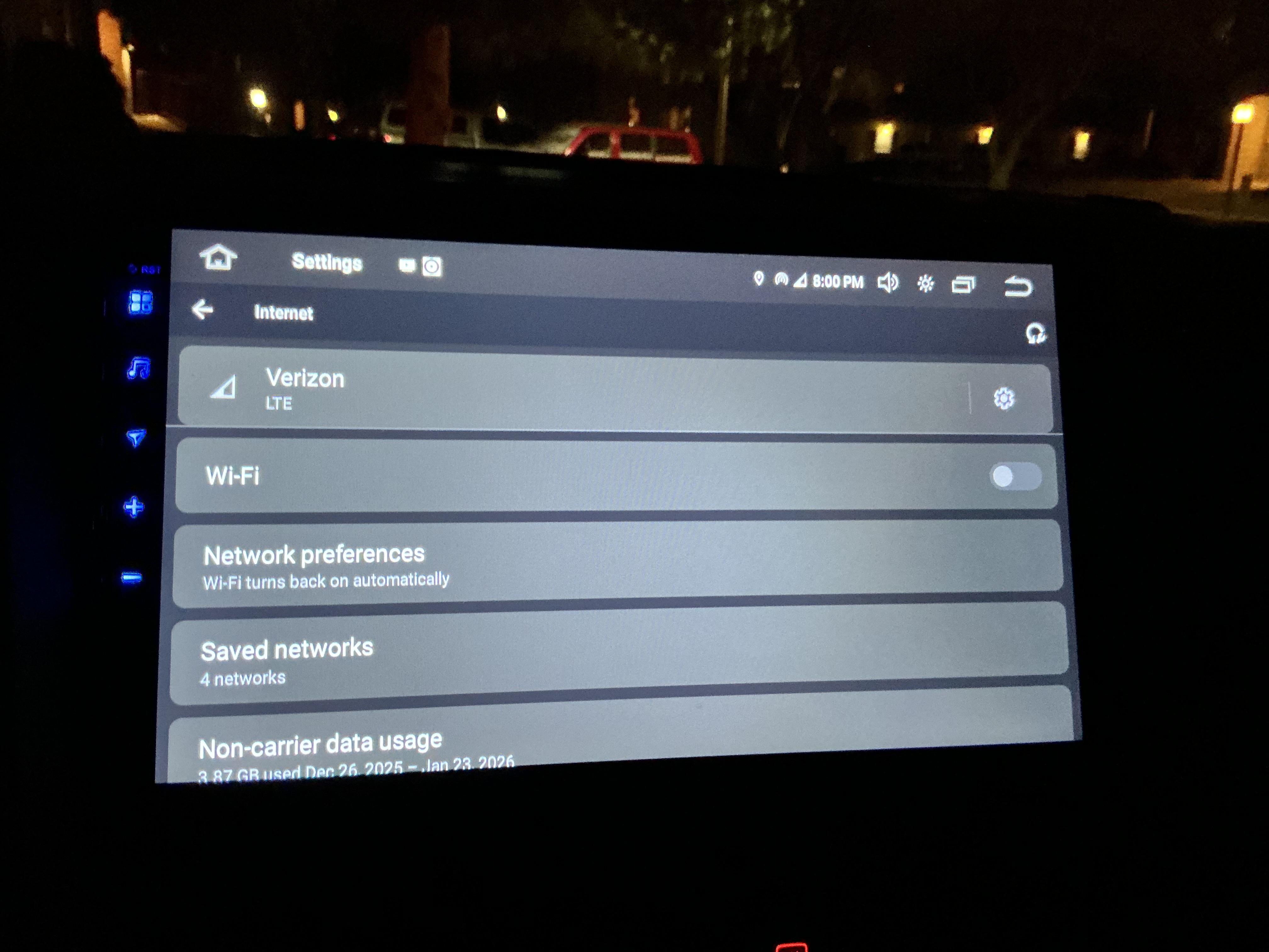

    After reading almost all posts about SIM issues and workarounds, though not much on the G13 08 Toyota Tundra version or V2, but I decided to give it a go. No pins on the SIM, it's recognized by the system, shows up on the Home Screen as if it is connected to data, but does not provide mobile data.
    Purchased 11/9/25, order #SP-DA754 on Dasaita website, I believe it went through an update after installation, and connected to home wifi.
    Network set to LTE, Factory Settings > other > SIM card voice call - YES, APN looks correct, at least with the Verizon SIM, tried AT&T also and it was recognized too but would only show a temperary not in service in SIM setting.

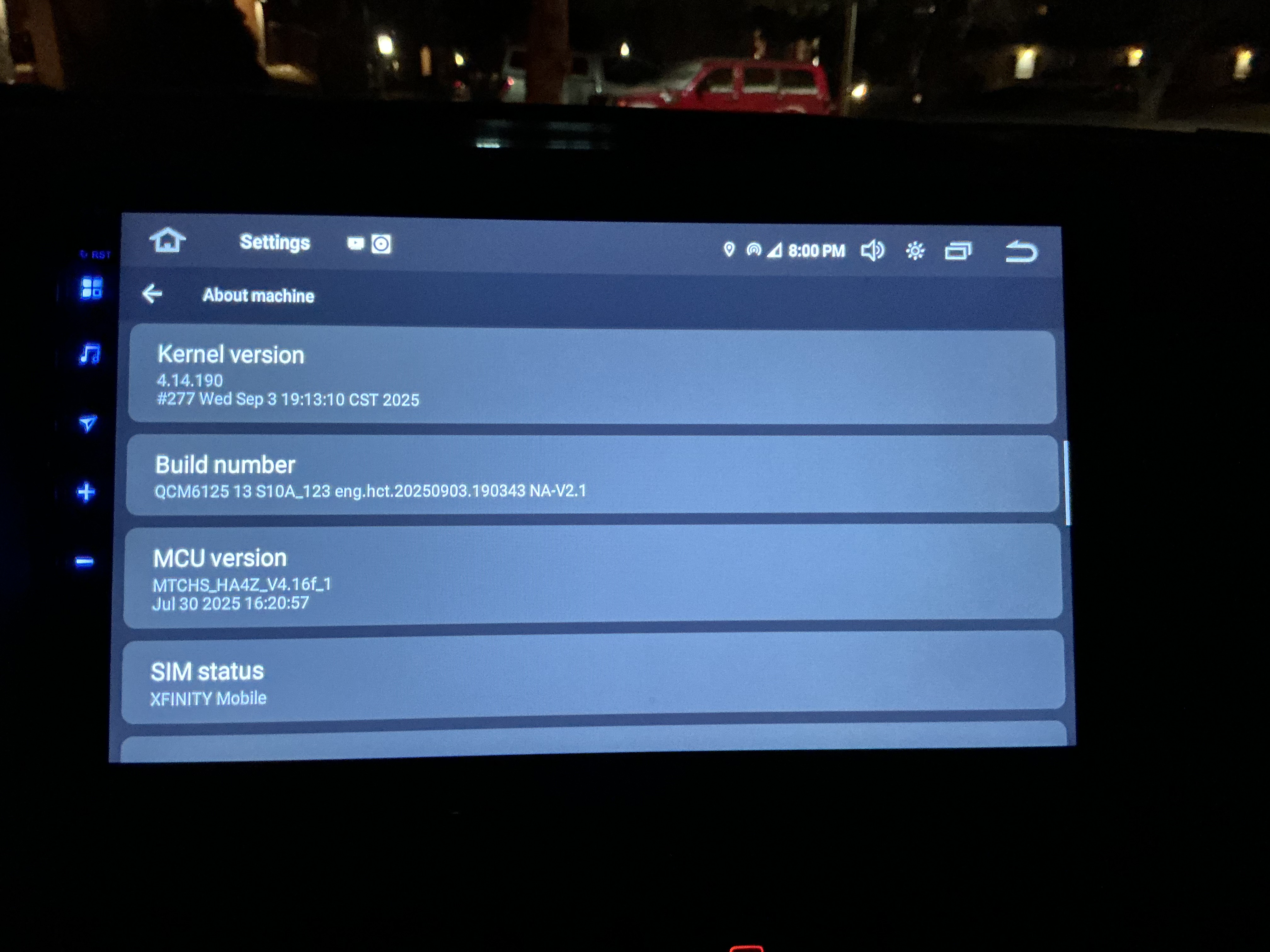

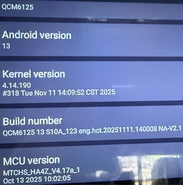

    Build - QCM6125 13 S10A_123 eng.hct.20250903.190343 NA-V2.1
    MCU - MTCHS_HA4Z_V4.16F_1

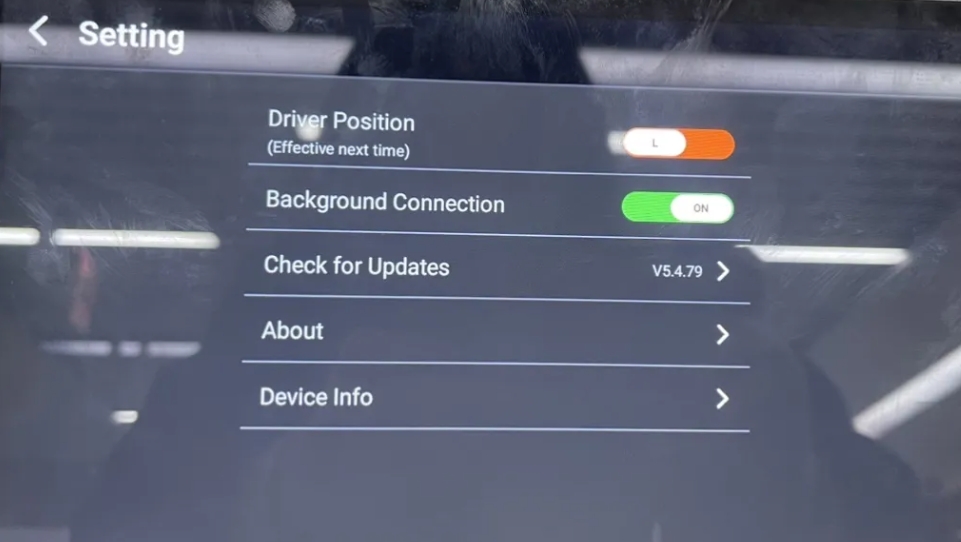

    1. Please go to CarPlay settings and turn off the Background connection.
    2.You could show us video to demonstrate the situation so that we could better confirm.
    3.When you plug in the SIM card, you must restart the Dasaita unit: settings > car settings > factory settings and put "hctreboot" as password.
  • I cannot add video in this forum. Zlink background connection is off, have rebooted with hctreboot. sim still says temperarily unavailable.  I am noticing now that I cannot connect to bluetooth while connected to the head units wifi. I was trying to turn on BT Tethering, but it will not stay on. Says it's on but when I click into BT Hotspot/tethering it's always off and mostly cant click to the on position. If I could connect to the unit's wifi hotspot and use bluetooth for data access that would be great.

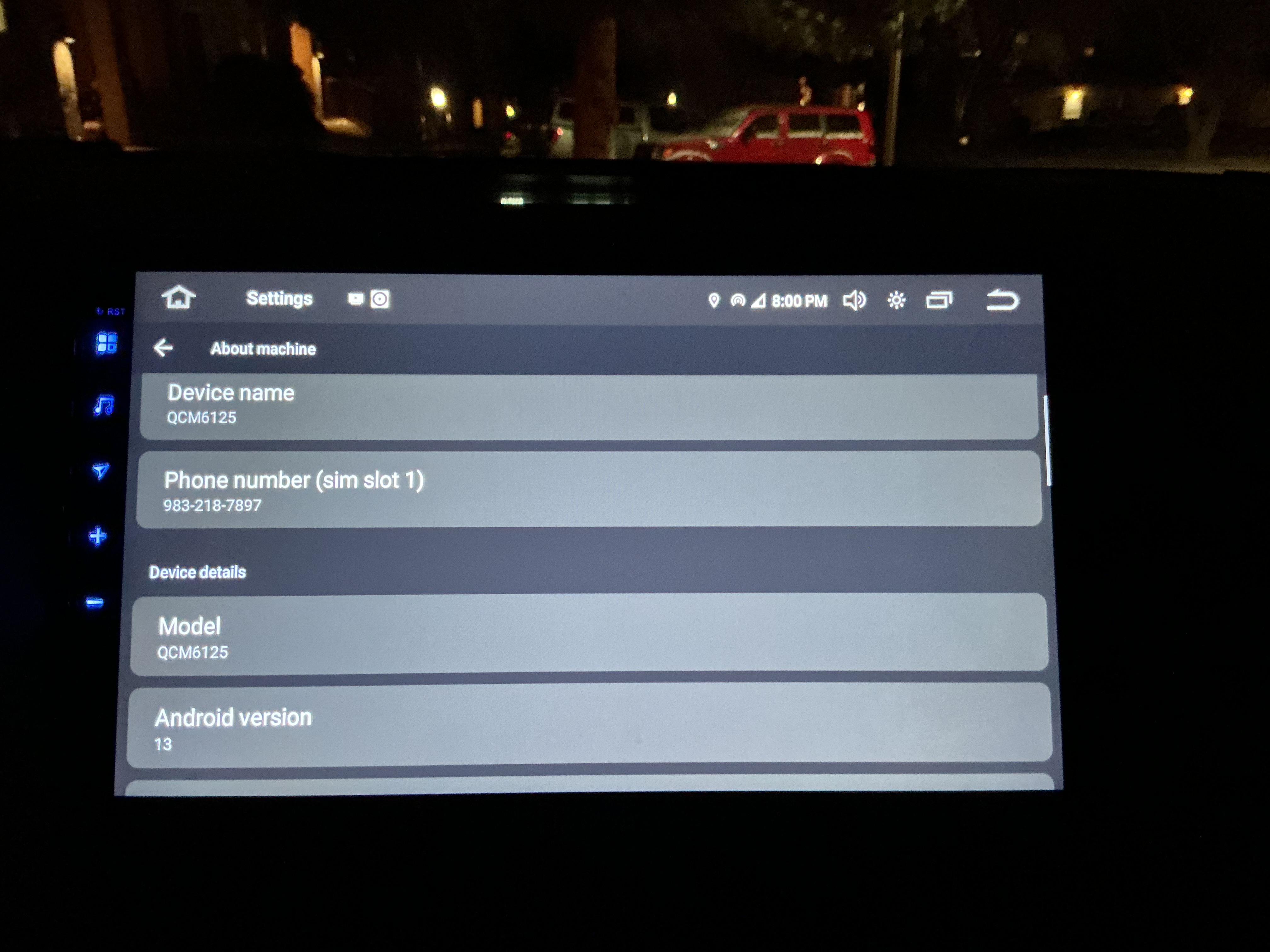

  • Just checked the IMEI on the unit, it does not have the IMEI as you are showing, it has MEID. There is an IMEI associated with that tab and an IMEI SV OF 01, MEID is unknown.

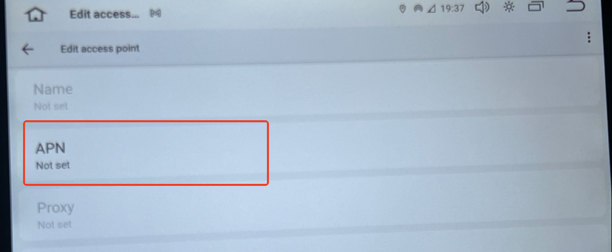

    Follow step to add the APN :
    https://speed.is/us/t-mobile/apn/
    We are still investigating the compatibility issue with T-Mobile service. We'll keep you updated once we have progress.
  • @Support Dasaita In my case, both a TMobile SIM as well as a Tello SIM (MVNO for Tmobile) does not work. Both SIMs are recognized as active, but APN's cannot be edited (at least on the Tello side). Why is this so difficult to resolve? I have spent well over 20 hours trying to troubleshoot this problem with TMobile as well as web research. How is it that you have a device that is popular in the US, looks awesome installed, has worked very well for 10 months (in my case) but now falls flat? This is now a $500 AM/FM radio and backup camera monitor. And the sensitivity of the FM portion is not great unless the radio station has an ERP of 10000 watts. PLEASE CAN WE GET THIS RESOLVED?!
  • Dasaita knows very well about this simproblem. Why cant they admit it. Stop fooling around. If your simcard doesent work give up to waste time trying all the bluff tips from Dasita support.
  • Followed the Dasaita support steps to add the APN manually like 5 times already. I even had Tmobile send me a new SIM... still nothing...
  • @renaldo rivera
    We sincerely apologize for the inconvenience. Our team is conducting intensive internal tests. This issue requires coordination with T-Mobile and data reconfiguration to restore full compatibility. We are working on a fix urgently and will notify you once we have the latest solution.

    • Updated to the latest firmware: no change.
