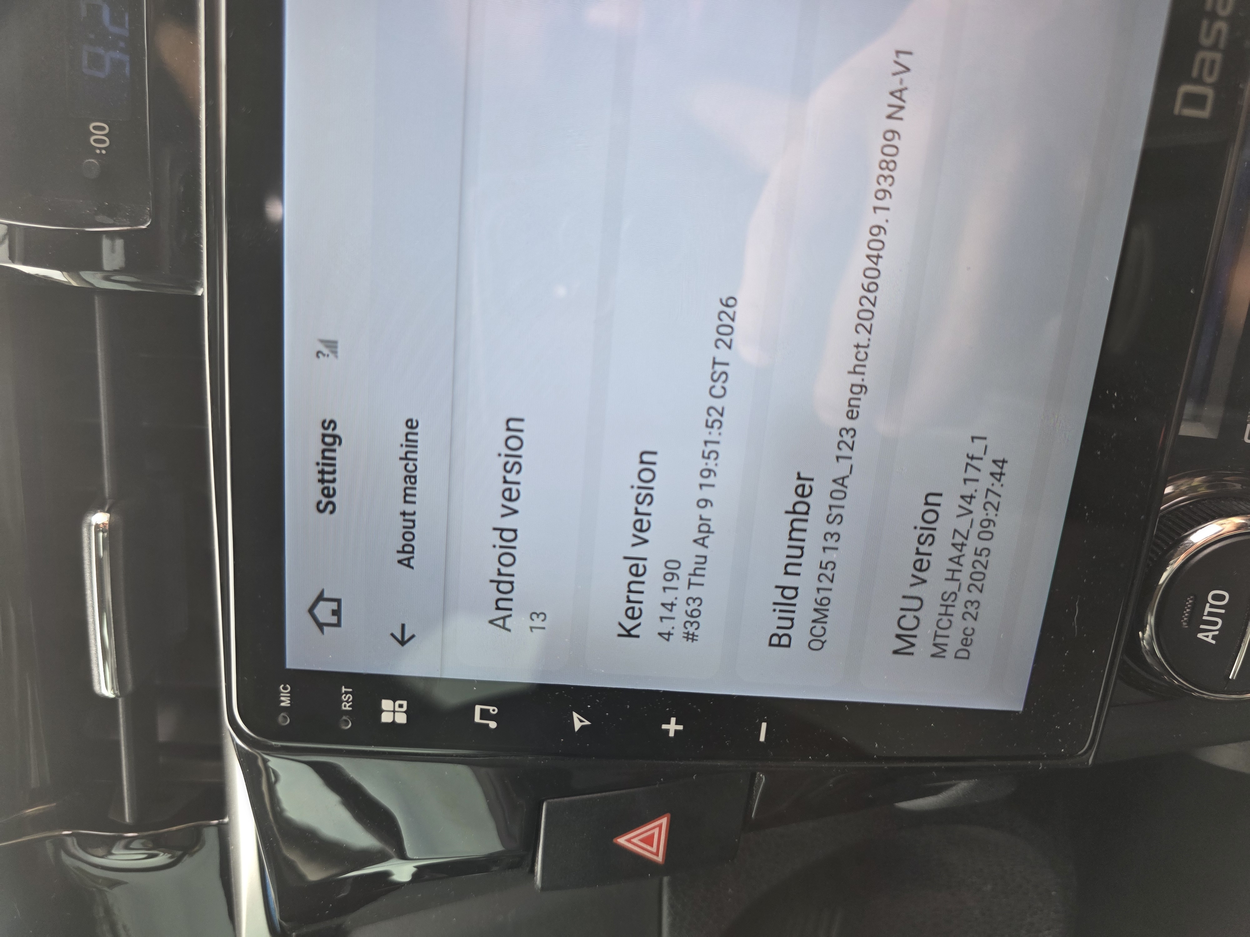

  • Dasaita is working on the T-Mobile sim issue which, apparently, is due to a change T-Mobile made to its system.  As many of us G13 owners have found, roughly a month ago, all of our sims stopped connecting.  This was true for any sim that uses the T-Mobile network, e.g. Speedtalk and Tello.  The interim solution that I've found is to use an Internet of Things (IOT) sim from a provider that uses AT&T.
    EIOTClub has dual network sims that provide AT&T and T-Mobile. I got one of their sims from Amazon and tested it in an old Samsung Note 8 phone.  For it to work required creating a new APN set to america.bics and turning on Global Roaming.  It registered immediately.  I removed the sim from the phone and put in my G13.  I didn't have to do anything -- the G13 immediately recognized the sim, registered it on the AT&T network, and I've got internet via LTE again.
    You can get a 300 MB sim from Amazon for $5.  If it works for you, you can buy a monthly plan.  As I don't need much data, I got a 2GB / 30-day plan for $10/month.  This a bit more than I was paying with SpeedTalk and Tello, but it works. :)
    Don't forget to restart the G13 after installing the new sim.
    I have no connection with EIOTClub, other than I bought a plan from them.  There may be other AT&T-based sim cards out there that will work, but EIOTClub was the first I tried and it works well.
