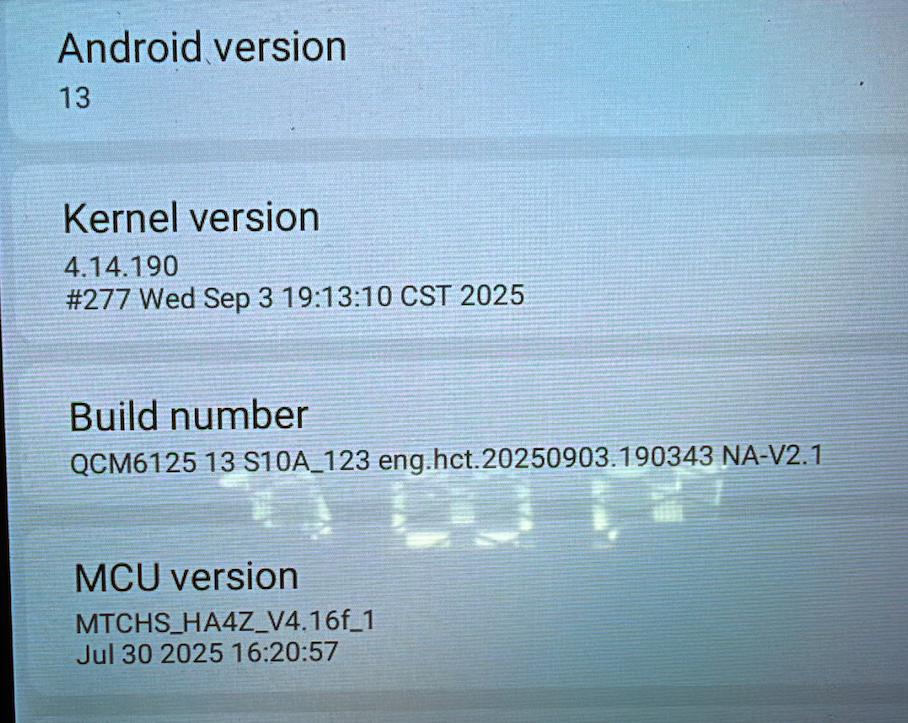

QCM6125 Android 13 G13
MCU MTCHS_HA4Z_V4.16f_1

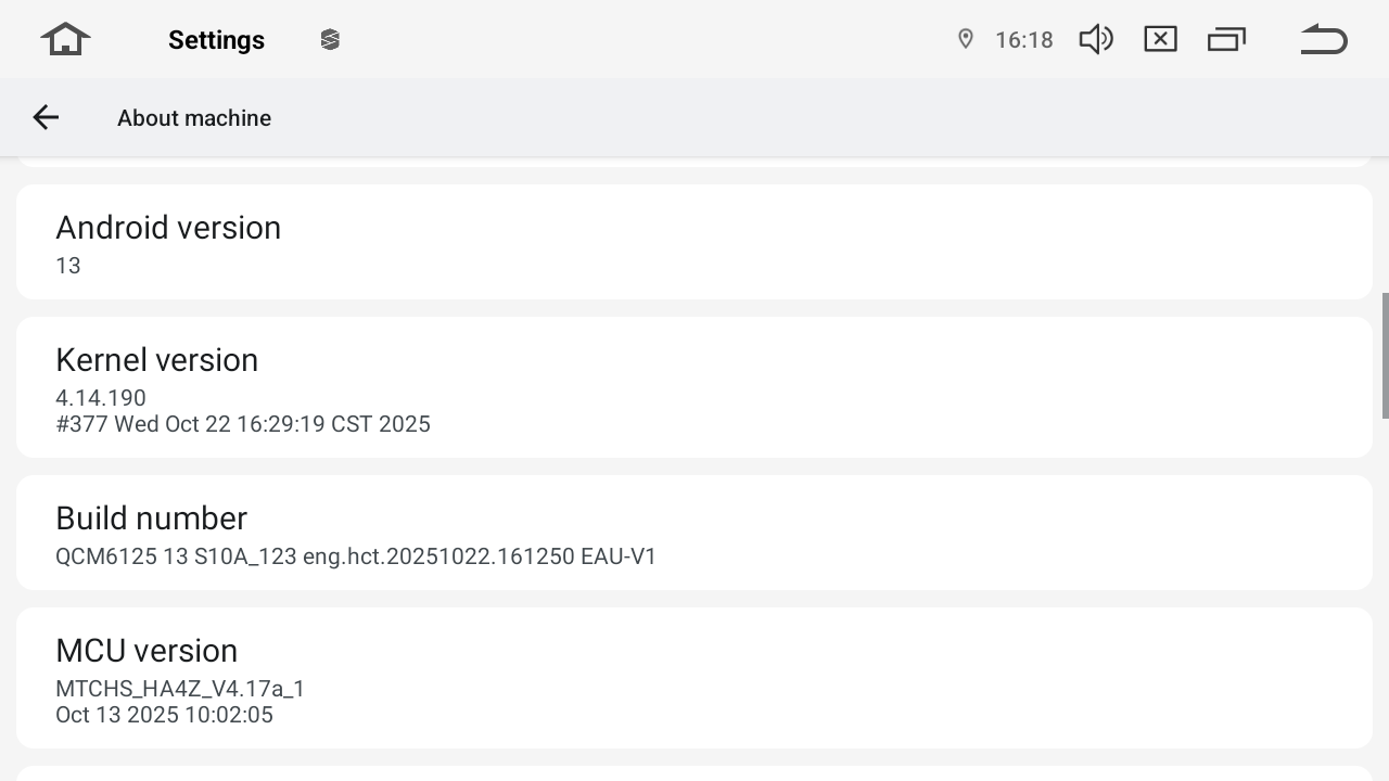

@Dale ScottPlease go to Settings > About machine and send us a screenshot about the current Build Number and MCU version.
