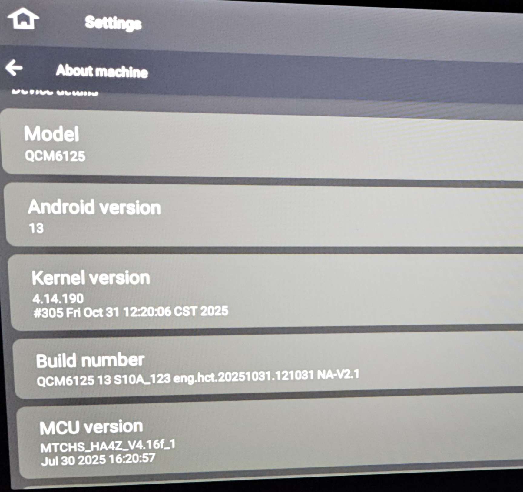

In order to help you better, please provide below Build Number&MCU version picture to our email address and indicate your Order ID# in email subject.
Email: support@dasaita.com
Go: Settings > About Machine > Build Number; MCU version
I have exactly the same issue with random reboots and a second restart seems to fix the android auto issue.. @dasaita please fix this :-)
- Android: 13
- SoC: Qualcomm QCM6125 (from the build number)
- Kernel: 4.14.190
- Build:
QCM6125 13 S10A_123 eng.hct.20240903.141210 EAU
- MCU:
MTCHS_HA4Z_V4.14_1
- MCU build date: July 23, 2024, 09:48:27
Thanks

@Support Dasaita Can I try this too? Dont know if mine is V1 or V2 etc ... Thanks
- Android: 13
- Kernel: 4.14.190
- Build:
- MCU:
MTCHS_HA4Z_V4.14_1

Bump @Support Dasaita Is it safe to try this on my own unit too? Thanks :-)
@Stephen Maher
If you unit can work well, we recommend keeping the current version to use, it doesn't need to update.
