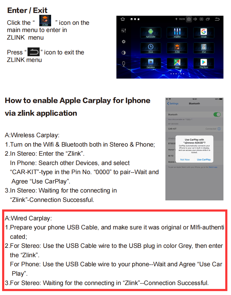

  • How can I use Apple car play using the USB wire? I have a PX6 Andriod 10.
  • @Aramis Gonzalez
    Please refet to attached picture.
  • How can I use Apple car play using the USB wire? I have a PX6 Andriod 10, but the OS i have is vivid 10.
  • @Aramis Gonzalez
    Please try to do as follows:
    Prepare your phone USB Cable, and make sure it was original or MIfi-authenticated;
    For Stereo: Use the USB Cable wire to the USB plug in color Grey, then enter the “Zlink”.
    For Phone: Use the USB Cable wire to your phone--Wait and Agree “Use Car Play”.
    For Stereo: Waiting for the connecting in “Zlink”--Connection Successful.
