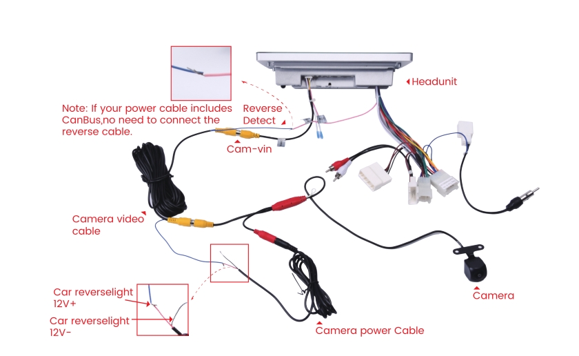

    1. Make sure the RCA video cable has been connected to interface 11 correctly.
    2. Connect the rear camera connector with the yellow plug labeled "CAM VIN".
      Note: If the screen displays a yellow exclamation mark when you're reversing the car, there must be a wrong wiring issue. You should refer the above wiring tips to check or you can check the wiring tips on our listing description.
      Here is wiring instruction of the after-market camera.
      Note: If the head unit’s without a CANBUS, it should have to connect the reverse cable as you shown on the picture below.
