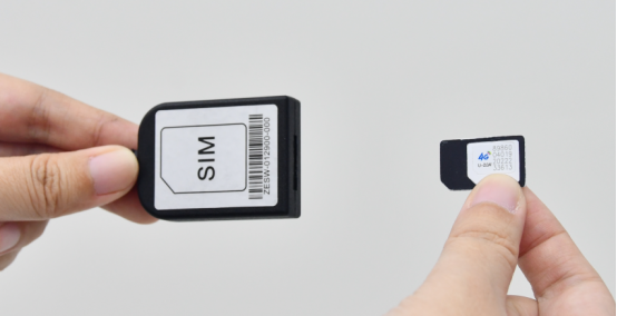

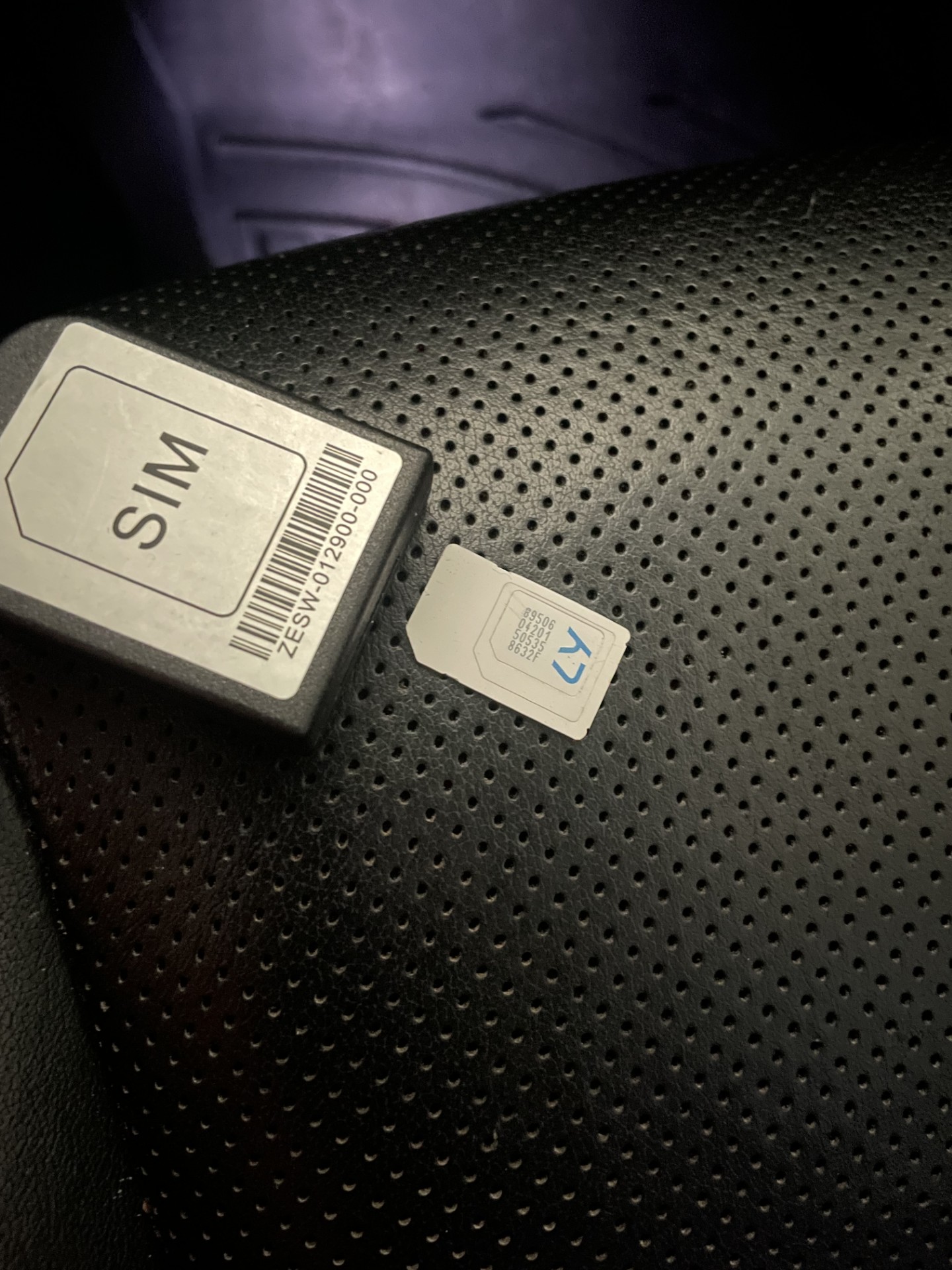

hi @Support Dasaita It's working now thanks. On the other hand, I'm having a problem with the SIM cable; it doesn't seem to be working properly. It's like it can't find the SIM card. Is there any way to buy one?
@Harry Rojas Sanchez Please let us know if you mean that when inserted the SIM card, it could neither access Internet nor initiate a phone call.
@Support Dasaita
What I mean is that when I insert the SIM, the radio does not identify it, but when I move the cable in the sim part, inside it sounds like there is something broken!
@Harry Rojas Sanchez You could send us your address and telephone number to support@dasaita.com, so that they could send you a new cable. (Note to markdown the order number.)

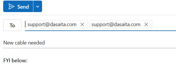

@Harry Rojas Sanchez We have not received your mail, could you please confirm if you have sent to support@dasaita.com?
Yes, take a look:
please search by subjet "New Cable Needed"
Thank you for your time and efforts in this matter.
It is a shame that we couldn't locate your email. Please confrim again.

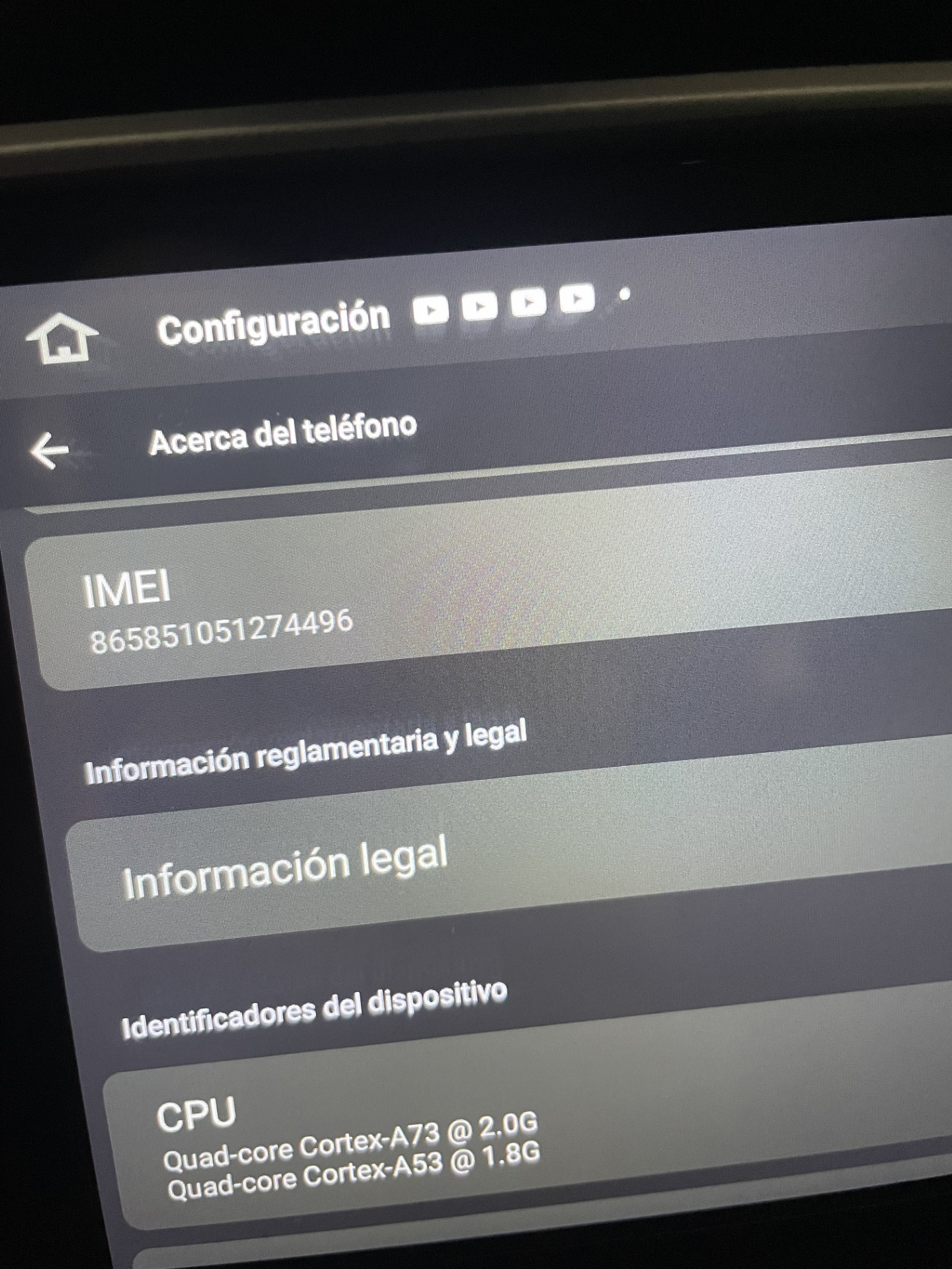

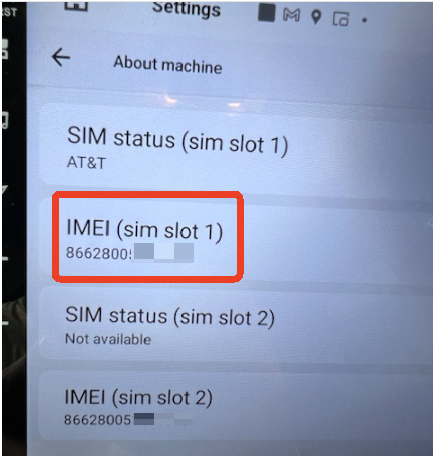

Please take a picture of showing the SIM Card Status on your head unit.
Here are the trouble shootings:
1.Please must power off the vehicle before inserting the SIM card .
2.Please make sure the IMEI of SIM card Setting is 15 series .Go Settings>About machine >IMEI .
