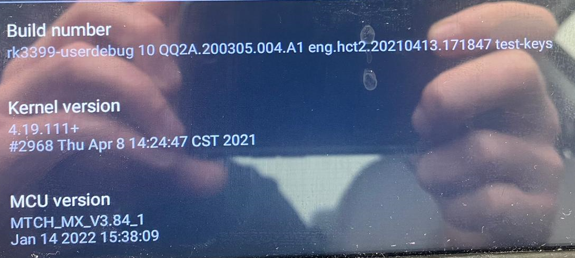

  • @Nicolas GAUTIER
    For your information, it doesn't support to upgrade the later system Android13 from Android10.
    In order to help you better, please go Settings > About Machine,
    then provide the following clear photo: Build Number.
    Thks for your reply, you can find after the photo of the build number, to send me the latest version to update my headunit, and send me the good zlink apk.
    Does this head unit support an update to Android 11 or 12. Is it really necessary to do this migration through a new version of android 11 or 12?

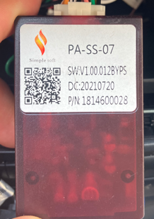

    for information, i have this canbus (cf image), but i don't find the good setting in the factory setting.
    Even if i reboot the headunit, the canbus still block on the 59PSAHiworld position which is the last canbus i test to back up my sensor parking (but with this one i lost the dual zone AC management). I tried the position 61 with the red canbus, and i find the good model, Peugeot 407 Coupé Sportpack 2006, but i lost again the sensor parking assistance. Could you please sent me the good reference of Canbus for this car withou lost any functions. It will very king of you.
    Thks.
    Nicolas.

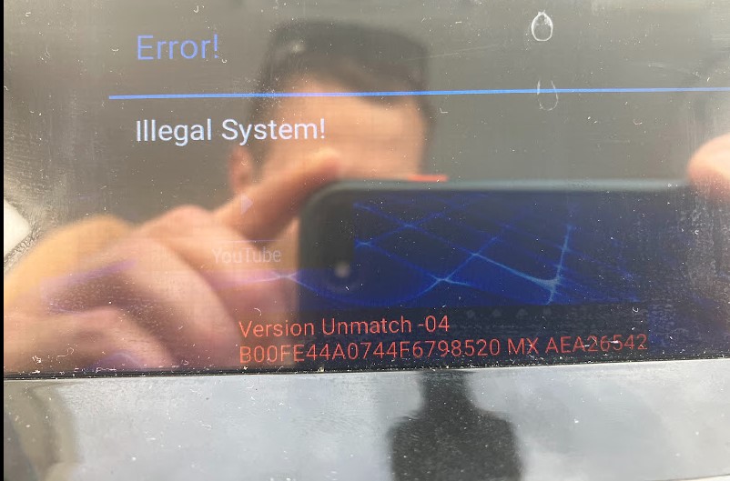

    Hello I'm furious, the file you gave me is corrupted. (see photo). Nothing works anymore, and I can't go back. Thank you for getting back to me very soon, to find a solution. Kind regards Nicholas.

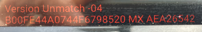

  • Hello
    The car radio is indeed a PX6
    I tried to download the transmitted file again, and tried the installation with several USB keys, but the problem remains the same, with the message "iIlegal system" I also tried to update the MCU to the following version: MTCH_MX_V4.09, but the problem remains the same.
    By going through the system update mx4_rk3399_10.0_ota(20220217), I no longer have the error message "illegal system", but the red message is still displayed and the car radio beeps every 3 seconds. (cf photo)
    I tried to reinstall the MCU MTCE_MX_V3.78, it seems to me that it is the one that was originally mounted (purchase of the car radio in November or December 2021), but when I go to MCU update the car radio does not find the file and I cannot open it from the storage space.
    Regarding the RST button to go into the recovery mode, I don't have one. I tried to long press the OFF button and then briefly press the ON button, but it doesn't work.
    Can you send me the latest updates for the MTCE_MX car stereos (MCU + system) and tell me how to enter the recovery mode, to force the car radio to boot on the right MCU. (see photo)
    Your mistake of advice was very detrimental to me since I find myself today because of you, with a car radio completely inoperative. I am therefore counting on your responsiveness and professionalism to treat my requests as a priority in order to repair the mistakes you have made me make.
    Thank you in advance for your answer as soon as possible.
    Nicholas.

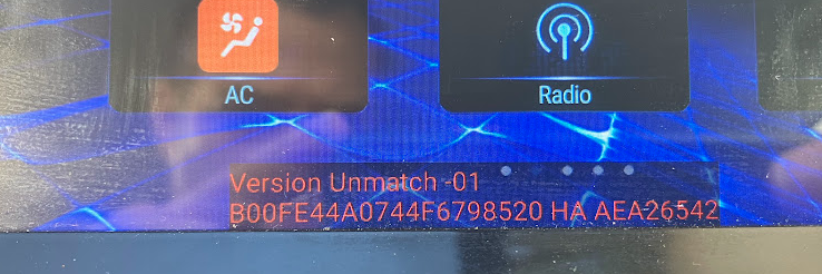

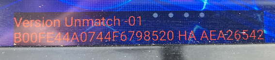

    Hello
    I put your recommendations in place by installing the MCU and system file. The red error message is different, but the problem remains the same. (cf photo) The car radio beeps every 5 seconds; The Bluetooth module is not working.
    Can you send me the correct files according to the error message shown in the photo.
    How can I connect to recovery mode. (c message above)
    What is the reference number of the bluetooth module on this model.
    Thank you in advance for your quick answer.
    Kind regards
    Nicholas.
  • @Nicolas G
    1、
    Please try to update MTCH 3.8:
    https://www.dropbox.com/s/4kl7j2gsgdjt527/MTCH_HA_V3.80.rar?dl=0
    2、
    Bluetooth option:
    Settings > Car > Factory settings (password: 126) > App > BT >
    "FSC-BW124" / "WQ RF210" / "WQ-BC6" / "SDIO-AUTO".
    I'm surprised you're making me download a MTCE_HA version, since it looks like my MCU is an MX version. Despite everything, I followed your recommendations once again, and the red error message is still present (see photo taken today), and the car radio still beeps every 5 to 10 seconds.
    What do I need to do to find a functional car radio? It's been 11 days since you made me mishandle making the car radio inoperable, and since then I have been confronted with your inability to solve your error. Please put your best technician, to solve this problem, ASAP!

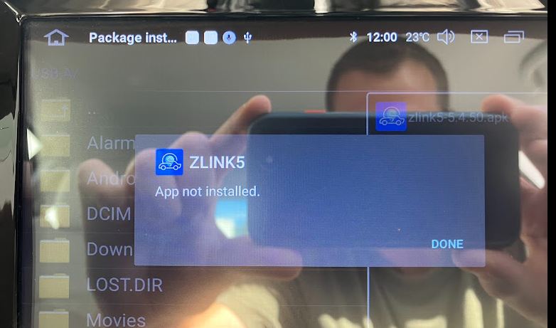

    I put an MTCE_MX V3.78 MCU and an MX ROM system, mx4_rk3399_10.0_ota(20210413), but i can't update zlink (cf photo below) on the apk installer. Could you send me the good apk for Android10

  • @Nicolas G
    We'd like to remind the version that you purchased already has stopped production, we no longer maintain this item.
    For this reason, it won't release any new update file anymore.
    We notice your current System&MTCE are the old version, thus it possibly cannot compatible with Zlink.
    Besides, it also mostly likely cannot compatible with new version Zlink.
    At present, we only have the new version Zlink apk for Android12 OS, however, we cannot ensure the suitability for your unit.
    If needed, please check it below then give it a shot.
    https://www.dropbox.com/scl/fi/jrya42umgerwzjo8atxtx/zlink5-hengchangtong-release-v5.4.40-34f63965f_jg.apk?rlkey=20lv6wzz6ci0qgchc7fvb7pb2&dl=0
