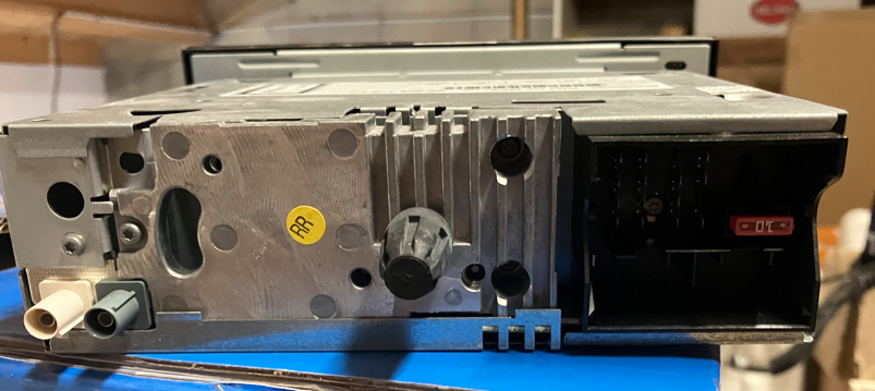

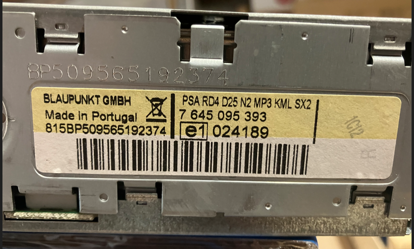

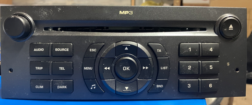

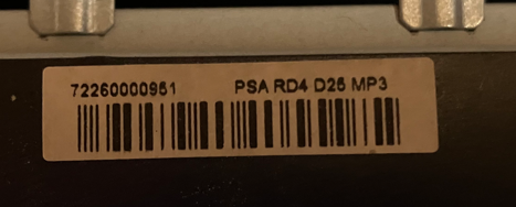

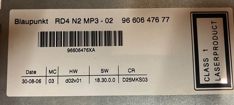

    Besides, please send the front&back side clear photo of your original radio to us.
    Thanks for helping me, i appreciate.
    Like you would, i send you the picture of the original radio, to have the right canbus reference.

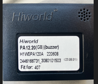

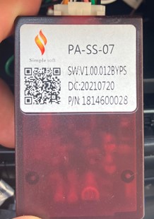

    I send you the both canbus which doesn't work:
    -the red one (a simple soft) = i don't have the sensor parking assistance front and back (parking radar)
    -the black one (a hiworld) = i lose the management of the dual zone AC, and it seem not fit for 407 according to the hiworld after sales service, but the parking radar work correctly.

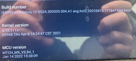

    -and the build numbers of the headunit PX6, to have the right upload and update, of Zlink, and the good MTCH files.

  • @Nicolas G I read on a forum that if you set the HiWorld PA12.20 as "Peugeot 308" both Parking sensor sounds and Climate Control Works as expected. Could you try it?

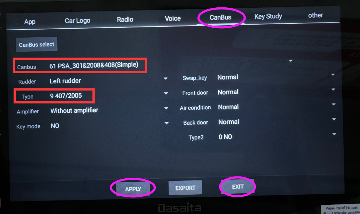

    Please confirm the CanBus Option&Type:
    Settings > Car > Factory settings(password :126) > CanBus > Canbus > NO.61;
    Type > "9 407/2005" > Apply > Exit > Reboot.

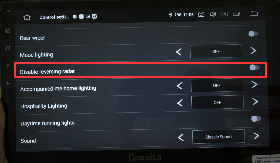

    Please go App “Control settings” > control settings > Disable reversing radar,
    then test which one can work if you enable/disable it.

    I success to delete them and go to the recovery mode to set up the original version of the MTCE_MX with an mx4_rk3399_10.0_ota(20210413) system.

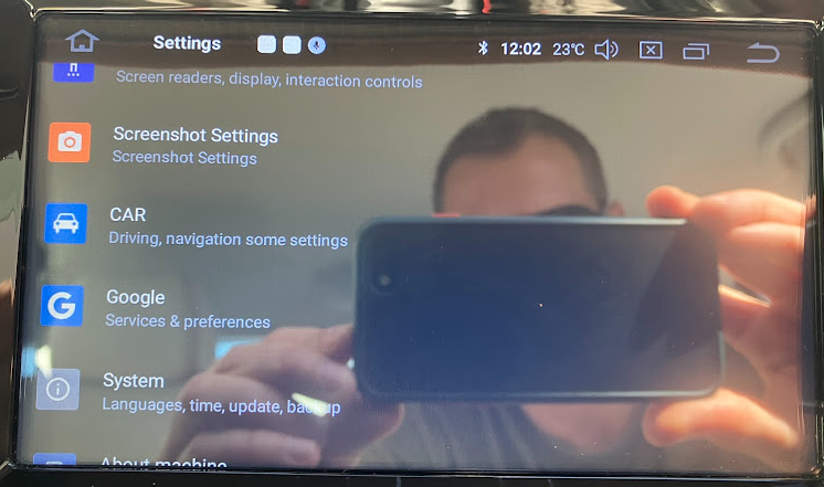

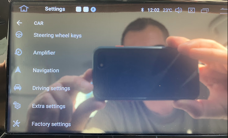

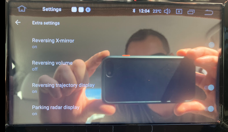

    With the simple soft my screen is a little bit differente
    cf photos below
    I tried the parking display on and off but nothing happens

    Please firstly confirm the CanBus Option&Type:
    About more details of CanBus, we suggest that you can contact the store customer service where you purchased the item.
    I confirm that the simple soft (the red one) canbus is in the right position:
    CanBus > Canbus > NO.61; Type > "9 407/2005" > Apply > Exit > Reboot.
