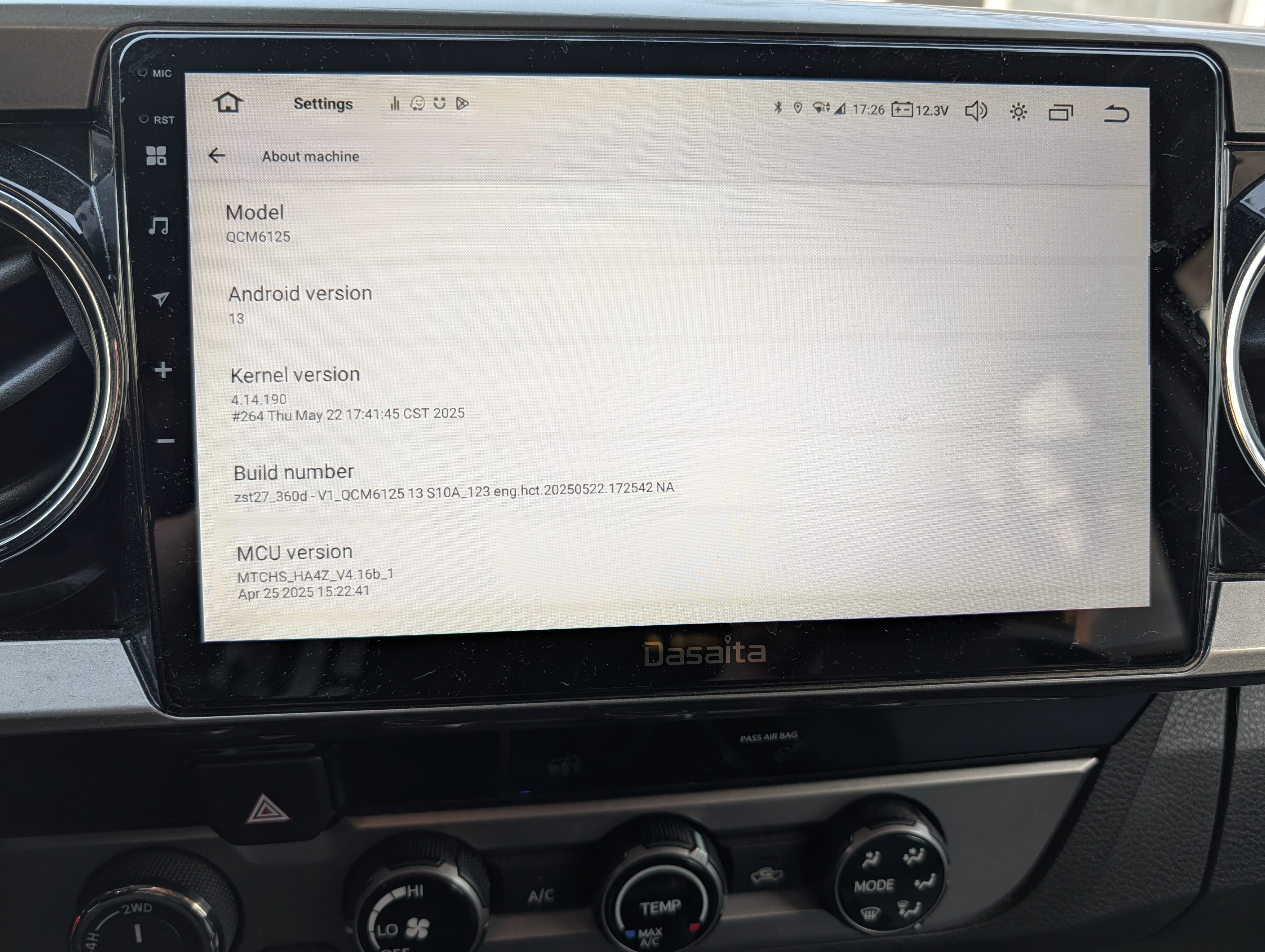

Do you mean that the G12 random reboots when you use the SIM Card?
Please also go to Settings > About machine and send us a screenshot about the current Build Number and MCU version.
Thank you for your time and cooperation.
@Support Dasaita
I don't know if it's only when the SIM card is inserted. I have had it in the whole time, but it does reboot a lot, once a day or more.
@Genghis Quan I can only tell you that since I removed the SIM card reader, I have not had the annoying reboots of the device even though it has already been almost 12 months. I hope the DASAITA team solves this annoying problem🙂
@Antonio Catalano
Thanks for your details.
Based on the firmware you provided ,it is the andriod 13 unit.
May we have your order ID ? Our techincal team sent us a firmware to resolve the issue for random reboot when you insert the SIM Card.
