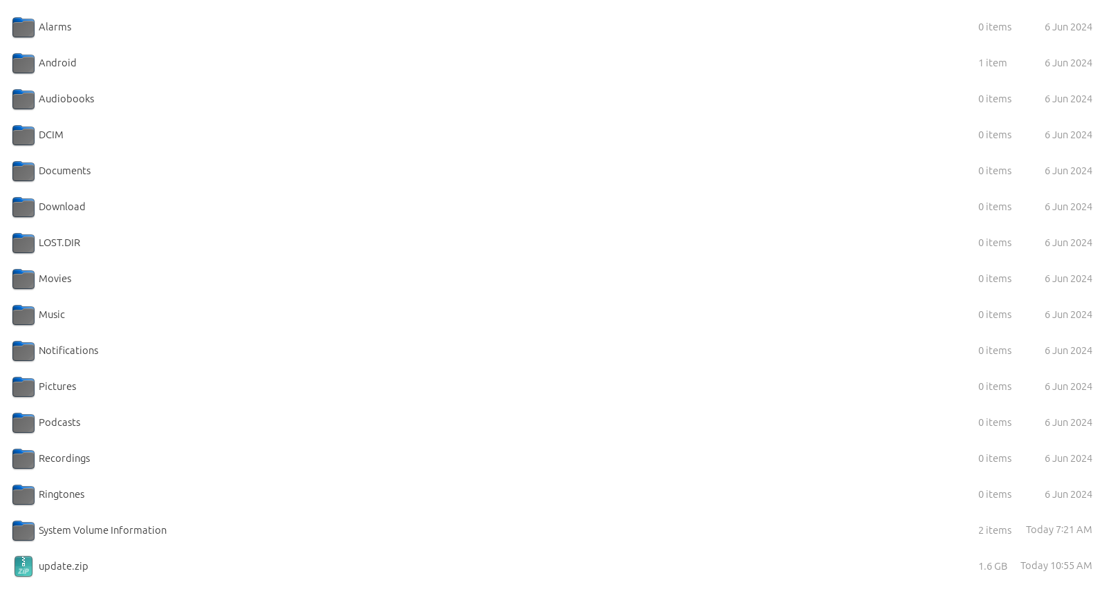

Tips: 1. Download above update file via your computer/laptop. 2. Format USB drive to FAT32 Format. 3. Copy the file “update.zip” to the root directory of USB drive. 4. Insert USB drive into the unit via USB cable; then it will pop up automatically a window of update. Alternatively, please manually go "Settings > System > System updates" to start the update. ***NOTE: Please make sure that you have ticked option "Wipe data and format flash!".

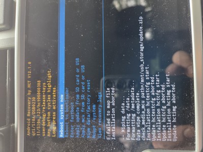

The update fails for me. I have tried several USB and re-downloading the update.zip file. It recognizes the file on the USB but fails after rebooting. Here is what it says:
Here enclosed another link, please try to download it then unzip the folder, and only copy this file “update.zip” to the root directory of USB drive, continue the update operation that we sent you to see how it goes.
Reminder: Please remember to firstly delete the previous update files in your USB drive before copying the new file.
Could you please try to use other USB drives to test how it goes?
If no luck, please record a video about your update operation process then send it to our mail and indicate your order number. So that we can forward it to our technician for further advice. Thanks in advance.
