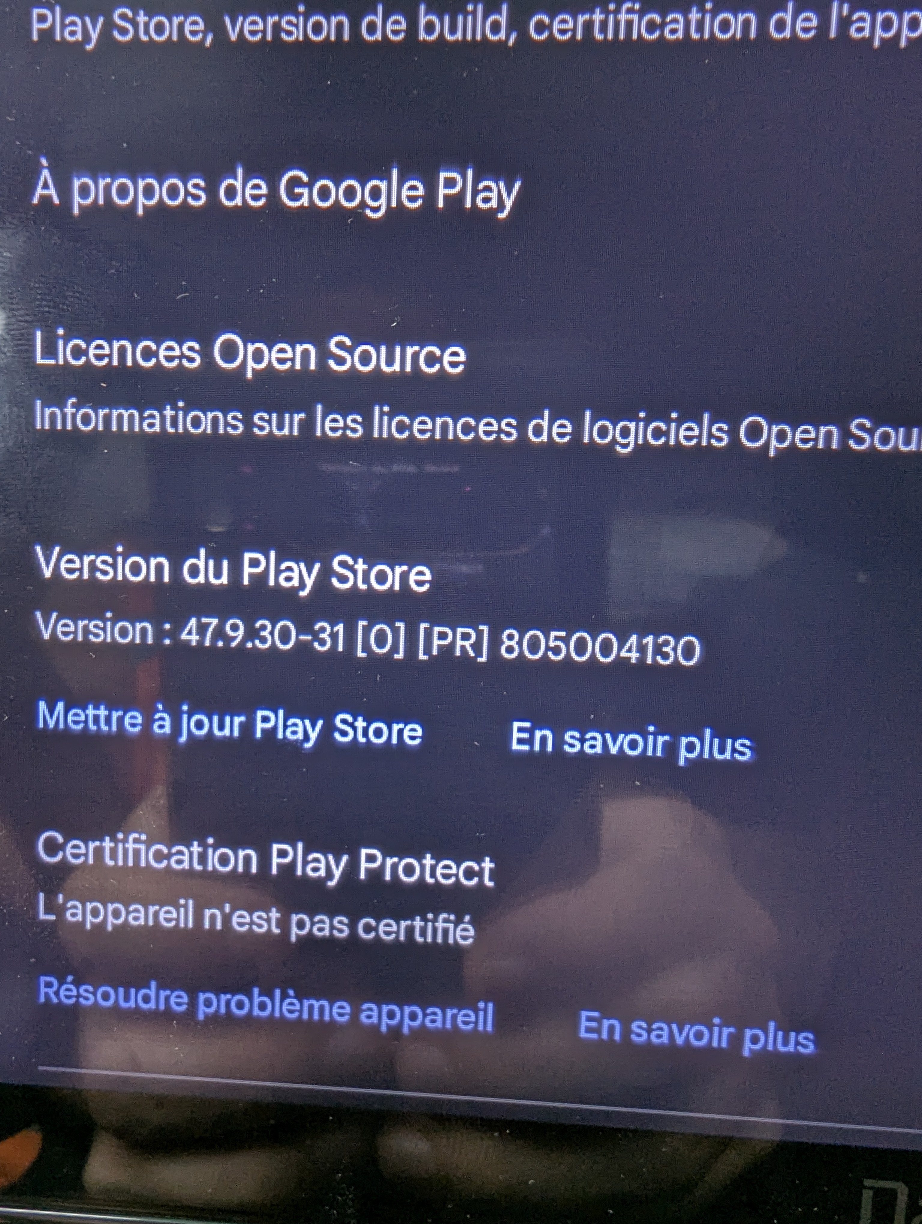

    But now, last problem, i have problem with certification play protect, it's not certified. So now i have problem with some Google apps.
    What i need to do to get this certification ?
    M'y google play store is updated.
    Thanks
