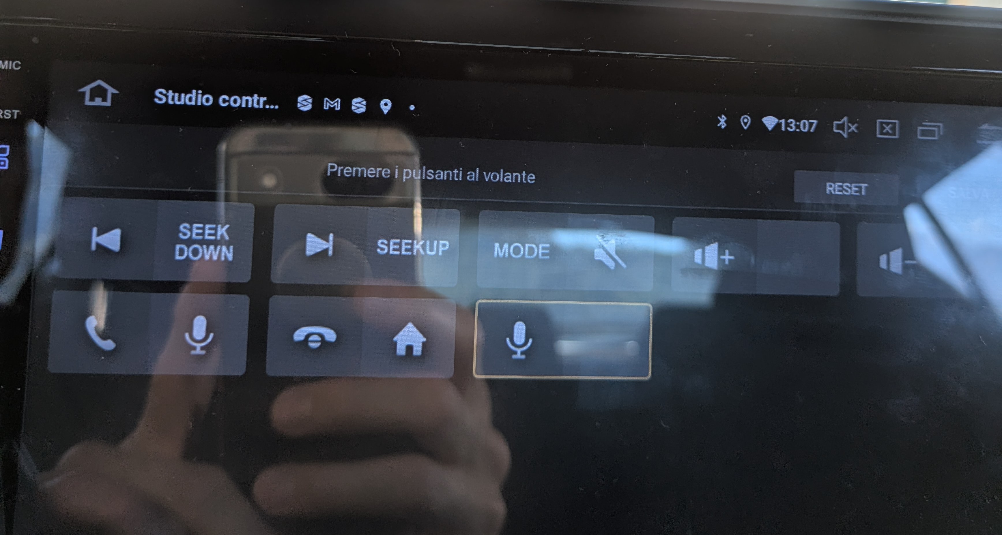

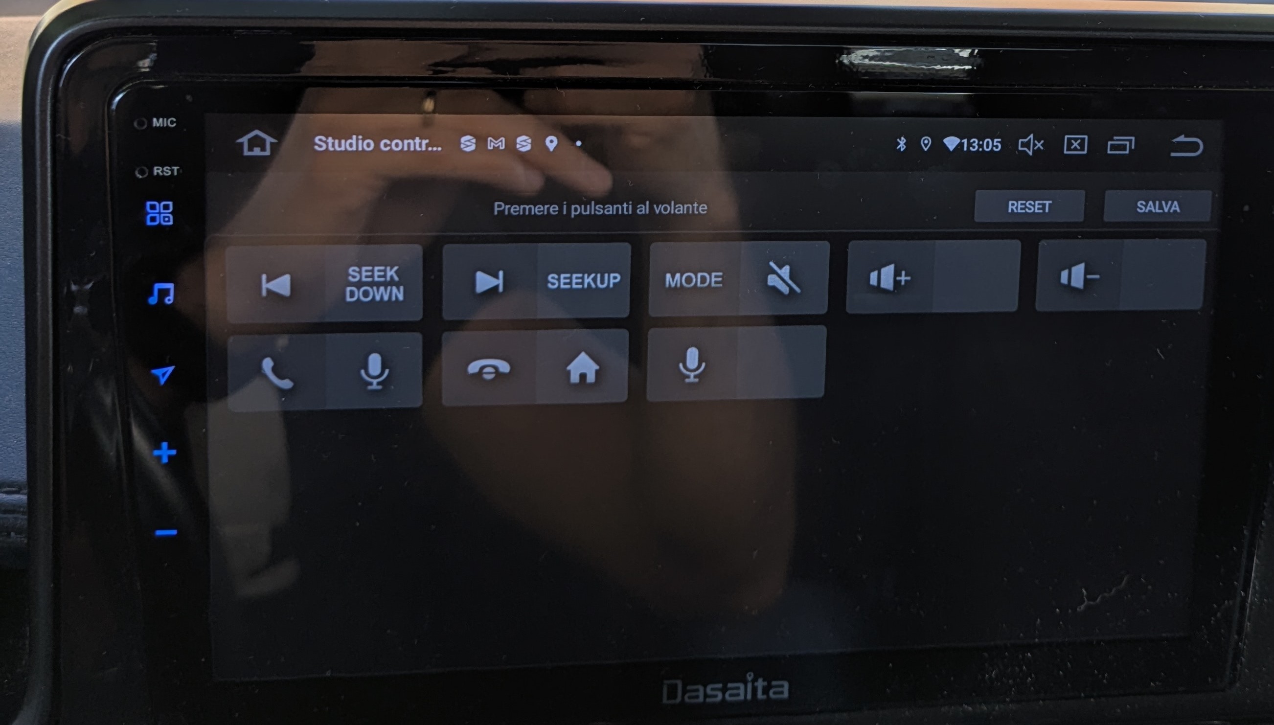

    If I use SWK setup page, when I press phone up/down, microphone or mode I see on the screen that the related command be one highlighted and I can change it.
    When I press volume or next/prev nothing happens, nothing get highlighted on the screen.
    If I press reset all commands on the screen get deleted but again , pressing volume SWK doesn't show up anything on the screen. I will attach pictures below.

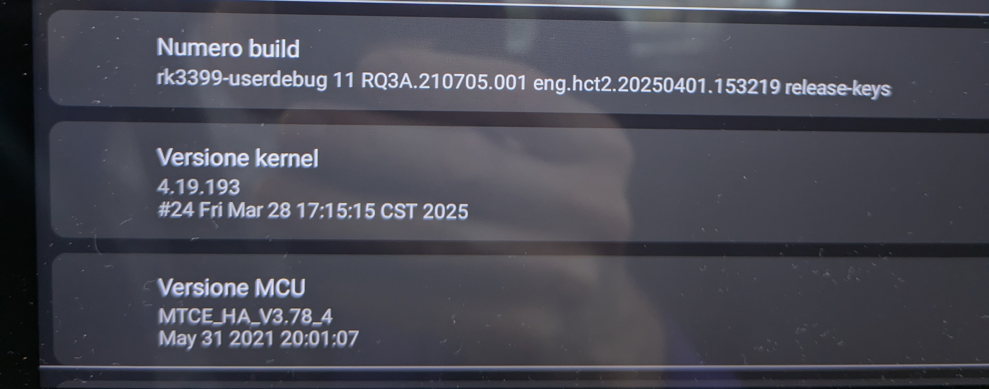

    And please go to Settings>About machine and provide the following version information:
  • CanBus was 8, set to NO, apply, reboot, set back to 08, apply, reboot and it doesn't work.

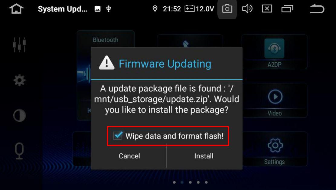

    https://www.dropbox.com/scl/fi/9fkhng2srynadlzvohbc6/update.zip?rlkey=jqnm8ksr6althxiq45w7a35ld&dl=0
    1.Please download the file though the link via your computer/laptop.
    2.Format the USB drive before copying the Update.zip  file to it, then insert it to the USB cable,and it will pop out the firmware updating tips on the screen.

    In the dedicate setting page, if I press "Mode", phone up, phone down, mic I see the highlighted command on the screen but nothing happens when pressin vol +/- or seek next / prev.

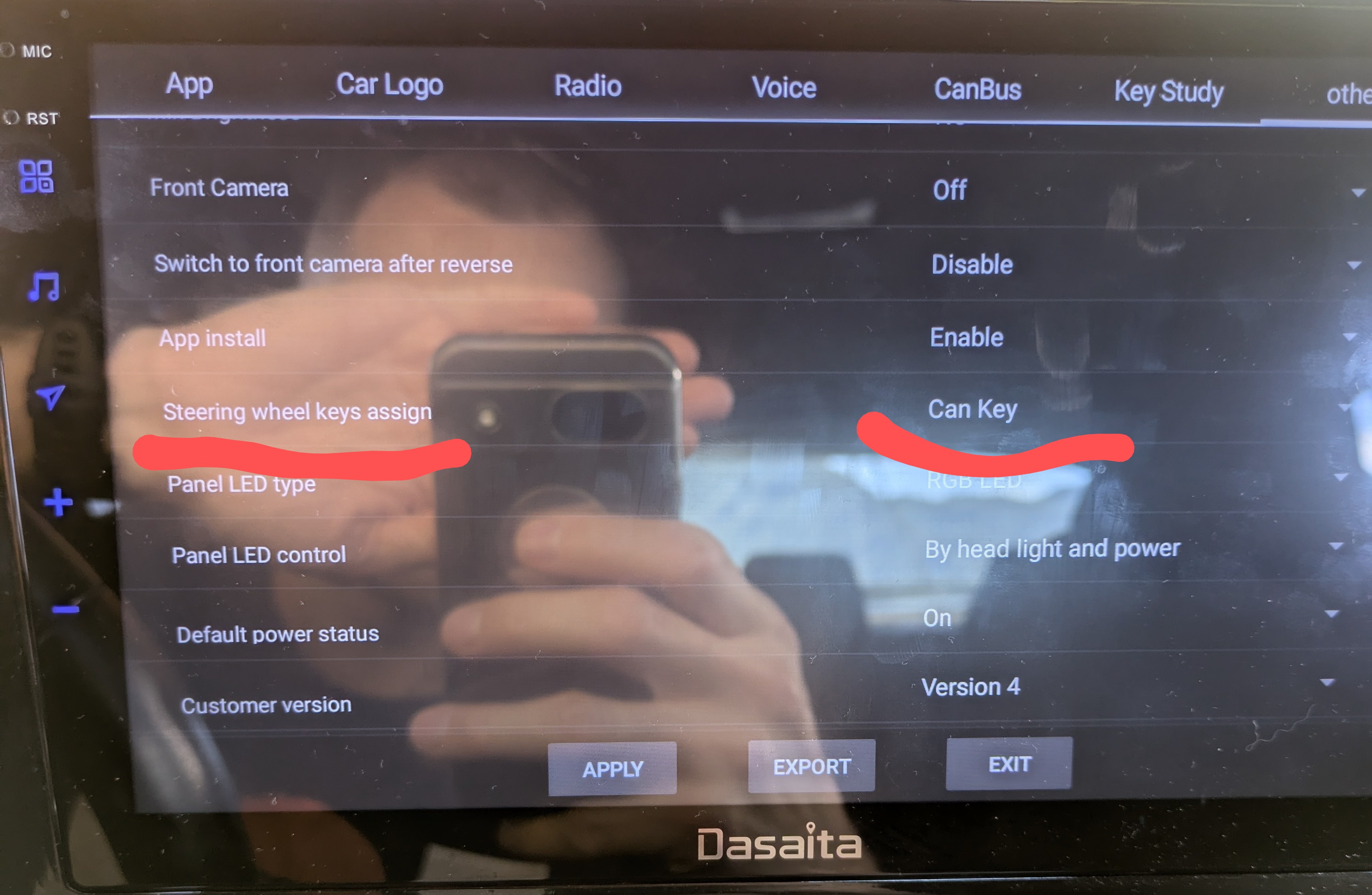

    Step 1. Please go Settings > Car > Factory settings (password:126) > Others > Steering wheel keys assign > Can Key > Apply > Exit (Restart).
    Step 2. Please go Settings > Car > Steering Wheel Keys > start to program OR just open the App "Wheelkey Study" to program. We also attached a video showing how to reprogram the SWC keys for your reference, please check it out.

    When I'm in the SWC study nothing happens when I press vol +/- or seek next / prev.
    Instead pressing mic, phone up, phone down  makes highlighted (yellow square) the related icon on the screen.

    Dear Mcgyver83,i mean did you switch to Can Key?Not SWC.
  • @Support Dasaita yes, if you check pictures above, there is a screenshot where I show "CAN key" as selected value.
    Despite this, swc up/down/left/right buttons from left wheel rudder don't work.
    Mode, phone up/down and mic yes.

  • @Support Dasaita  my setting is "CAN key" but when I enter the app to configure SWC, if I press volume +/- and prev/next nothing is highlighted on the screen. If I press mode,mic,phone up/down I see yellow square on the screen.
    This behavior is shown in pictures in 2nd post of this thread.

    Please try to find a pin, press and hold the RST button for 15 seconds to see if you can enter the factory setup page, if you can, select factory reset and reboot the unit;
    NOTE: Make sure you press the RST button vertically and firmly, you should feel a slight press, or even hear a faint click.
  • @Support Dasaita done selecting "Wipe data/factory reset".
    Then I selected "Reboot system now".
