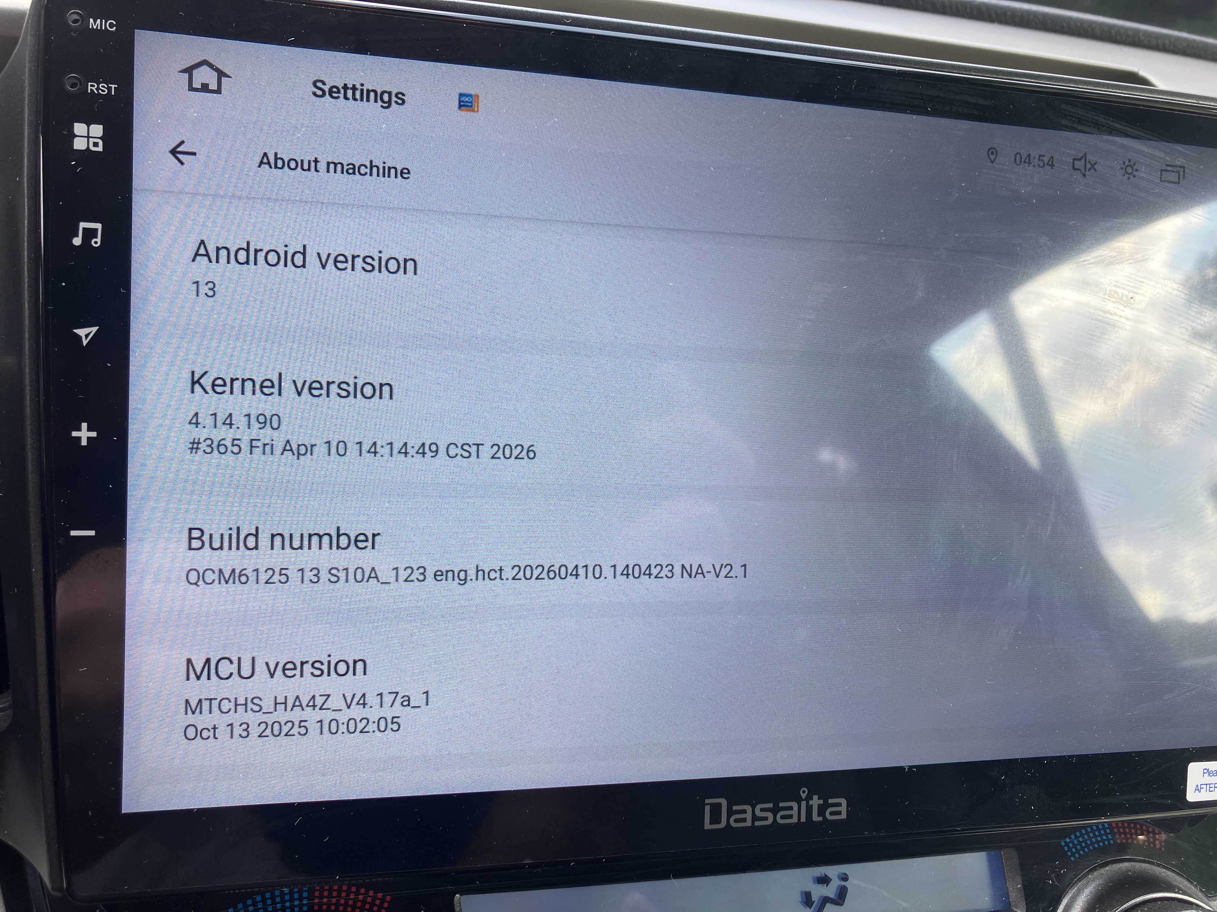

    If no luck, please provide the following information:
    Picture: Settings > About Machine > Build Number.

    hello, it seems like several peole have the same issue.  I am having the same reception issues as well with Not recieving any radio stations.  I have the 13 as well, and have attempted to turn on and off the RDS and tried both location settings, America 1 and 2 with no luck.  I have also double checked the antena is connected and replaced the exterior antena as well still no luck.
    Are there any fixes for this?
    QCM6125
    version 13
    kernel 4.14.190
    MCU - MTCHS_HA4Z_V4.16f_1

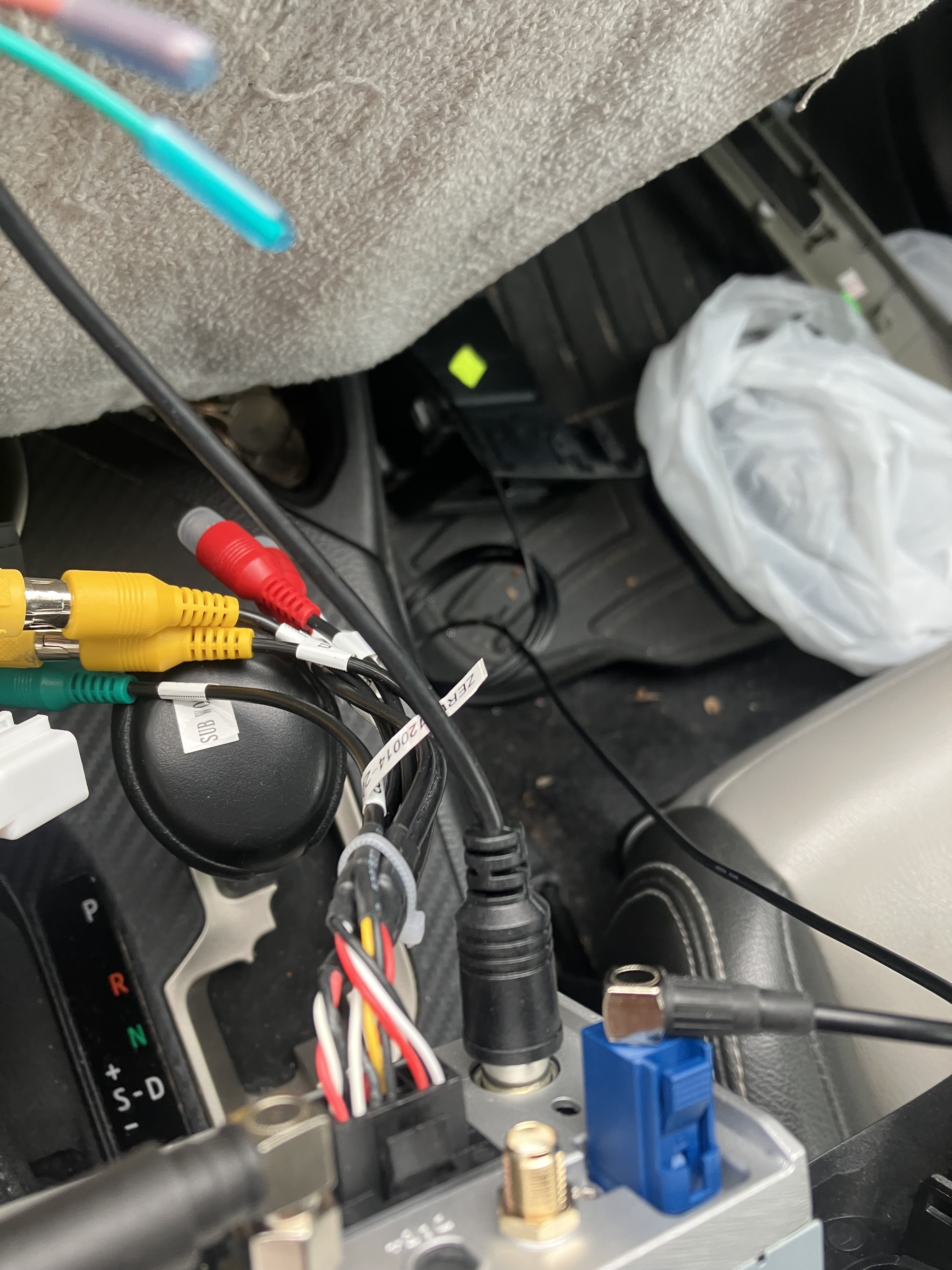

    Have you connected the radio antenna?
    yes the antenna is connected.
    The firmware has also been upgraded to the latest.
    antenna
    firmward
