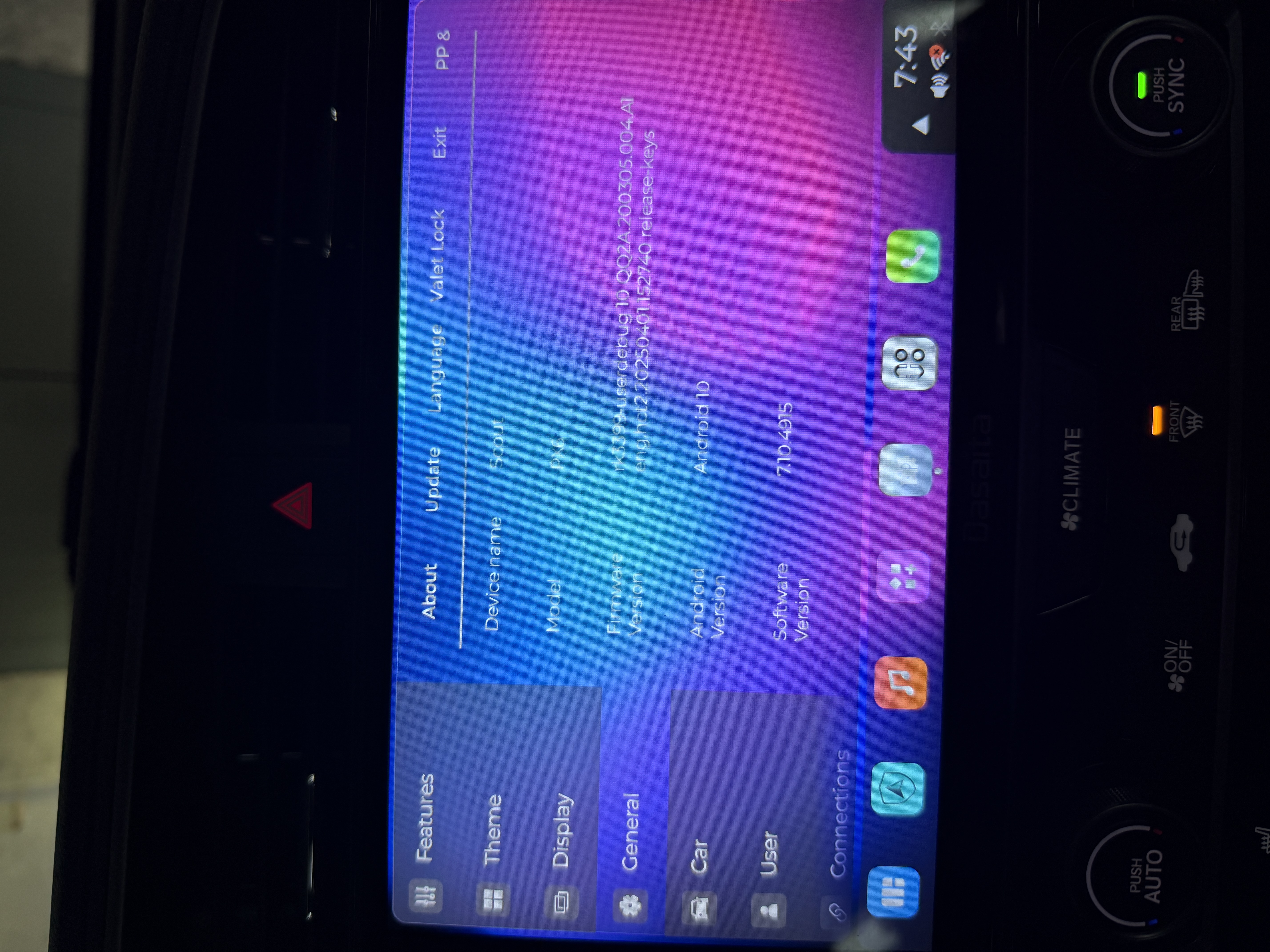

  • Successfully installed Vivid10 with scout. Again, zlink disengages Carplay connection similar to the Max10 firmware.😞
  • This is after installation of the Vivid10. The ZLink connection is unstable again with frequent disconnections. The head unit is now rendered useless as I am so dependent on carplay.
