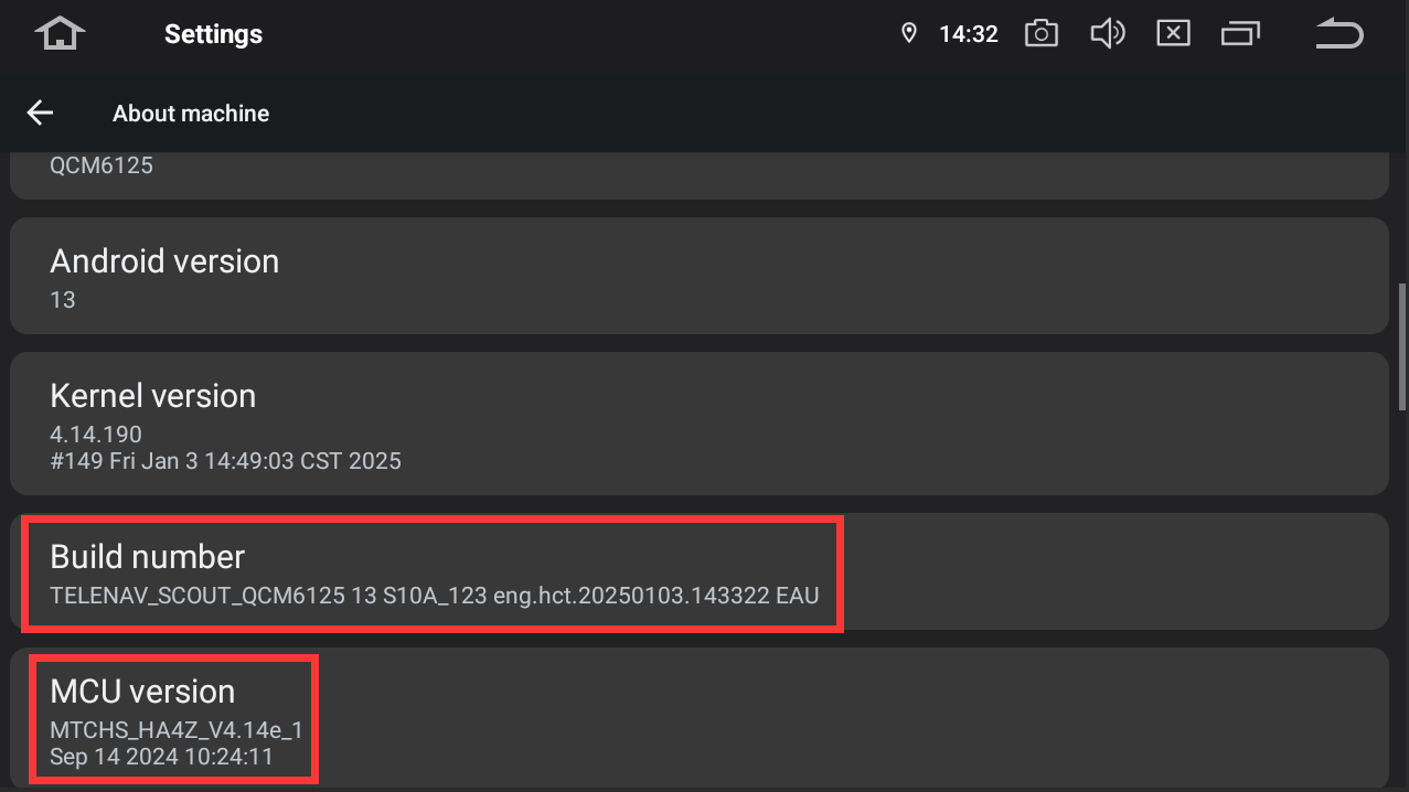

    In order to help you better, please go Settings > About Machine,
