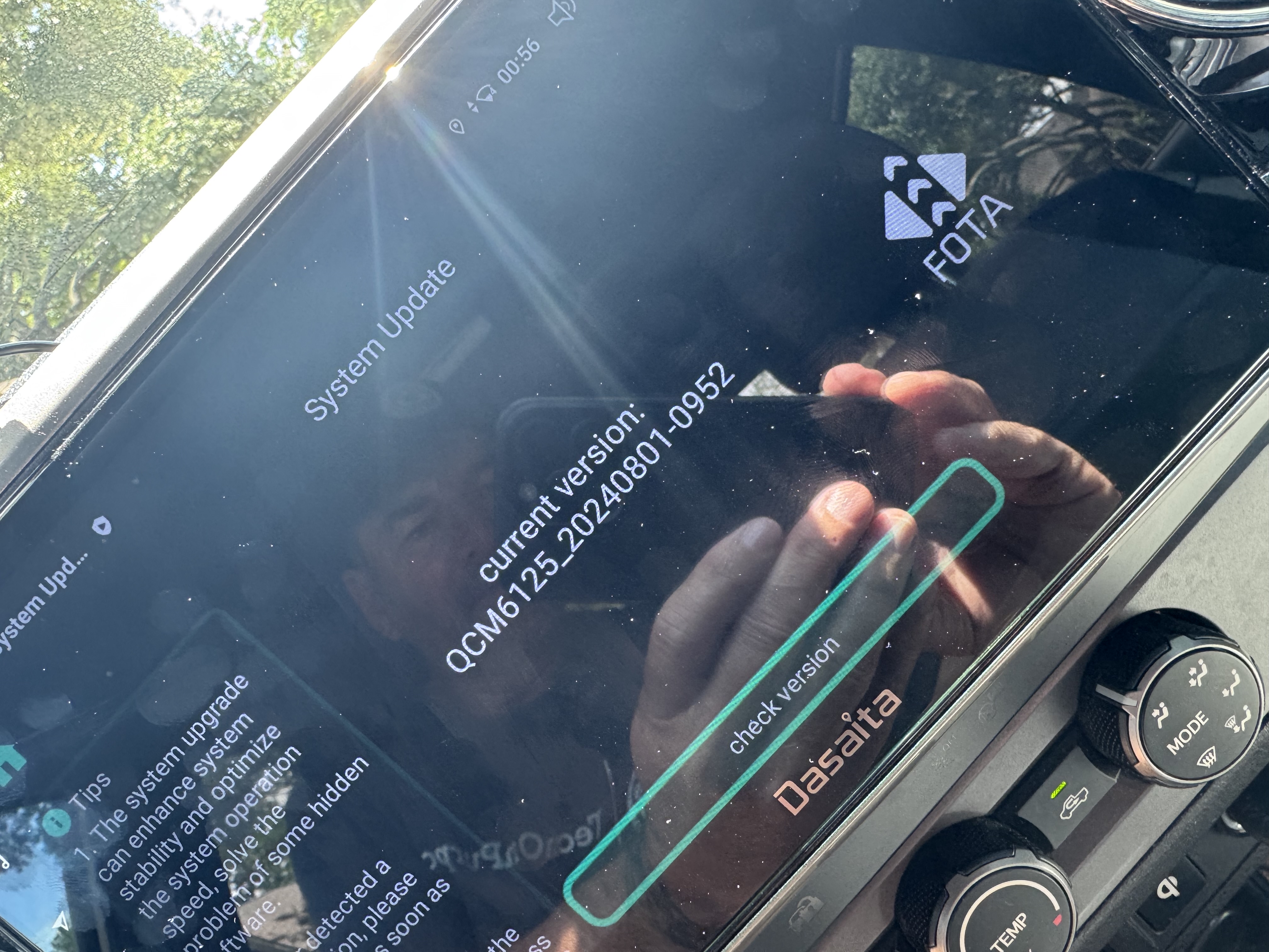

I have the following version currently installed.
Which version do I need to perform a system update?
Thanks in advance!!

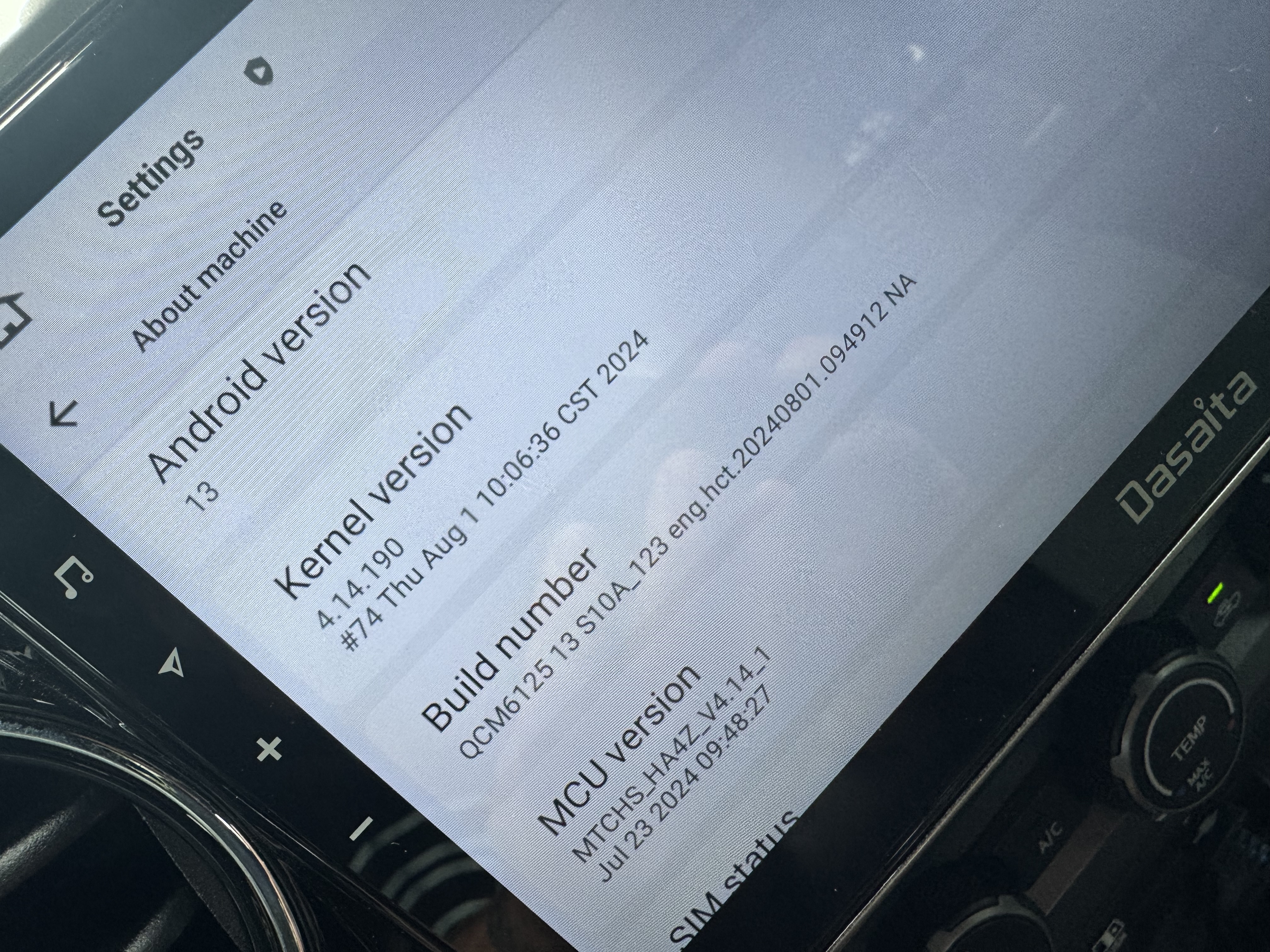

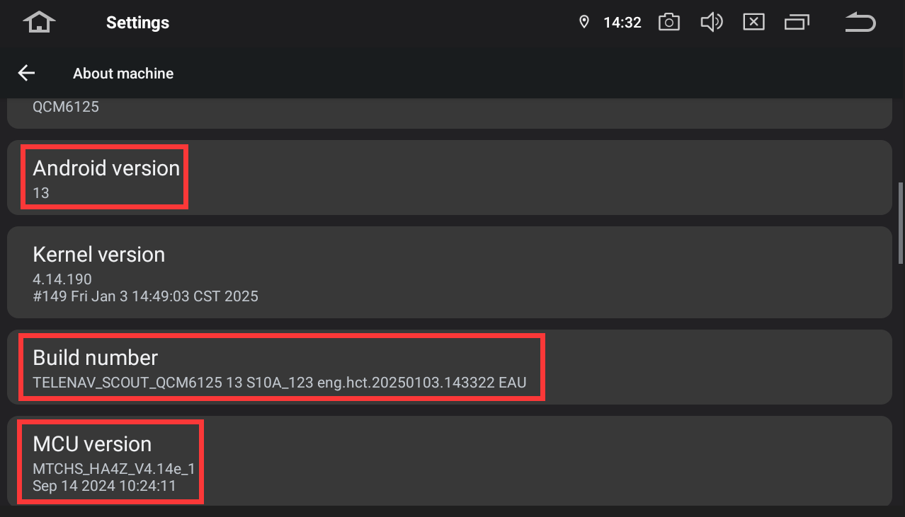

@Matt Tankersley
For further confirmation, please provide the following information:
Order Number & Purchase Date.
Picture: Settings > About Machine > Build Number; MCU version.

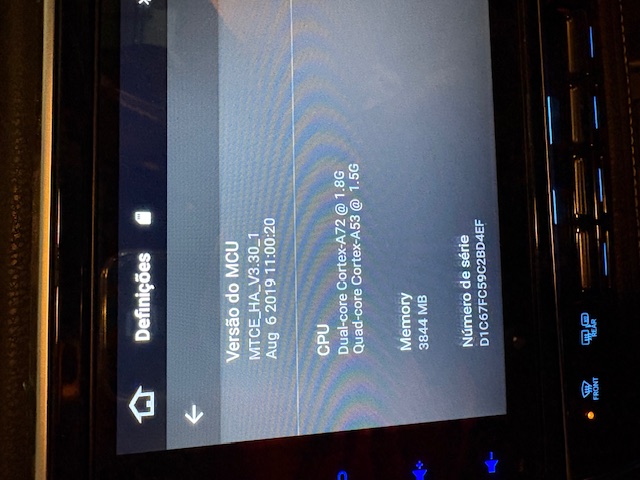

Good afternoon, I have a Daisata with Android 9.
I would like to know if there is an Android version update for this model that I have, it is for the Toyota Auris 2016 hybrid
Thank you
@Support Dasaita screenshot attached.
Purchased: 10/29/2024 (Amazon - Order # 111-9633500-2590665)

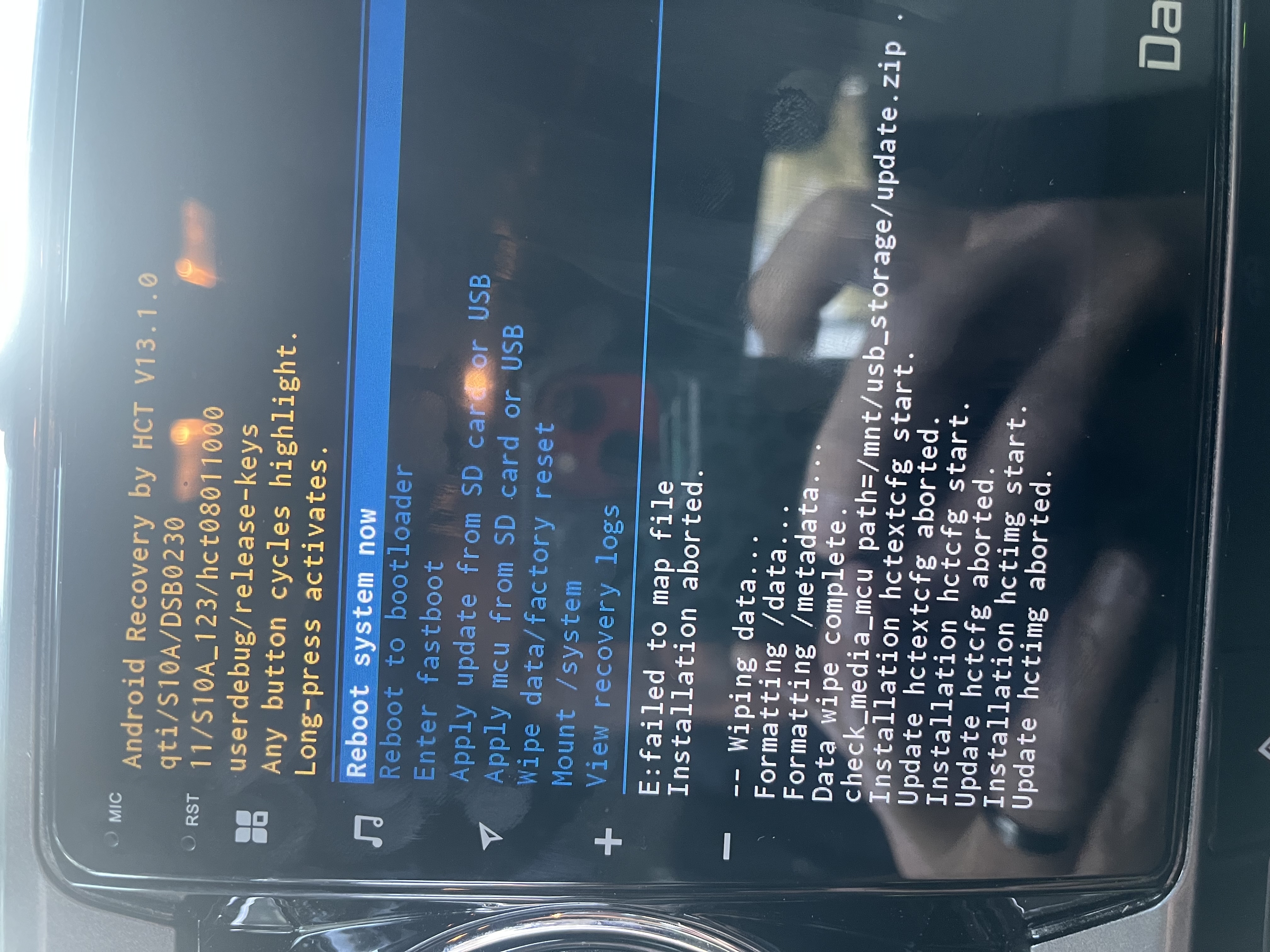

@Support Dasaita FAIL - see img - please advise.
@Matt Tankersley
Please try to re-download the file, and copy it to other USB drive to test how it goes.
Please make sure that the file is “update.zip”(it doesn't need to unzip or rename),
and you have ticked option "Wipe data/factory reset" before update.

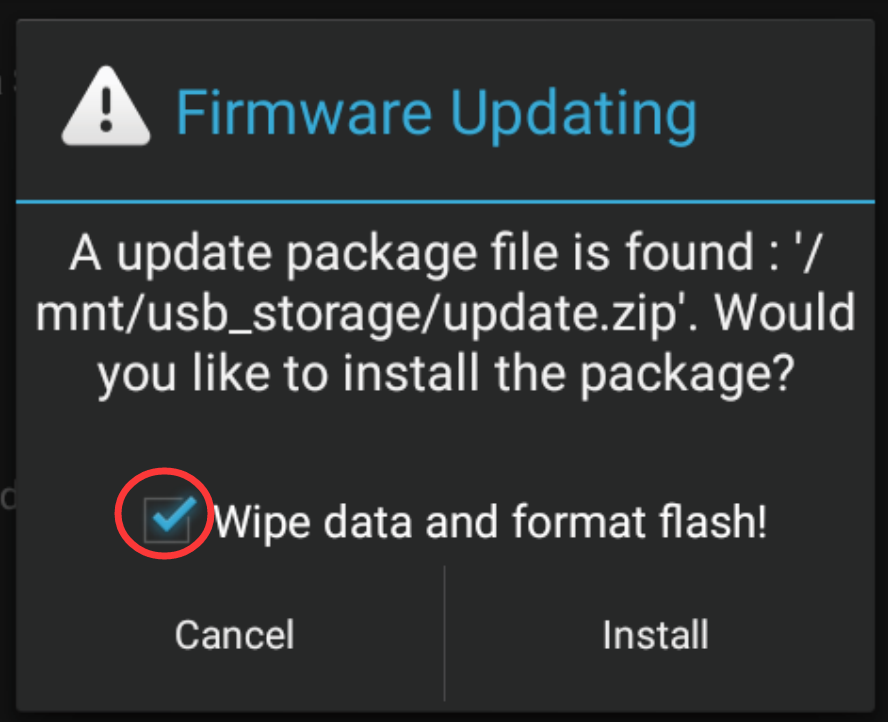

Please update the Firmware & MCU to the latest version via the link below,here are some tips to help you get it done:
①G13 Version:Make Sure your unit is QCM6125 Andorid 13
zst27_sc138_13_(20250311)
https://www.dropbox.com/scl/fi/70whgvgq7f6fkkd42ncie/update.zip?rlkey=a036rb694v0nehdqh11omokvw&dl=0
②4.15f:
https://www.dropbox.com/scl/fi/zjk57mppsli9nnmc9vubs/hmcu.img?rlkey=buxs8jrlxzn00j4488ze6sc0d&dl=0
1.Download the documents ①&② through the link on your computer/laptop.
(Do not rename and Unzip the file)
2.Format the USB drive(FAT32 Format)before copying the Update.zip & hmcu.img file to it, then insert it to the USB cable,and it will pop out the firmware updating tips on the screen.
(Tick the option"Wipe data and format flash")
3.MCU updated GO:Settings>System>MCU updates.
Thank you for your time and cooperation in advance.
