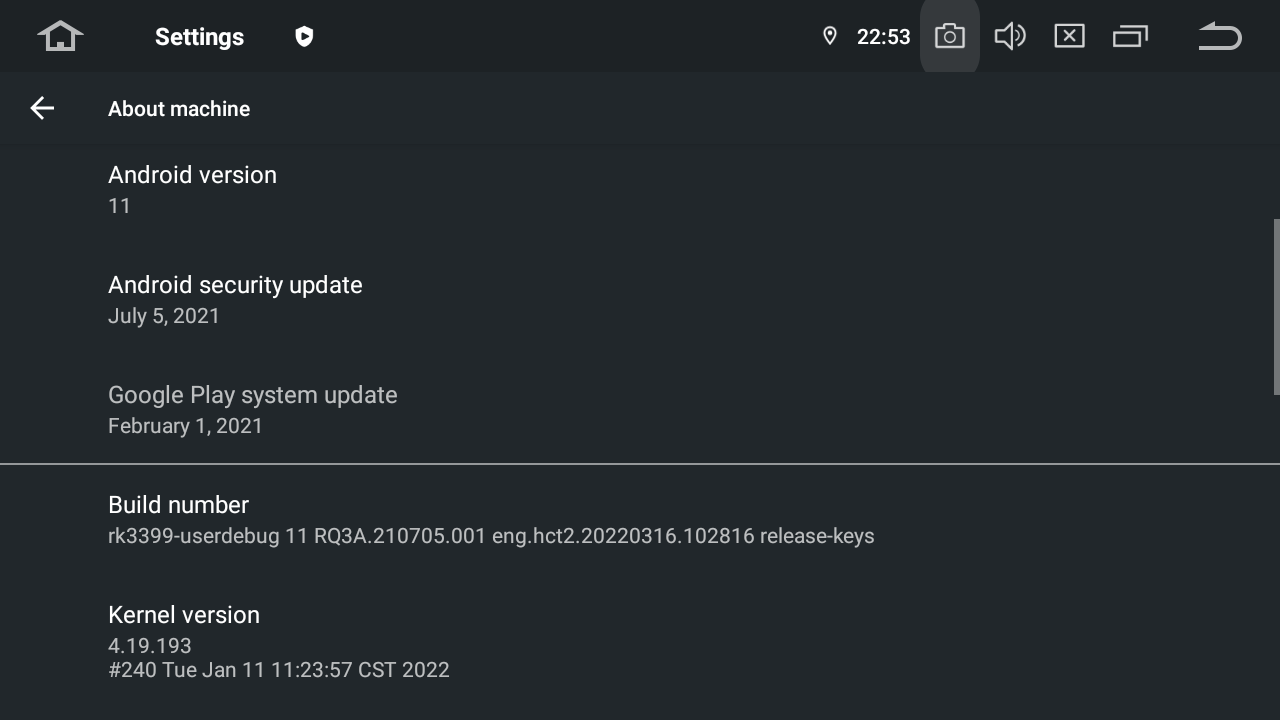

  • @Iker Gomez Is this only fore Max 10 units. Can you install this on vivid 10 unit?
  • @TK Zhang if your unit is an rk3399 (like from my previous screen), why not? Some time ago i switch my rk3399 from max 10 to Vivid(still 10) and comeback to max10, now to max11.
