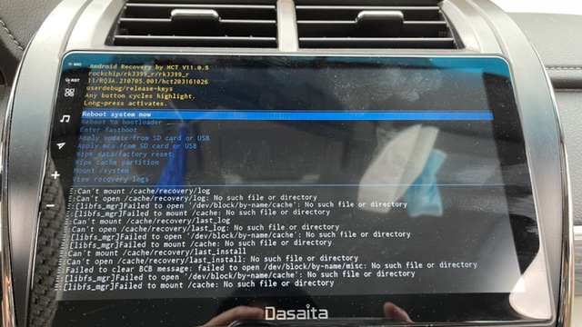

  • Any advise for a broken recovery?
    My MAX10 came with Android 11, I tried to install the Vivid ota and now I am stuck on the logo.
    Tried to boot to recovery, I see lights on the left flashing keep holding the clip but all is black.
    I would appreciate some help to restore to factory on vivid, thank you.

  • @Iker Gomez I tried to redo with the newest system image but got Erase IDB failed error. And it can't move forward no matter how reset it ( seems the ADB is not on) . Now the unit does not boot and I can't do update or factory rest in the recovery menu. Appreciate your advise how to fix it. Thanks.
  • @Quick Yuan Hi, Mr. Yuan, Appreciate if you can review my post and help on this. Now the unit is not working. Thanks.
  • Never mind. I got it fixed. Thanks.

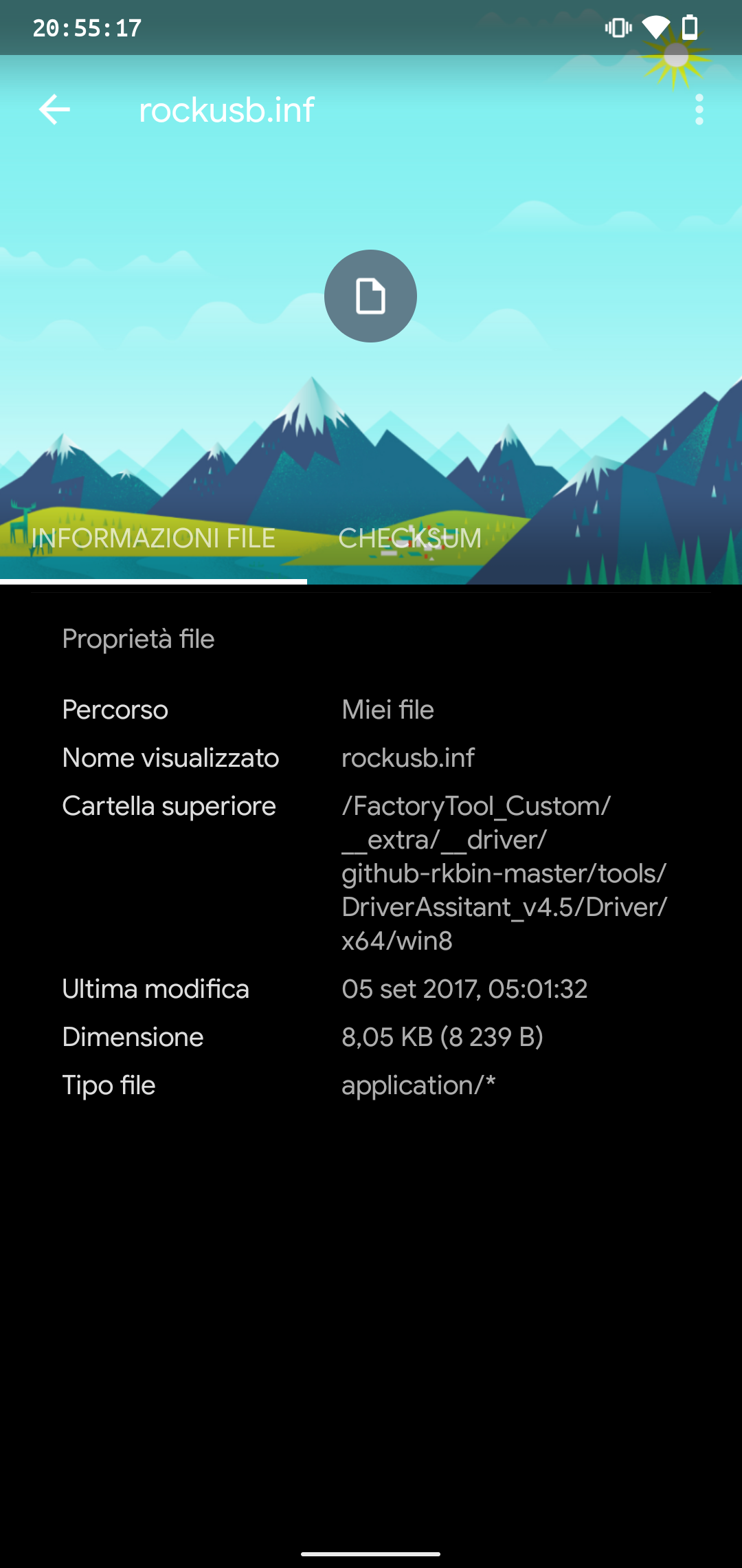

  • No matter what I try, I cannot get my Pc to recognize the hu after I initiate adb on. Any help is greatly appreciated.  I don't have an sd card but windows 11 just won't see it after I turn on adb. After searching, it seems we need a specific driver for the head unit. Is one available?
  • @Matthew Cover  Please see Salvatore Noschese and Iker Gomez's posts in this topic. You need
    RK Chip driver https://rootmydevice.com/download-rockchip-driver-assistant/
    ADB platform tool: https://dl.google.com/android/repository/platform-tools-latest-windows.zip
    Android USB Driver: https://dl.google.com/android/repository/usb_driver_r13-windows.zip
    During the installation, You also need go to windows update to install the driver for Android Bootloader Interface.
    Good luck!
  • @Muhammad Rahman open the Device Manager window when you are doing so, then you will find an unknown device which you need go to windows Update to download the driver called Android Bootloader Interface. Please let me know if this helps.
  • @Tony Ye I have all those and I followed along with the posts.  I still can't get it to be recognized. Would someone be willing to do a step by step? It doesn't show in device manager after I adbon....
