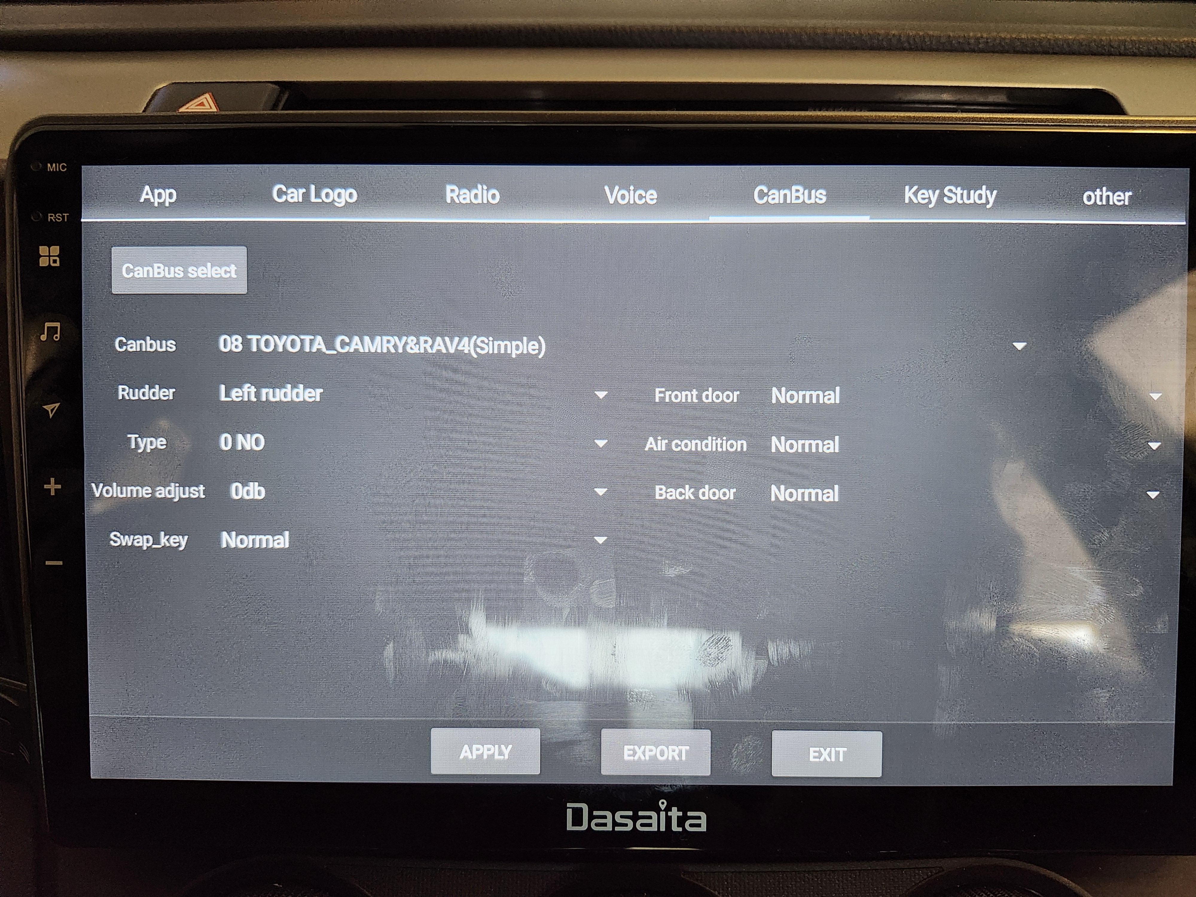

The CANBUS settings for 2016 Toyota Higlander no JBL : Settings>Car>Factory Settings:126>Canbus>No.8
@Support Dasaita and for the toyota rav4 2017 what the setting for the canbus ,the door d'nt work
@Rene Perreault
Thank you for your contact .
The CANBUS settings for toyota rav4 2017 : Settings>Car>Factory Settings:126>Canbus>No.8
If not luck,please go to the control settings to check the related settings.

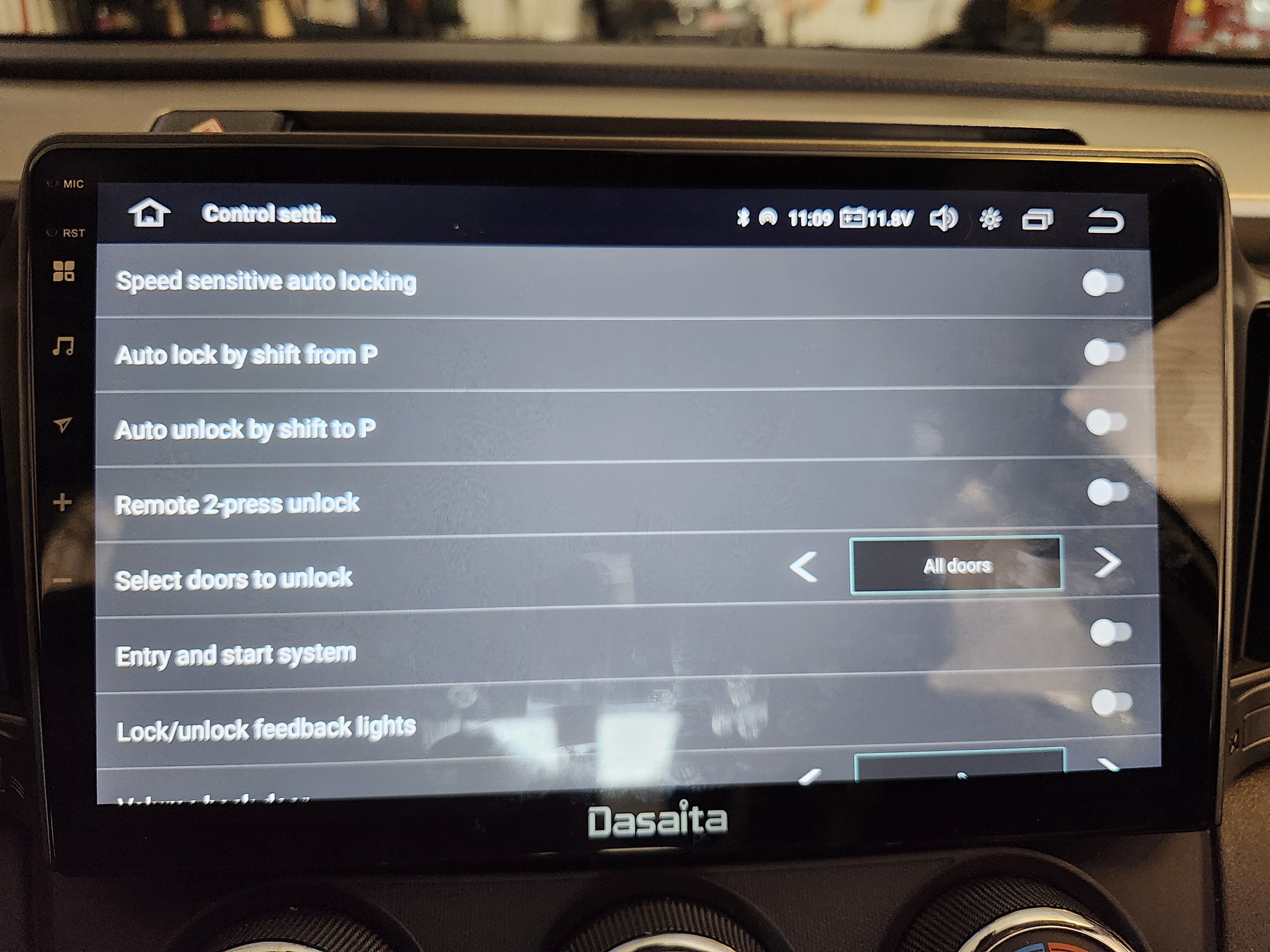

@Support Dasaita Contol Settings App. None of the settigns display values change
@Rene Perreault the pictures

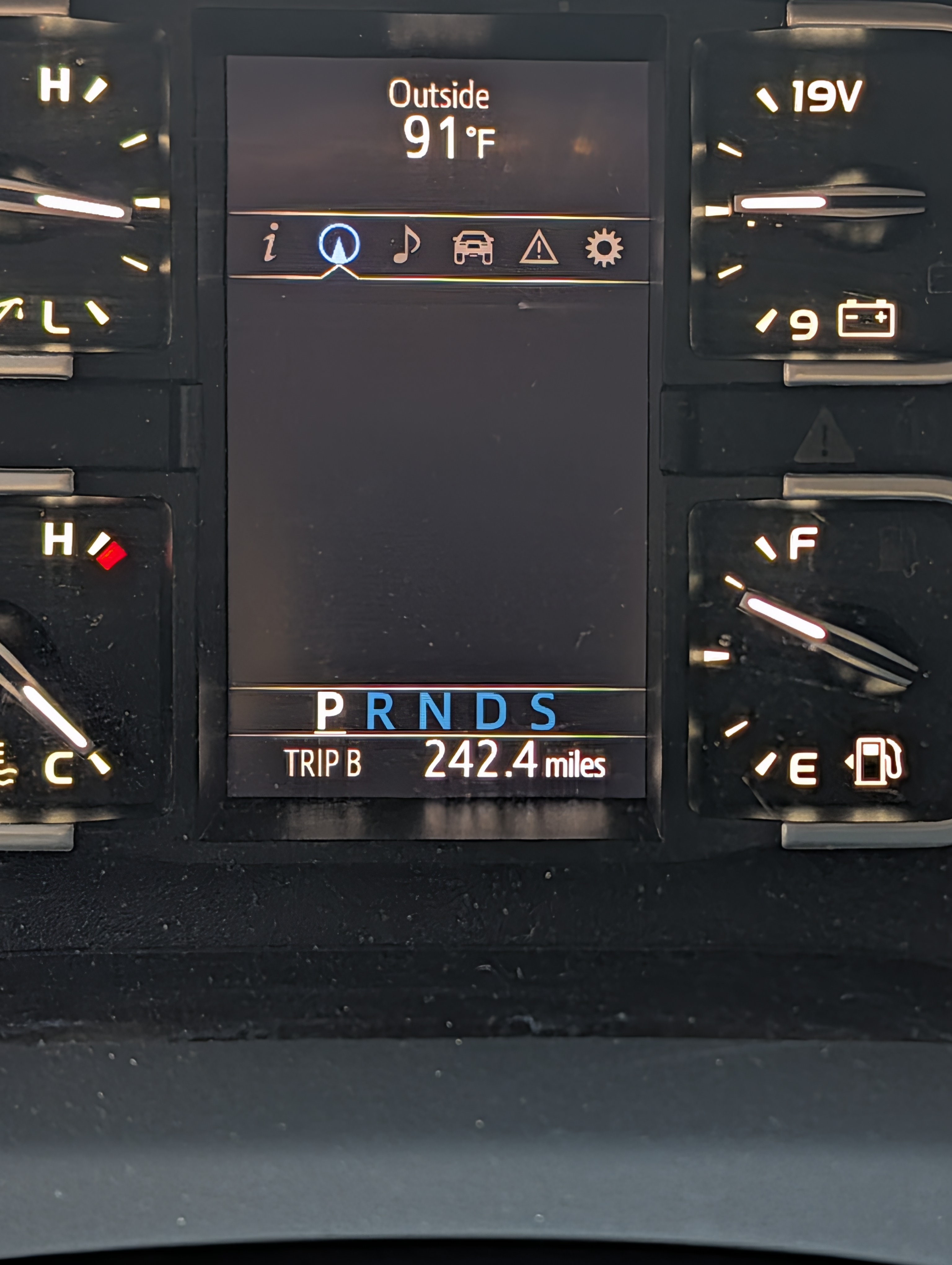

I am missing 2 displays on my dashboard. I already checked and have option 8 on the canbus. Also missing the music display to the right.
And where can I find the any digital gauges?
