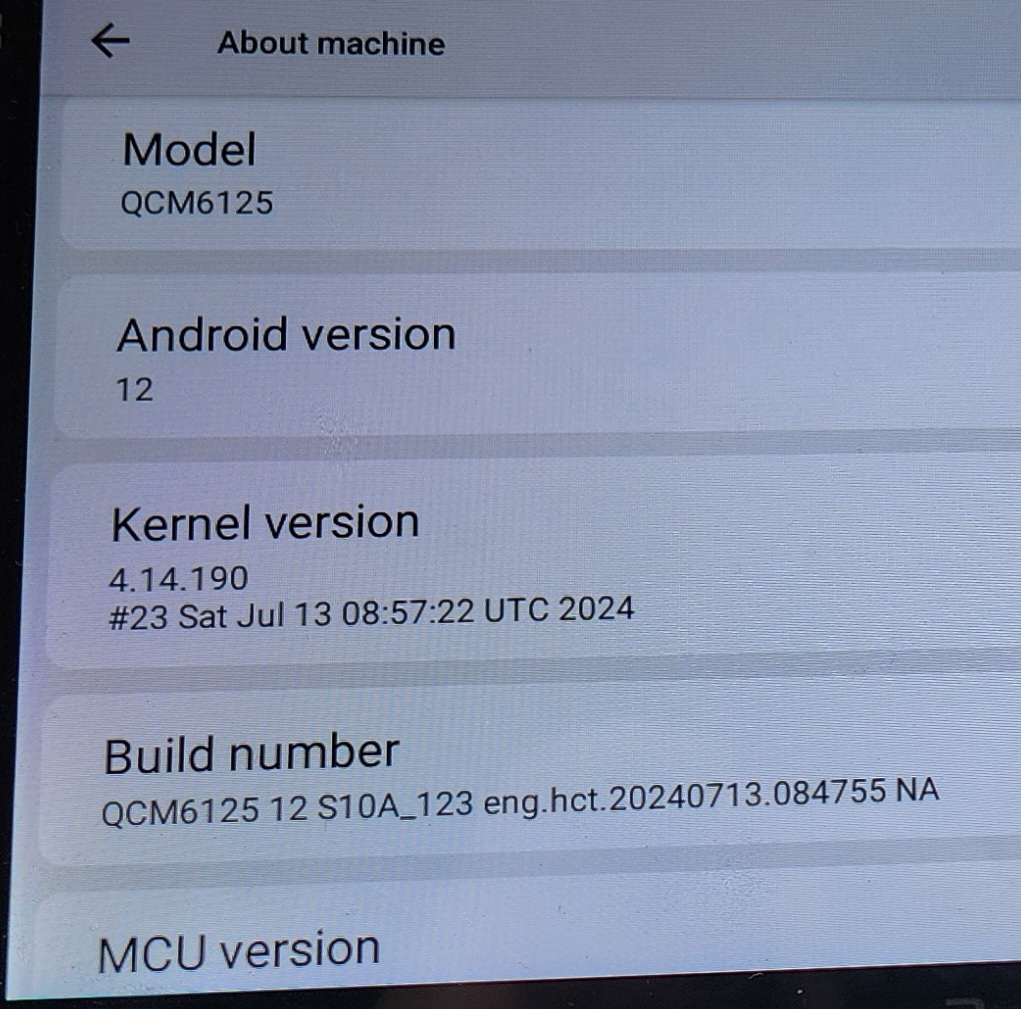

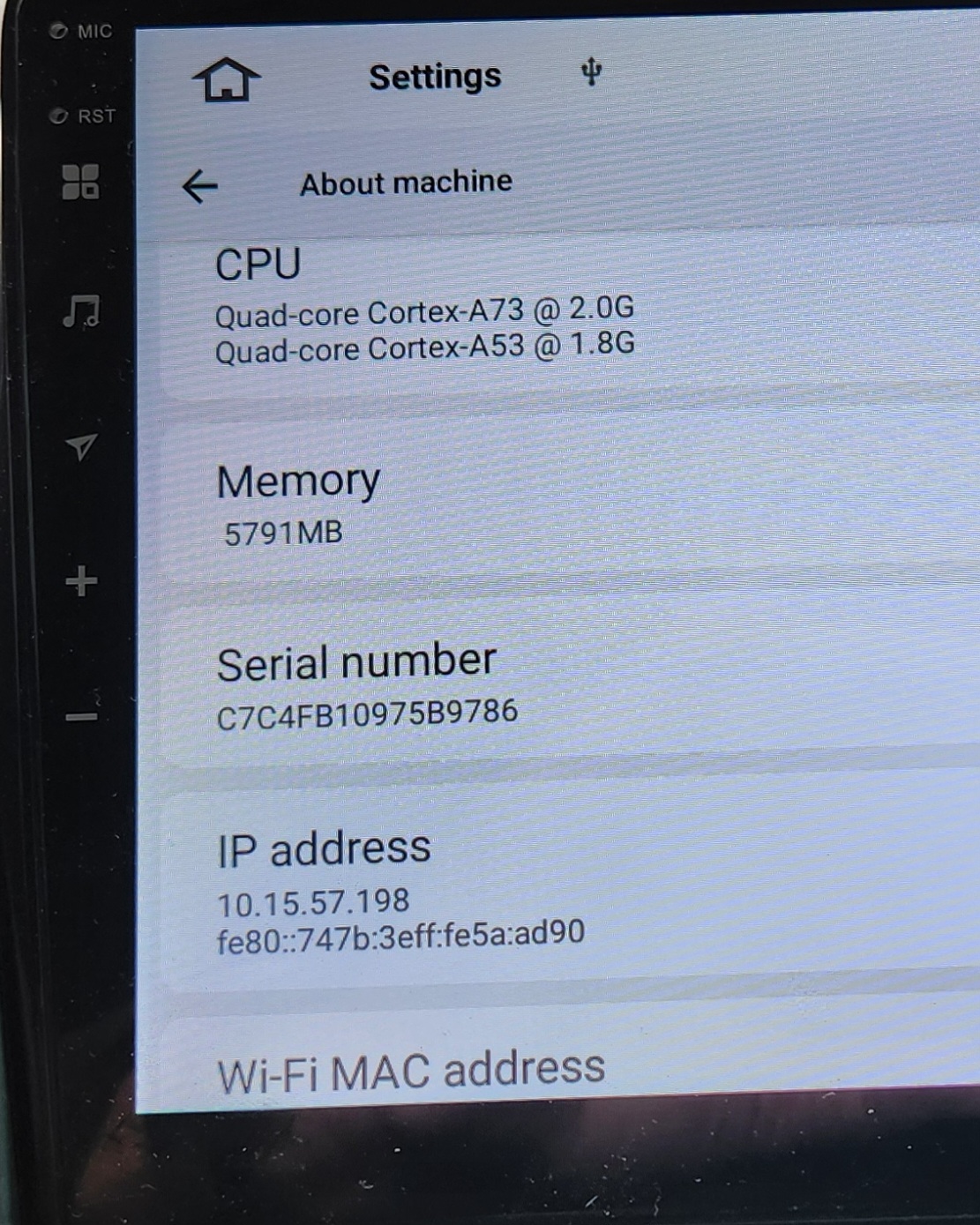

    If YES, please go Settings > About Machine,
  • The SXM app worked in my G12 for a few months before it stopped and I have the same experience now as the OP indicated, looks like it will load then it dumps.
  • I provided but it didn't show up.  Needs approval I guess?
    Android Version 12
    Build QCM6125 12 S10A_123 eng.hct.20240713.084755 NA
    MCU MTCH_HA4Z_V4.06_1   Sep 11 2023 20:01:17
