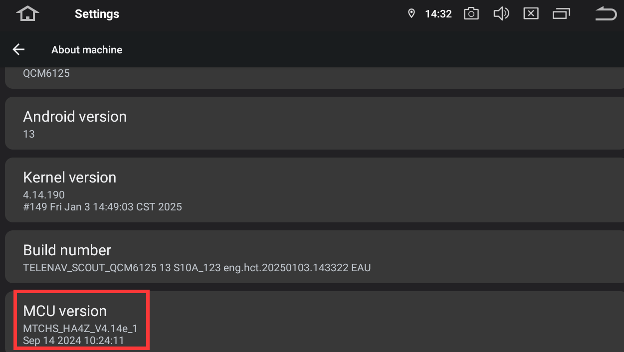

    Info
    Model
    QCM6125
    Build Number
    QCM6125 13 SA10A+123 eng.hct.20250311.103730 NA
    MCU Version
    Mar 8 2025 13:32:02
    Kernel
    4.14.190
    #179 Tue Mar 11 10:49:15 CST 2025

    Picture: Settings > About Machine > MCU version.
