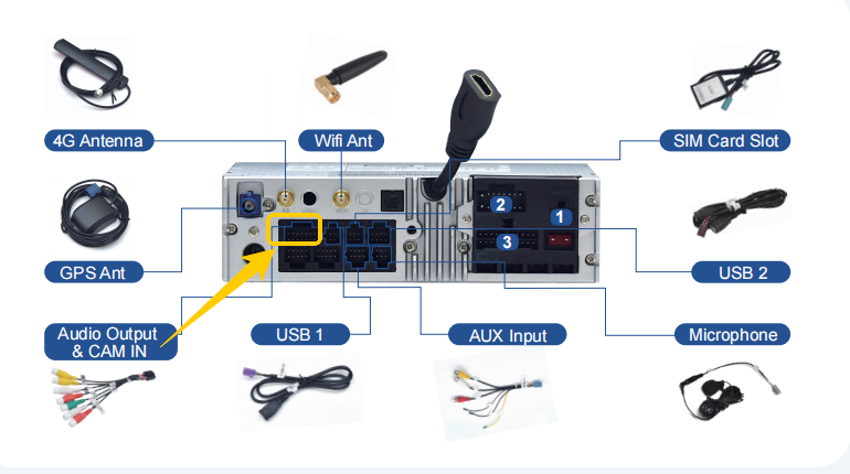

    Could you please confirm if the CAMIN cable is connected to the camera.

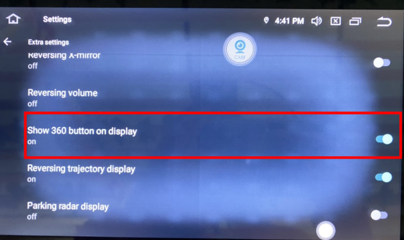

    Please make sure the setting is correct:
    settings > car > factory setting (Password: 126)  > CANBUS > choose the CANBUS option is 10 > apply > exit > restart
    settings > car> Extra settings >Show 360 button on display

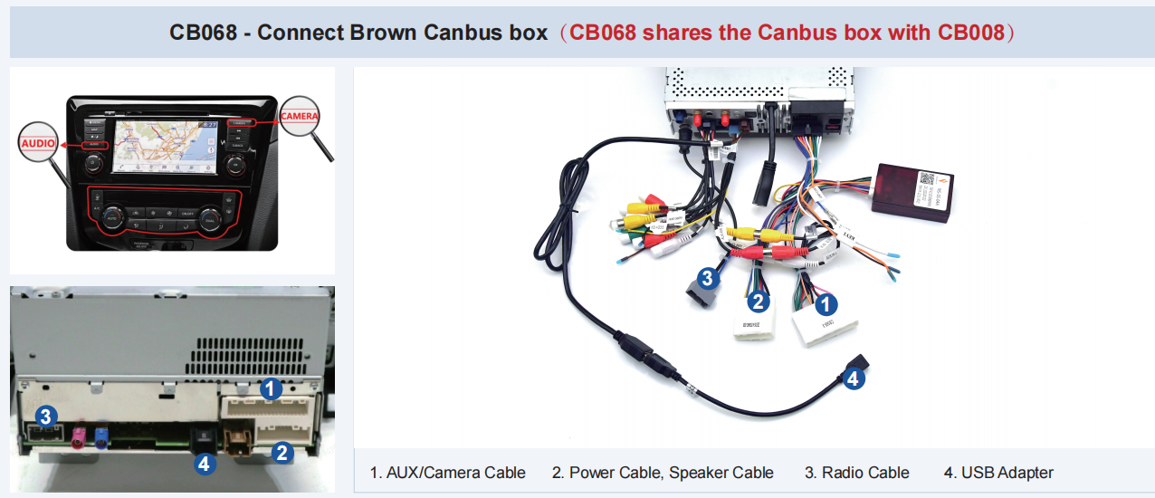

  • CAMIN cable is right connected.
    the cambus is correct CB068 the cables are all correctly connected
