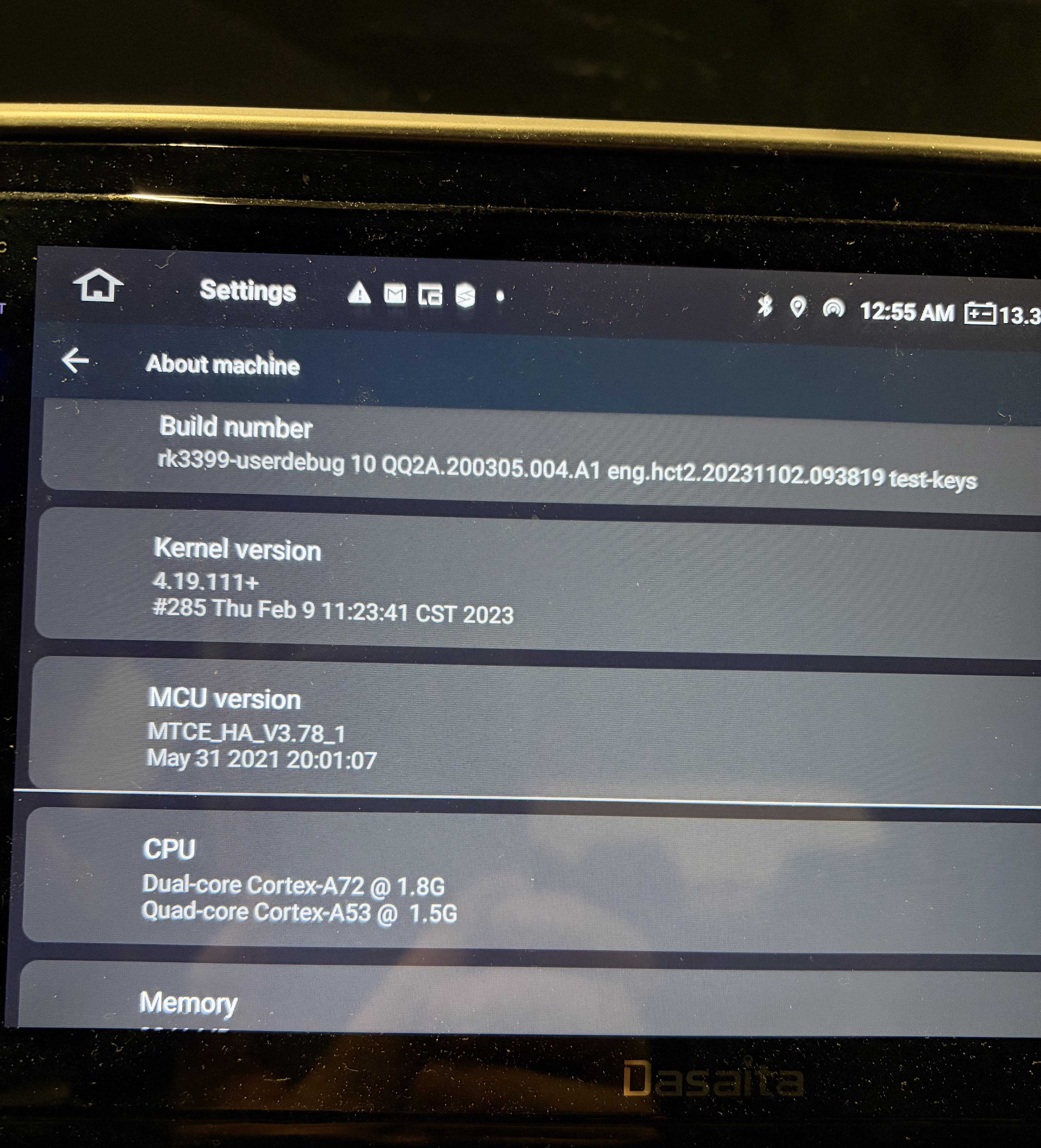

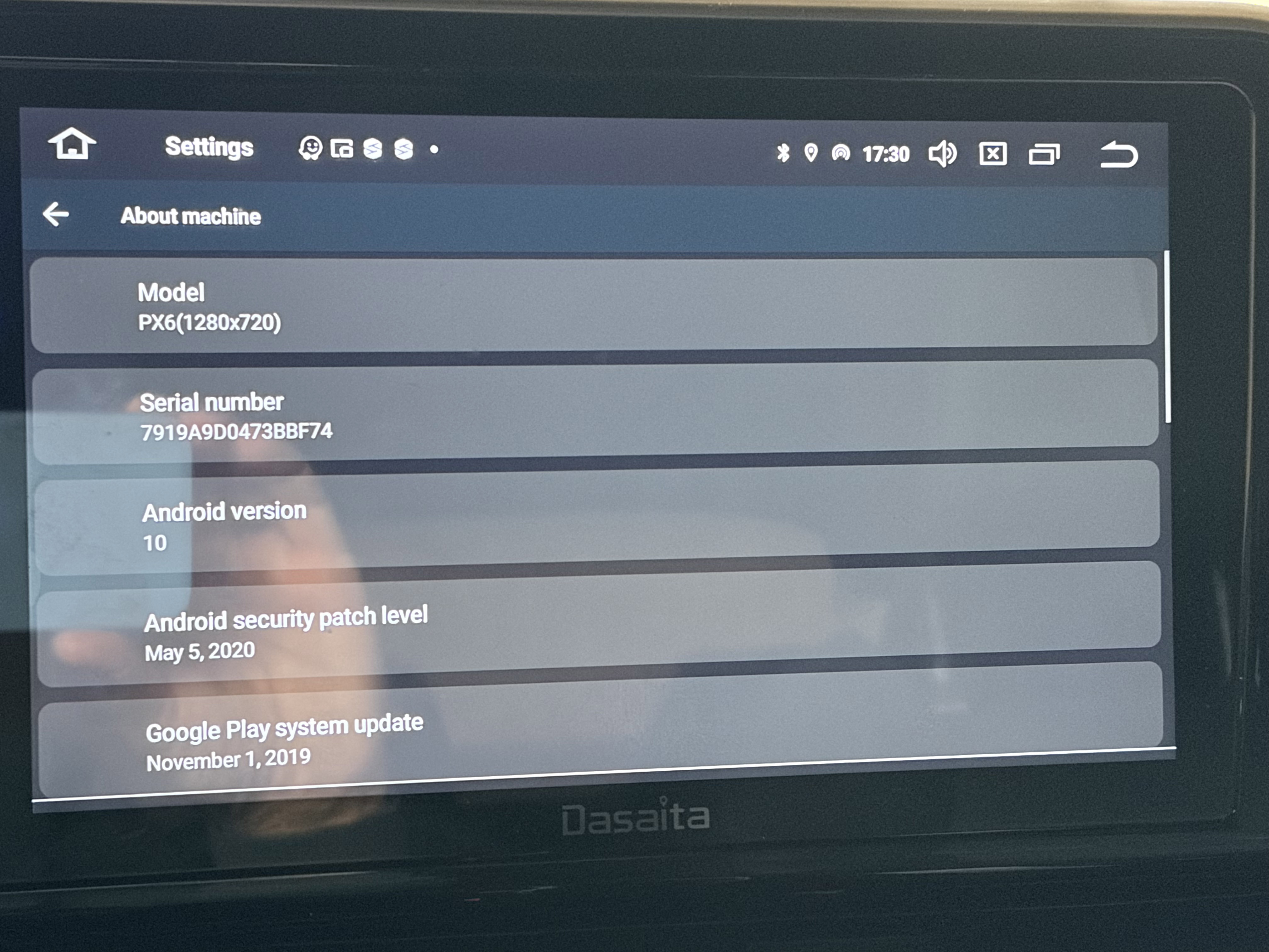

  • The only thing crashing on Android 9 is Zlink/CarPlay.  Below is a picture of the Android 11 with the updated firmware.  It definitely installed because the screens and apps changed significantly.
  • @Chris C. Please shot a video to show us the zlink connecting process of Android 11, we will forwarded to the engineer for help. For the Android 9, we just regret to tell you that it does not support.
  • @Support Dasaita I'm currently on android 11 max. I tried your latest vivid and that didn't work either. I think yall have an issue with the new N1 chips on the iPhone 17s.
  • @tland We are wondering if the firmware version in the photos is the one before your update. If not, we assume that you have not completed the firmware update.
