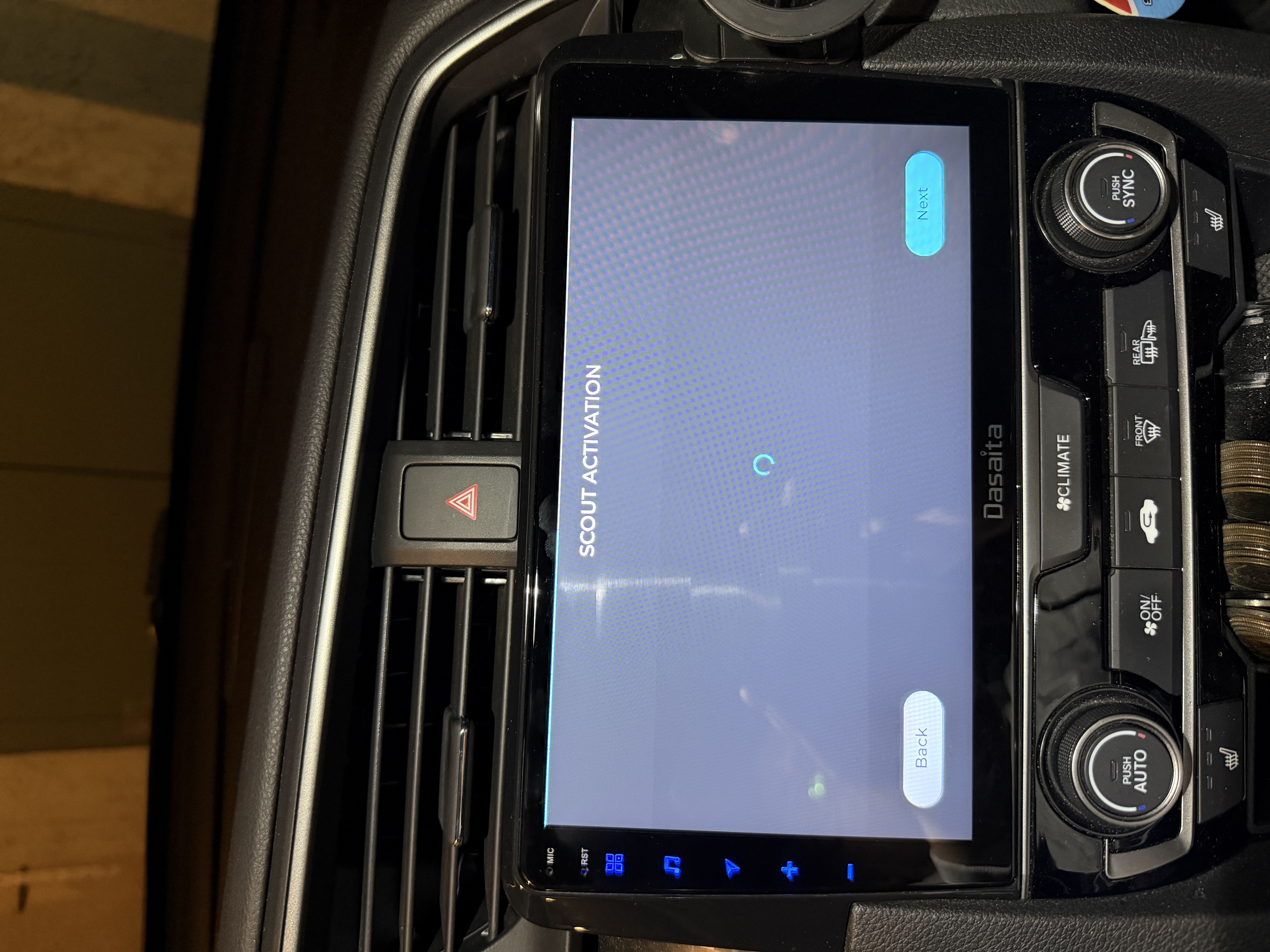

    I think I'm totally screwed now! So I installed that firmware you sent above, started on the install process for SCOUT, I clicked the User Agreement, connected to my wi-fi as instructed, now I'm stuck on this screen for almost an hour now as I send this message and it's not going anywhere!!! What now???
    Stuck screen
