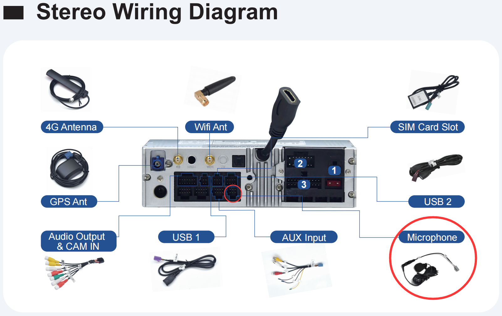

Just installed G13 running Android 13. People can’t hear me on the microphone. I hooked up the extrnal mic that came with the unit but it seems like only the little pinhole mic is operating. Checked permissions on ZLINK and it's all greyed out saying no permissions and won't let me grant permissions to the microphone. Can’t find any other settings to enable the external mic.

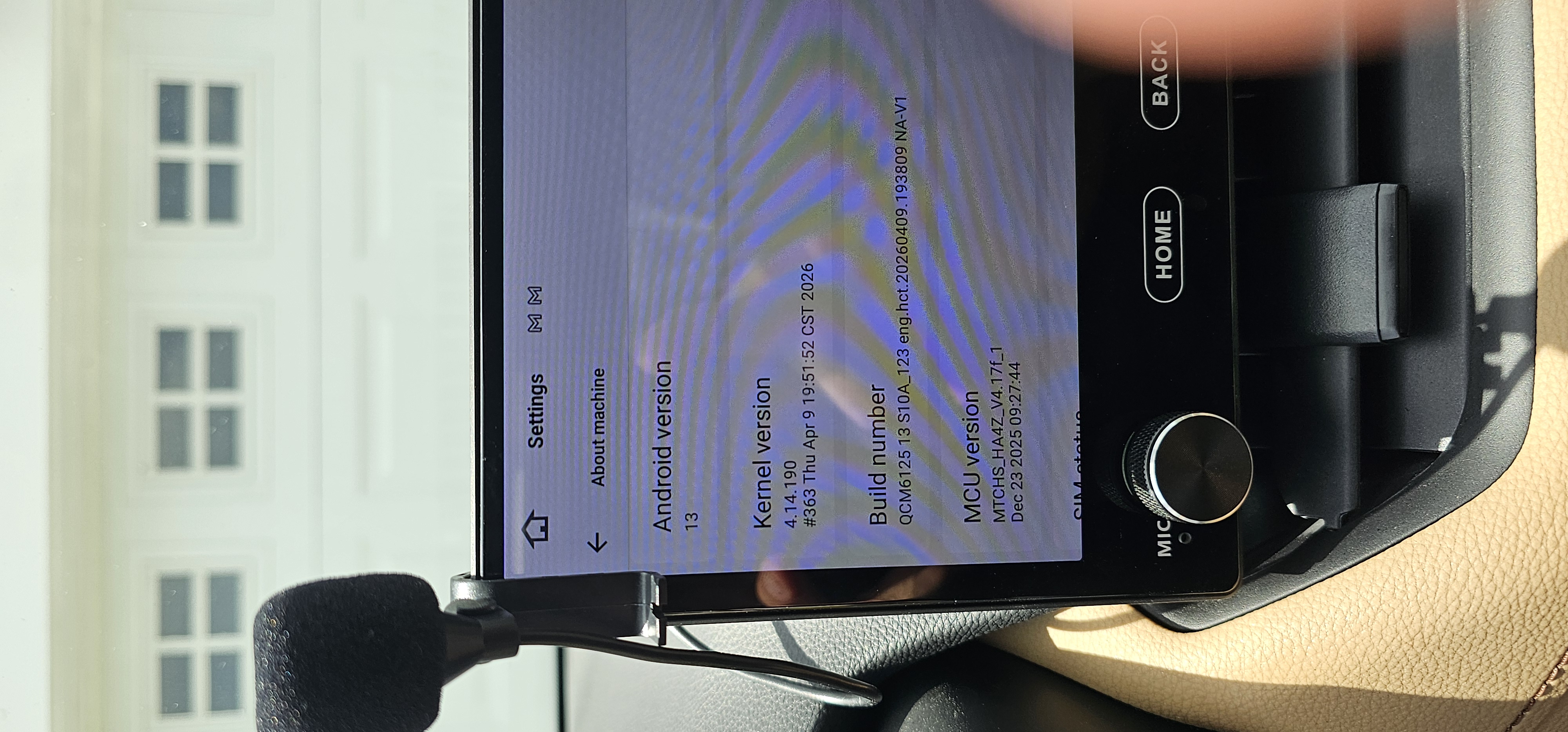

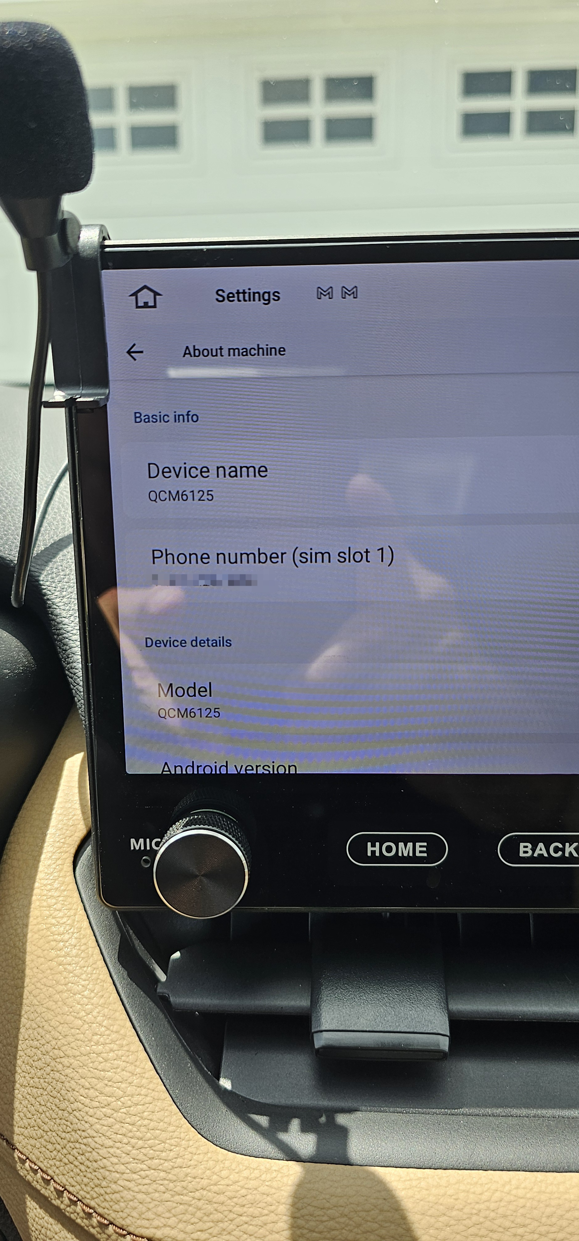

@Support Dasaita hello, im having the same issue. Should I apply the same update. Here are my screenshots....

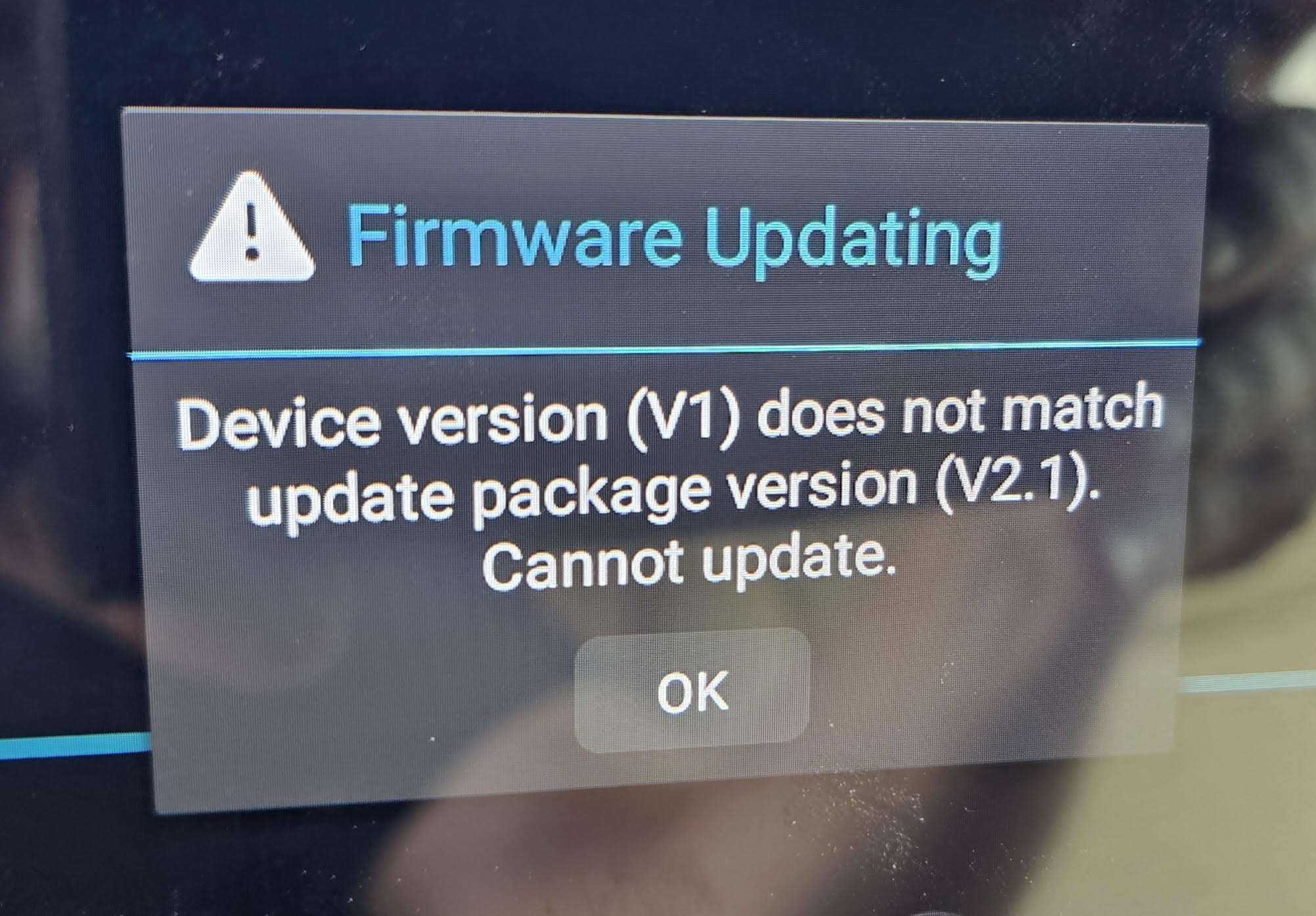

@Support Dasaita I tried the update and got this message:

@Richard Oliver
Please do not update.
The file is incompatible with your version.
@Support Dasaita hello, I unplugged the mic and it worked, and then plugged the mic back in and it worked but there was no difference between the quality and there is a good deal of background noise. Is the external supposed to provide clearer sound and/or less background noise?
