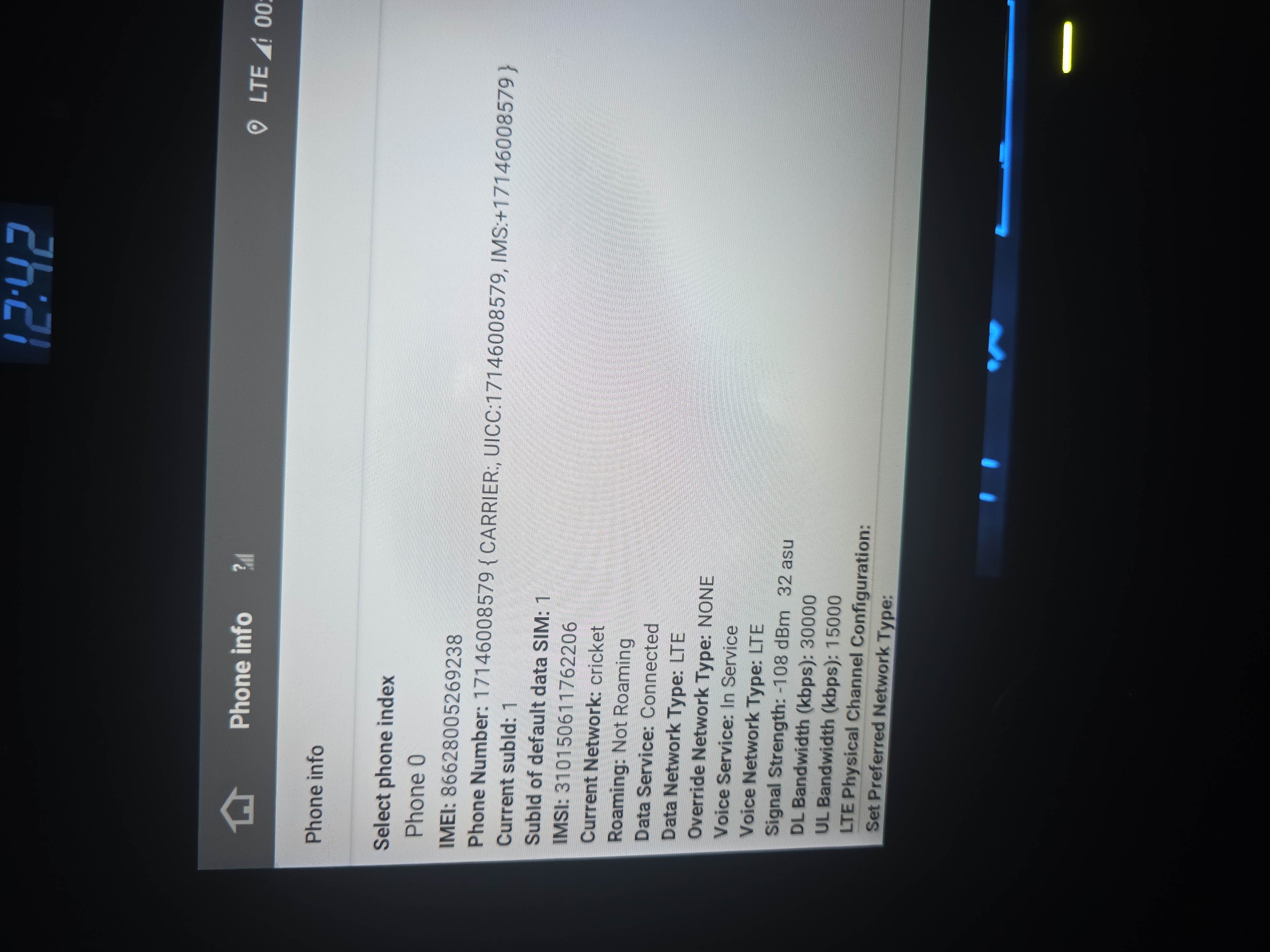

  • @Dasaita I am currently trying to use a Cricket SIM (AT&T Network) in my Dasaita G13, and cannot get it to connect either. APN is correct, and Dasaita recognizes it, but when I click on "connect to network" box inside network settings, it pulls up Cricket's websites and says my device isn't compatible now?
    I need an LTE connection to have my Dasaita run Life360 while it's on - in case it's stolen, I know where my car is.

  • @Support Dasaita I have tried every single Network type, none of them work. Verizon, Cricket, AT&T, T-Mobile, TracFone SIMs all do the same thing.
    My Dasaita G13 recognizes the SIM and phone number, the APN is correct, but I have no Internet access. I only see the (LTE📶!) symbol.
    I'm tired of troubleshooting and spending so much money on SIM cards and mobile carrier plans only to find out nothing works.
