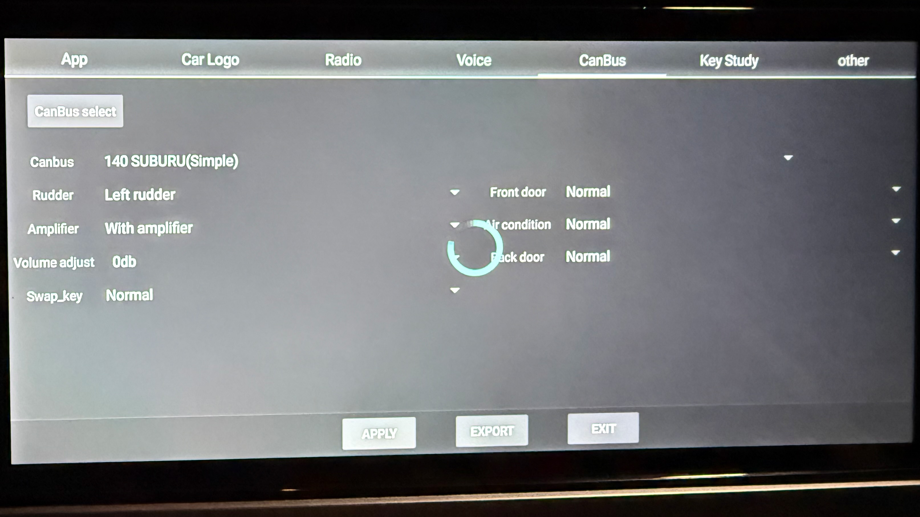

  • I own a Dasaita G13 head unit for a 2015 Subaru Outback with a Harman Kardon system. Everything is connected.
    Now I am experiencing the following issue:
    Sound comes out of the speakers only when I re-enable the settings every time. Upon restarting the car, the audio stops working again until I manually re-activate the setting in the menu.
    What can I do?
    The CAN bus decoder box initializes once, but it seems to hang or get stuck when the car restarts.
    The Simple Soft CANBUS seems to lose sound after restart
    Is there a software update available?
    I would appreciate your support.
    After several hours and attempts, a miracle happened.
    I don't know what I did, but now the Daisaita is working and the amplifier switches on.
    Problem solved.
  • Hello, I have the same issue with Subaru Outback 2015 with Harman Kardon amp with the Dasaita G13 unit with Simple Soft CanBus. Do you use the "with amplifier" or "without amplifier" setting in your canbus settings under factory settings?
    I can only get it to work using "without amplifier", but it doesn't sound as good as "with amplifier". Can you pleaseshare what settings you have. Thank you!
    I use the "with amplifier" setting under factory settings.
    Here my procedure,how it finally worked:
    As far as I can remember, I always made the settings with ACC on.
    The amplifier started working after I changed the setting to “No amplifier”, restarted the unit, and then changed it back to “With amplifier”. The amplifier was activated again, and the sound came through the Harman Kardon system.
    However, after restarting the unit, it seemed that the setting had not actually been applied, even though the correct setting was still displayed in the menu.
    I then changed my approach. I selected a setting outside of the Subaru profile, confirmed it, and restarted the unit. This time, however, I did it with the engine running.
    After that, I went back into the settings, selected the Subaru profile again, and confirmed the profile by pressing “Apply.” I did not press “Exit”. Instead, I immediately restarted the radio, again with the engine running.
    This time, the setting was finally saved correctly in the CANBOX. Since then, the radio has been working properly with the amplifier, and the sound is coming through the Harman Kardon system.

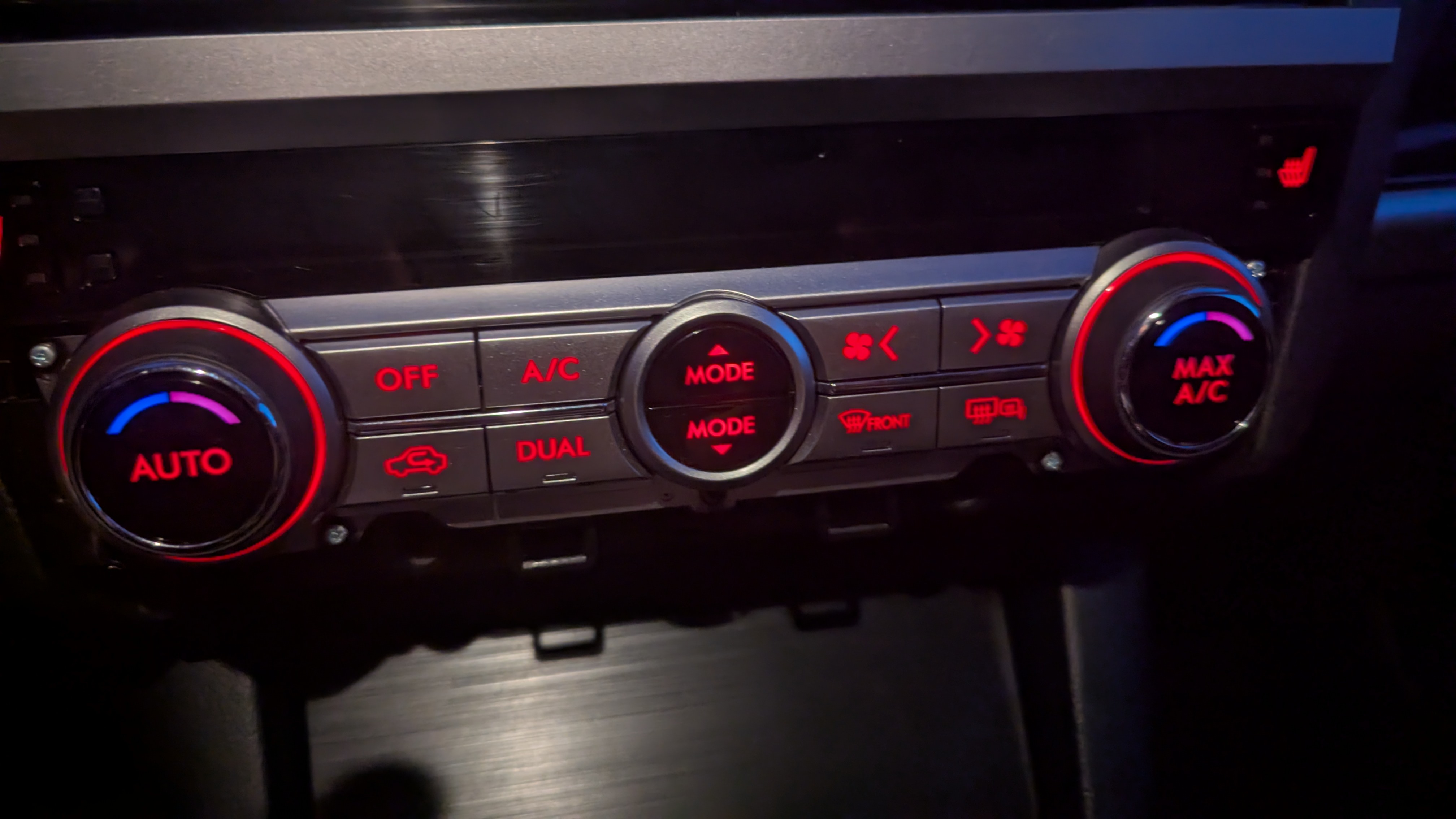

    But from now I have a problem with the HCAC illumination light. After closing the car the lights still shine.
    I think it is a grounding problem with the unit.

  • @Rafael O Regarding the issue of HCAC illumination light,could you please power off the car and disconnect the canbus box to see if the issue still happen?
    I have now tried everything I can think of.
    I disconnected the CAN box, completely removed everything, pulled the fuses, and checked everything thoroughly.
    Here is what I have observed:
    If I connect the original Subaru radio only to the 10-pin connector, the illumination goes off.
    As soon as I disconnect the original radio again, the illumination comes back on.
    It may possibly be a grounding issue, or there may be a small resistor built into the original radio that affects the illumination circuit.
    I’m slowly running out of ideas.
    With the Dasaita radio, the illumination stays on continuously.
    Could this be a grounding issue?

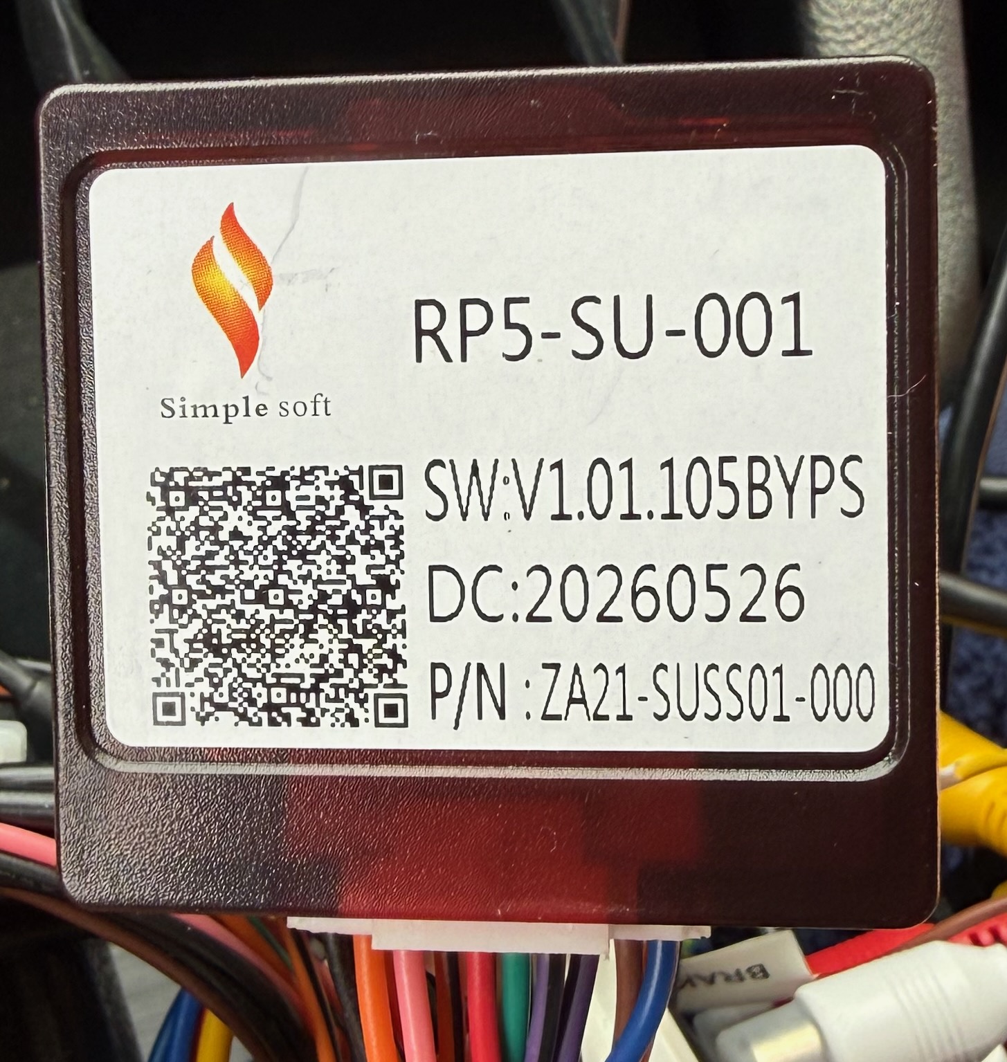

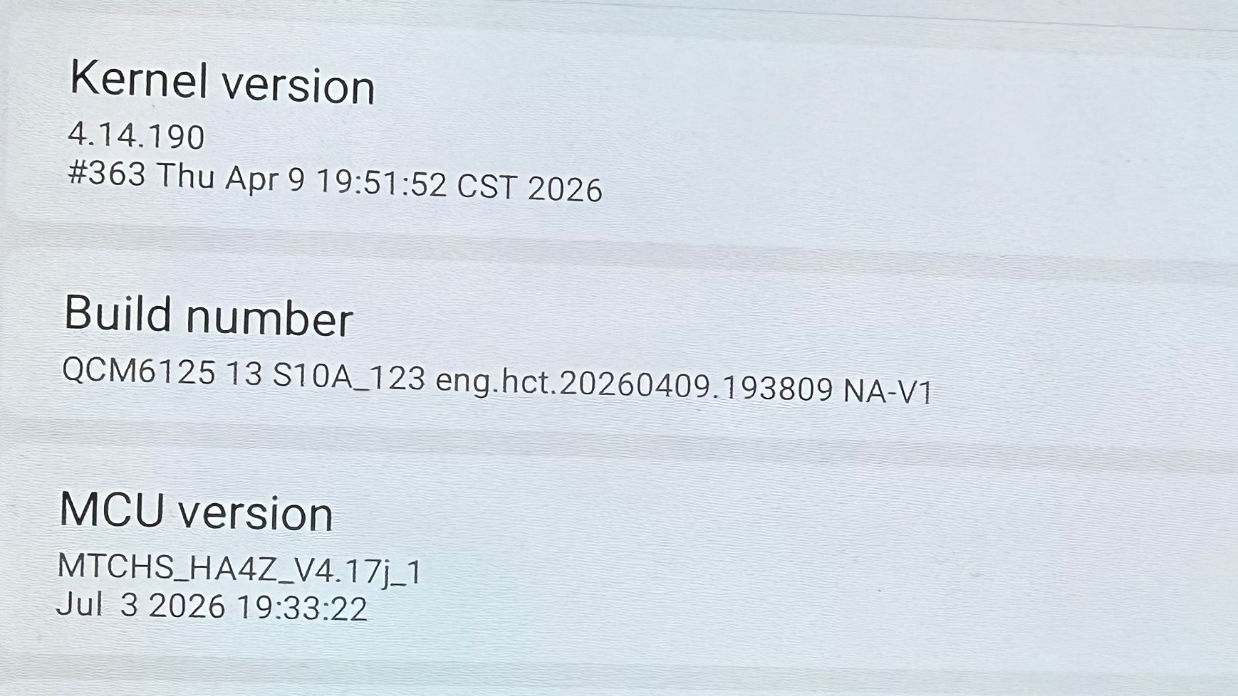

  • @Support Dasaita I have the CB076-1 harness installed based on the model number mentioned in the flyer included with the unit. I'm also including a picture of the CanBus here.
    I ordered from Amazon.com on Aug 26, 2026, order number 113-0921450-9719435. Model number HA2271. I posted a picture of my Android, kernel and MCU versions in a previous message above.

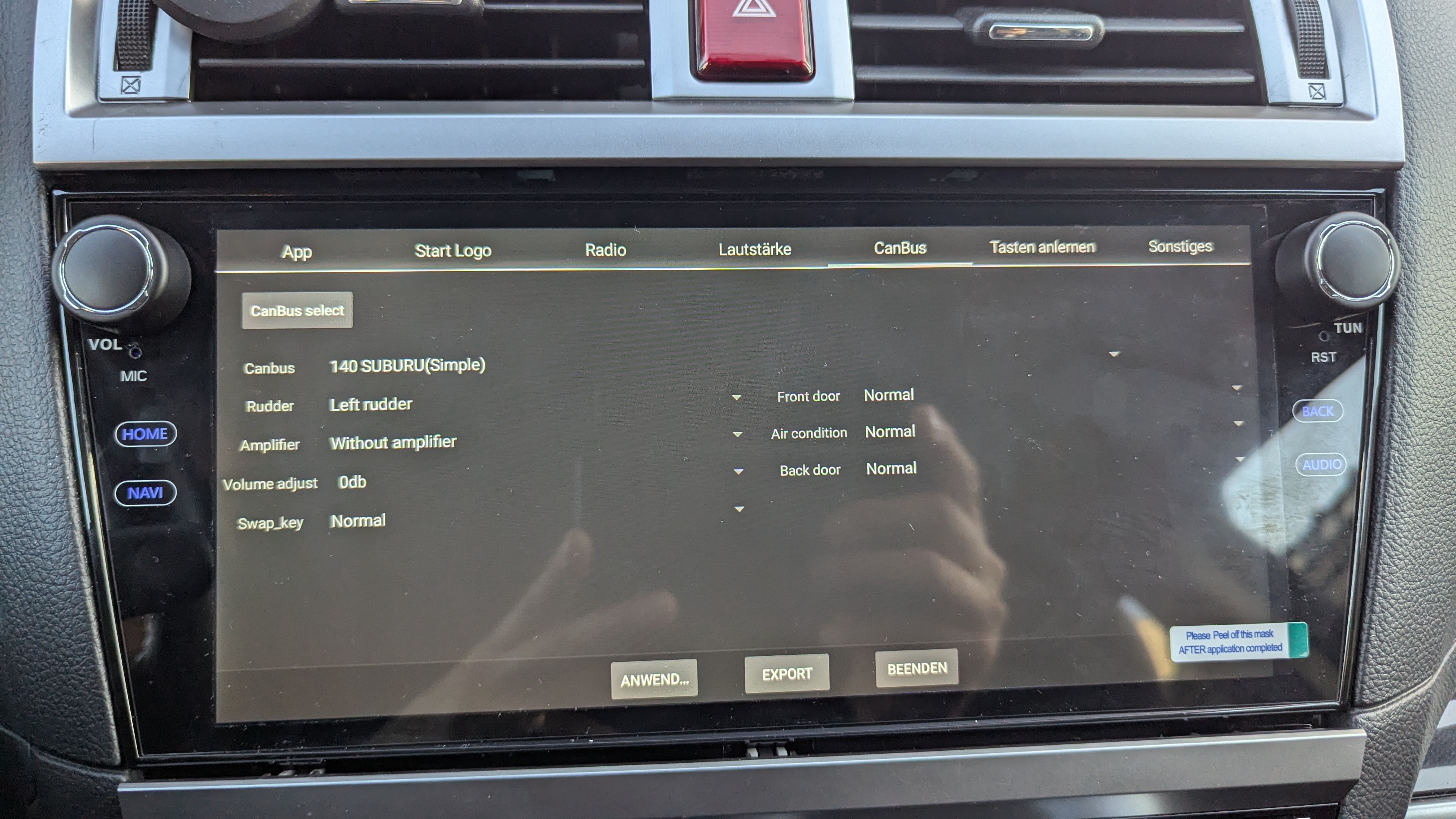

  • @Support Dasaita here is the issue and the steps I tried. I'll prefer the "with amplifier" setting since the sound is better than "without amplifier".
    Hardware, Firmware and Configuration
    • G13 for Subaru Outback
    • Model HA2271, Ver V1, LCD 114, US 8+128
    • Android 13
    • CPU: QCM6125
    • Kernel-version: 4.14.190 (photo shared in above post)
    • Build: QCM6125 13 S10A_123 eng.hct.20260409.193809 NA-V1
    • MCU: MTCHS_HA4Z_V4.17j_1, Jul 3 2026
    • CB076-1 harness, Simple Soft CANBUS box
    • CanBus settings: 140 SUBURU(Simple), Rudder Left, Volume adjust 0dB
    • 2015 Subaru Outback with Harman Kardon amplifier
    The fault
    • CanBus setting Amplifier: "Without amplifier" works correctly and survives ignition cycles.
    • "With amplifier" does not play any sound after restart.
    • "Auto detect amplifier" played the audio after the first restart. I could verify it was sending constant level to the HK amplifier because the mute button in the Volume screen in the Amplifier Android app did not mute it, only the physical mute buttons muted it. After another restart, the audio played for 3-5 seconds and then goes silent.
    • Once silenced, the amplifier stays silent across ignition cycles and across head unit reboots, and remains silent even after switching back to "Without amplifier".
    • The only reliable way to recover sound is: Set CanBus amplifier setting to "without amplifier". ignition fully OFF, pull 20A "audio amplifier" fuse from engine bay, wait 1 minute, reinsert.
    Key observations
    1. Pulling fuse B with the ignition ON or the head unit running does NOT resolve it, even after 10 minutes. Only an ignition-off fuse removal works. This suggests the amplifier may have a second power supply that keeps its control section alive when the ignition is on.
    2. In amplifier mode, EQ, Delay and DTS still affect the sound, but the Volume per-channel mutes, channel levels and Loudness in the amplifier app are bypassed. Only the front left and right channels are live in either mode.
    3. I replicated Rafael's procedure faithfully, including selecting a non-Subaru profile (62 FOCUS_ECOSPORT&ESCAPE&CARNIVAL (Simple), which has no amplifier field), confirming audio was still playing on that profile, then selecting 140 SUBURU(Simple) with "With amplifier", pressing APPLY without Exit, and restarting from the pull-down menu with the engine running. This did not work for me. I repeated it with a Raise Canbus Honda profile as the intermediate with the same result. "With amplifier" has failed on every attempt regardless of route, amplifier state, engine running or ACC.
    4. I tried to save the CanBus log. But the 'Save 3' button in the logcan screen does not give any confirmation that it saved the log to a file. If you want the logcan log files, can you give me step by step instructions on how to save the logs and copy the log file to a USB drive?
    Questions:
    • Does the MCU or CANBUS box send a mute or amplifier-disable command during initialisation in "With amplifier" or "Amplifier Auto detect" on protocol 140 Subaru?
    • Is there updated MCU or CANBUS box firmware for Subaru protocol 140 with the 2015 to 2017 Harman Kardon amplifier? I noticed firmware G13_V1 (20260811) and MCU 4.18a were provided in another forum thread for a different issue on an identical build and MCU version.
    • Is there a known good hmcu configuration that will work with the "with amplifier" CanBus setting with the HK amplifier? If so, could you provide the hmcu.cfg for so I can restore it?
      Thank you!

    Do you also have the problem with the HVAC illumination? Could you try connecting your HVAC control panel?
    Does the illumination also remain lit after you switch off the vehicle?
  • @Rafael O I don't have the HVAC lighting issue. Mine is connected. The HVAC light turns on only when my headlight is on.

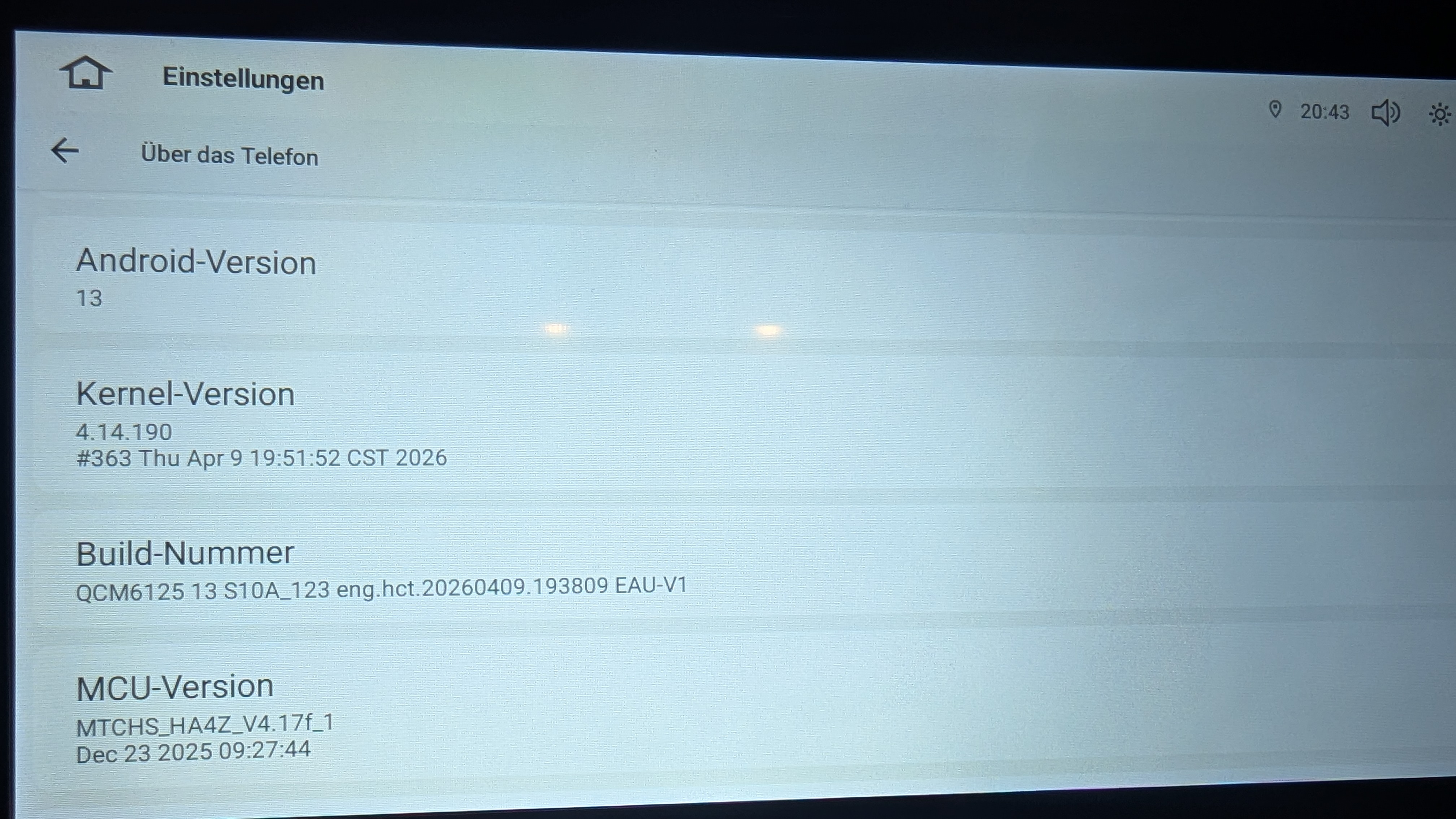

    Frustrating to hear for me.
    You have the 8+256 GB unit - or another unit?
  • @Rafael O I have the 8+128GB

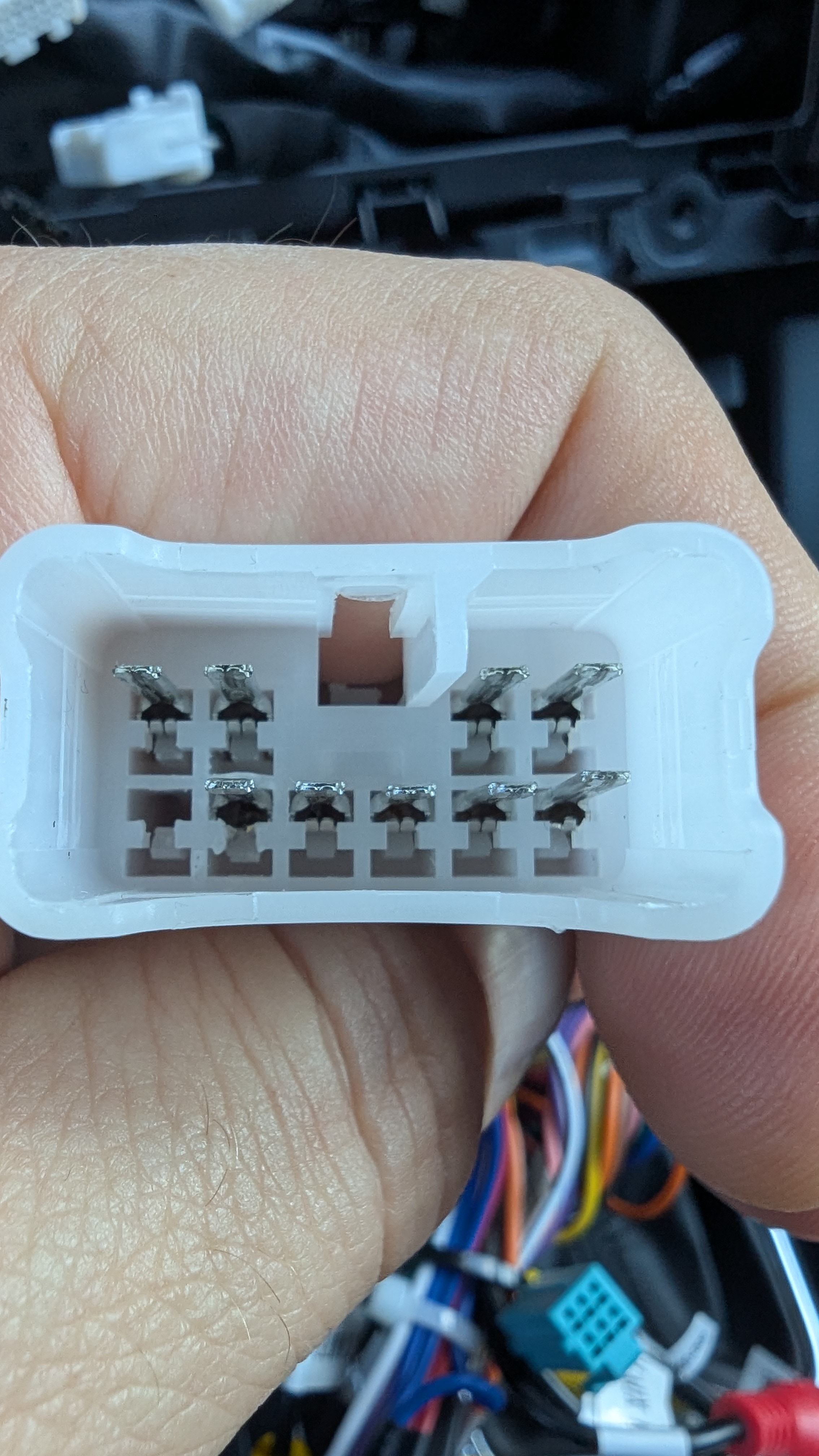

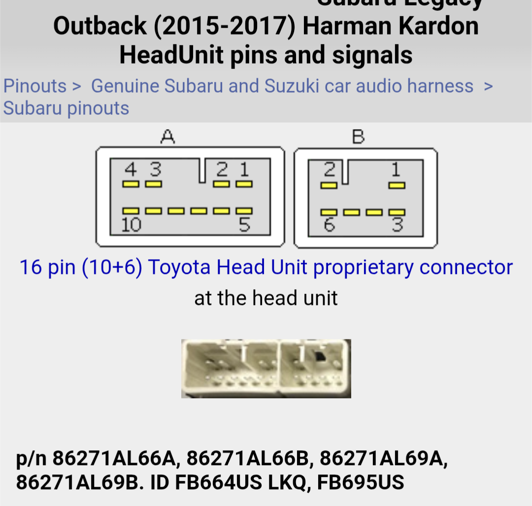

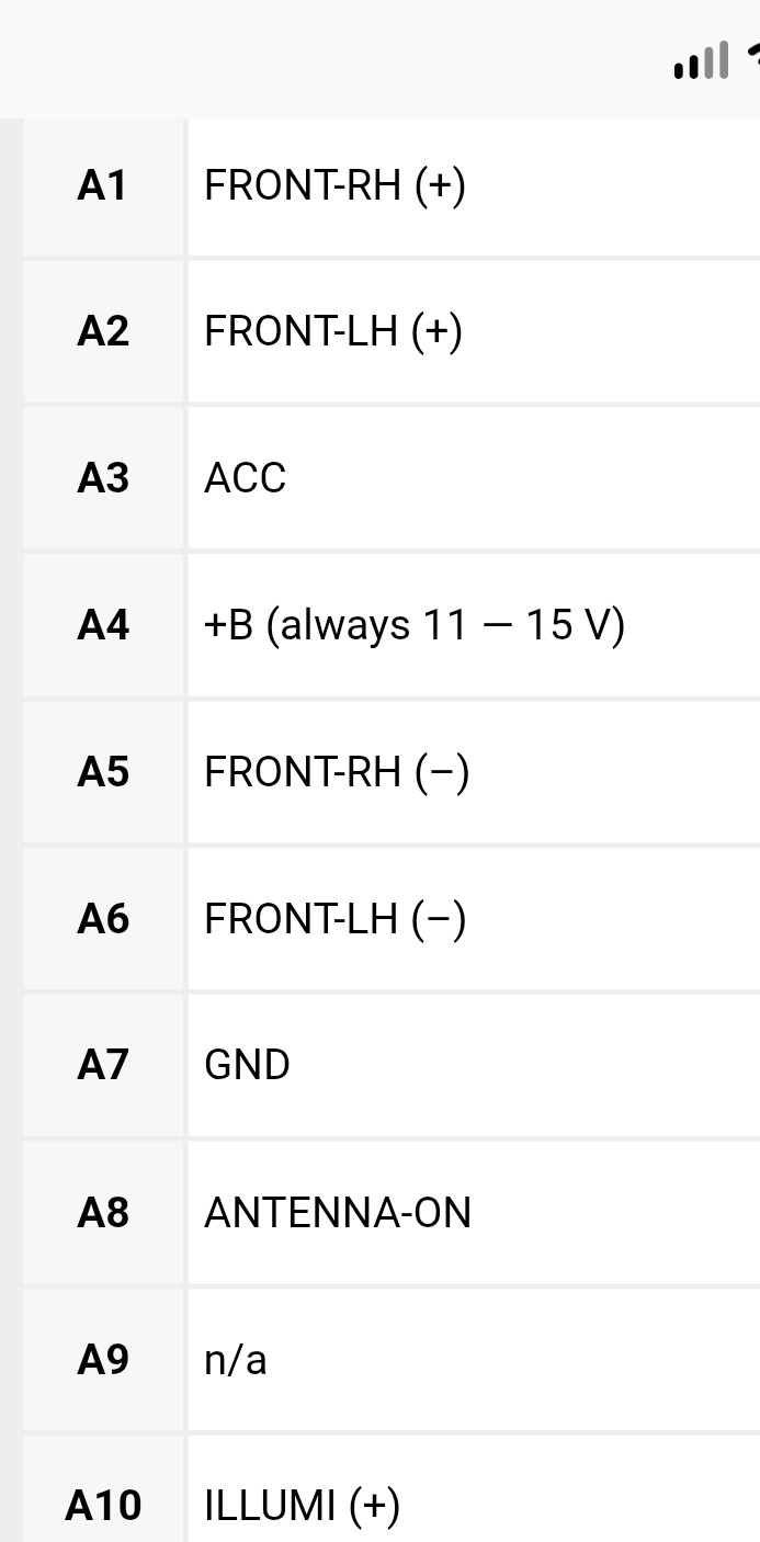

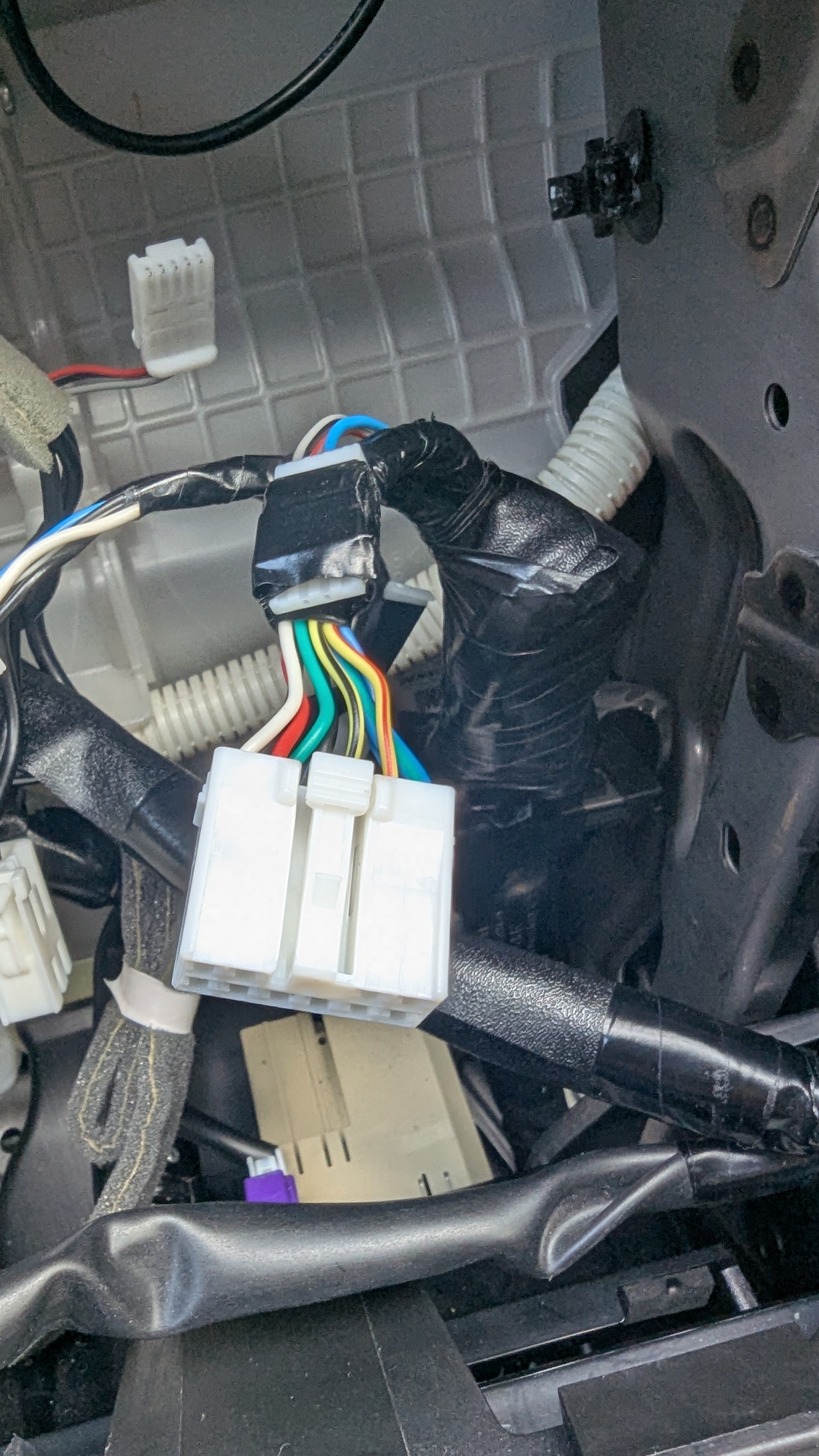

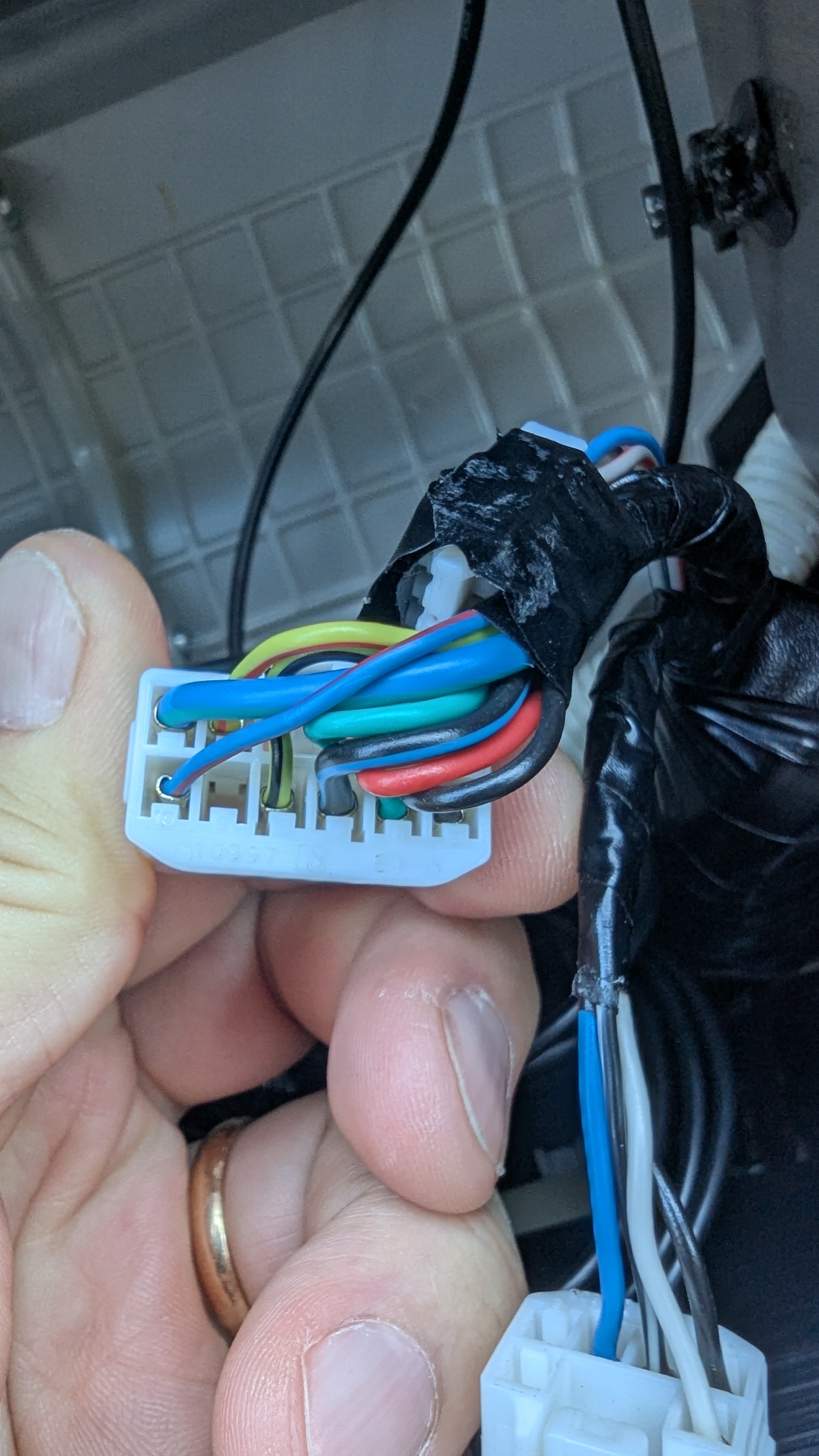

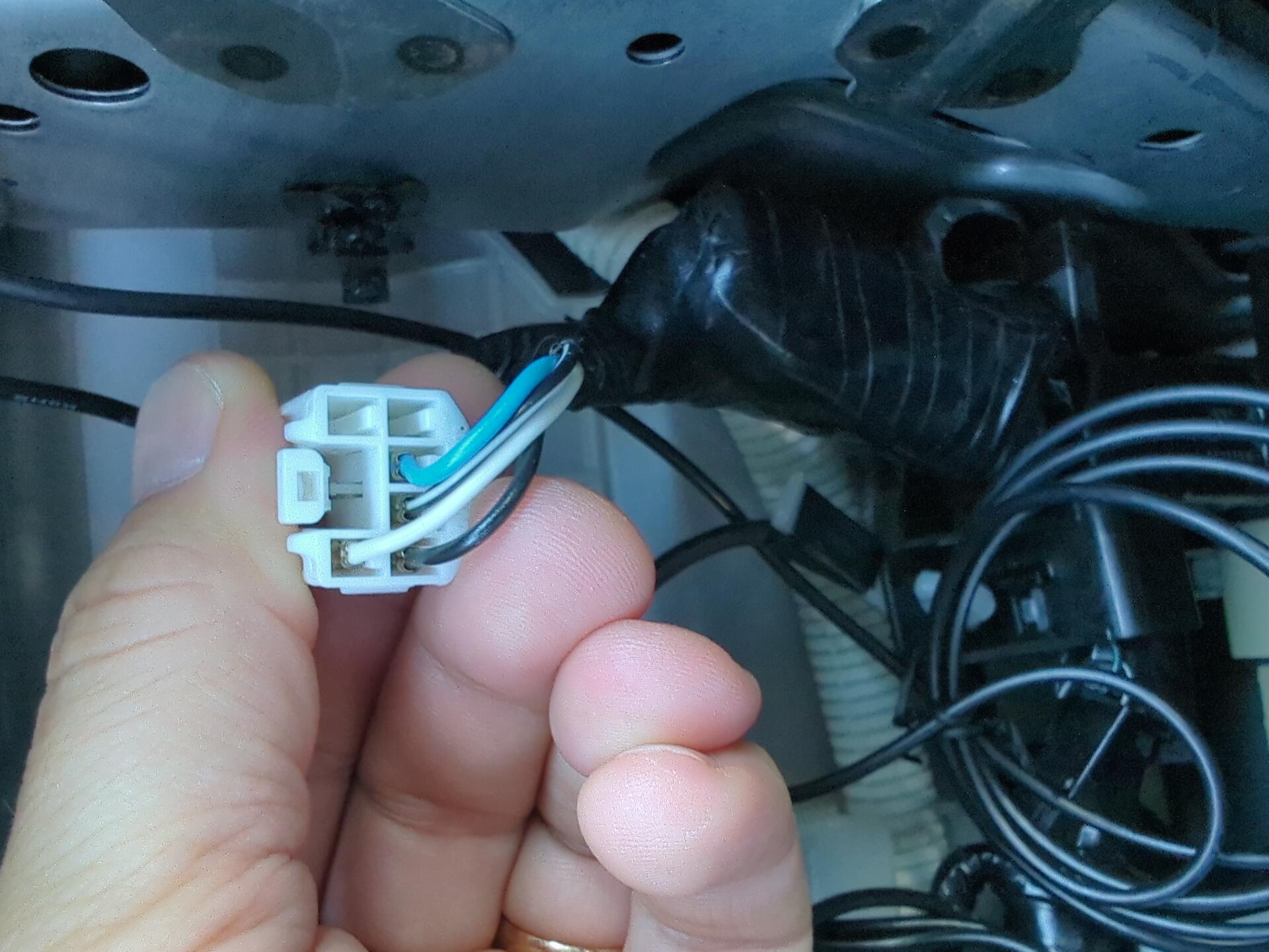

  • I have the European version of the 2015 Subaru Outback BS. Could the different wiring in the European version be causing the problem?
    Pin 9 on the original vehicle wiring is not assigned / is not connected.
    However, pin 9 on the CANBUS adapter is assigned and has a white-blue color. Could this difference be causing the HVAC illumination issue?
    I connected pin A3 and pin A7 of the Subaru wiring harness to A3 and A7 of the original radio using small jumper wires. However, the HVAC illumination remained on.
    After bridging A10 of the Subaru wiring harness to A10 of the original radio, the HVAC lights switched off.
    This confirms that pin A10 is responsible for the illumination function. Pin A10 is labeled ILLUMI+.
