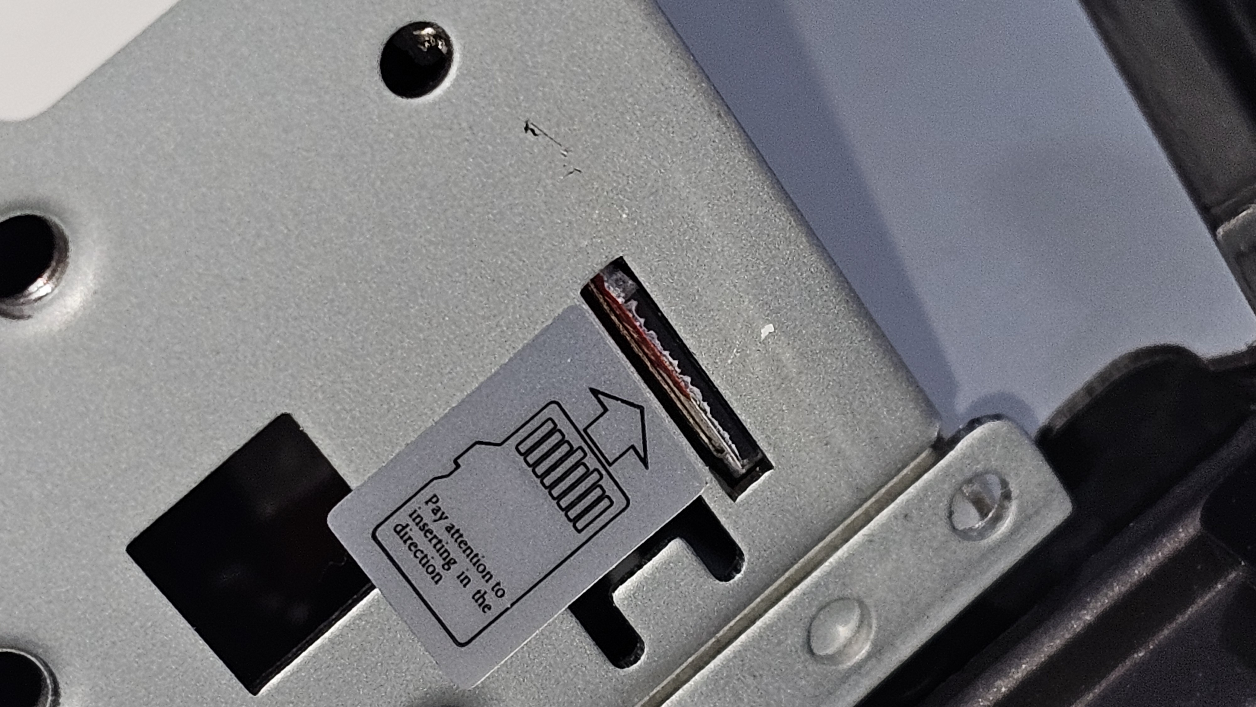

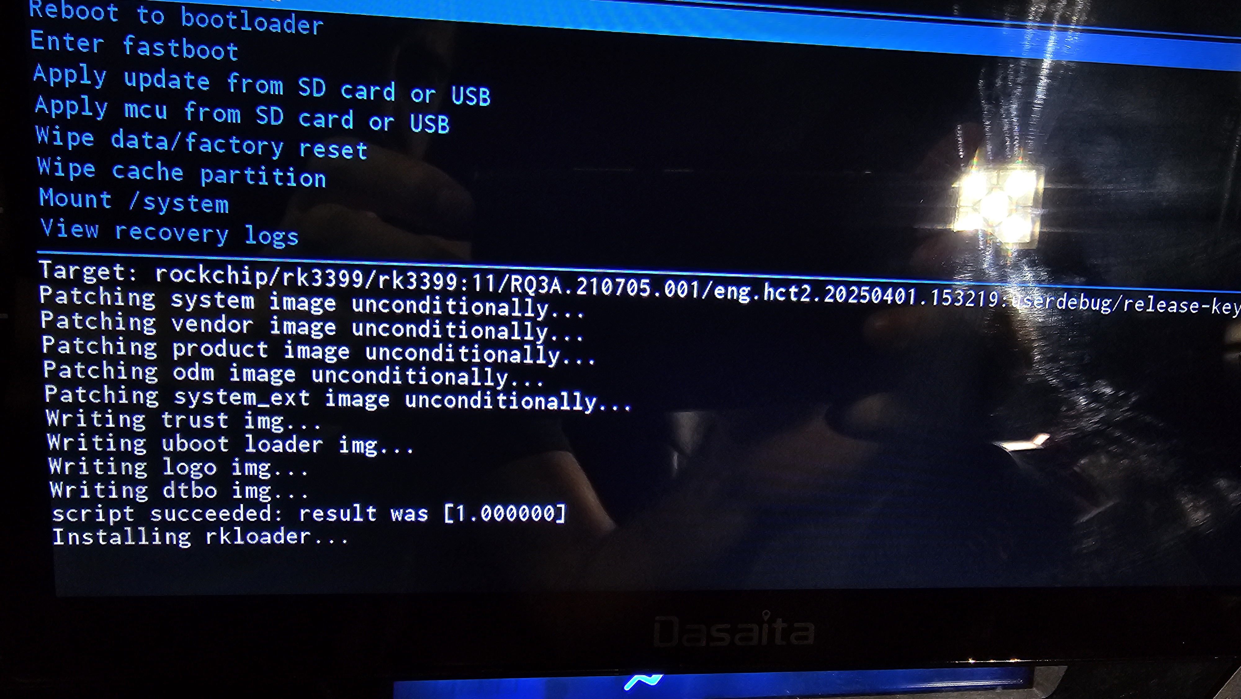

    What @Jorden Peacock did for solving it (he couldn't access to the recovery menu, whatever combination of reset button) was the following:
    Get a microsd card and format it as FAT32.

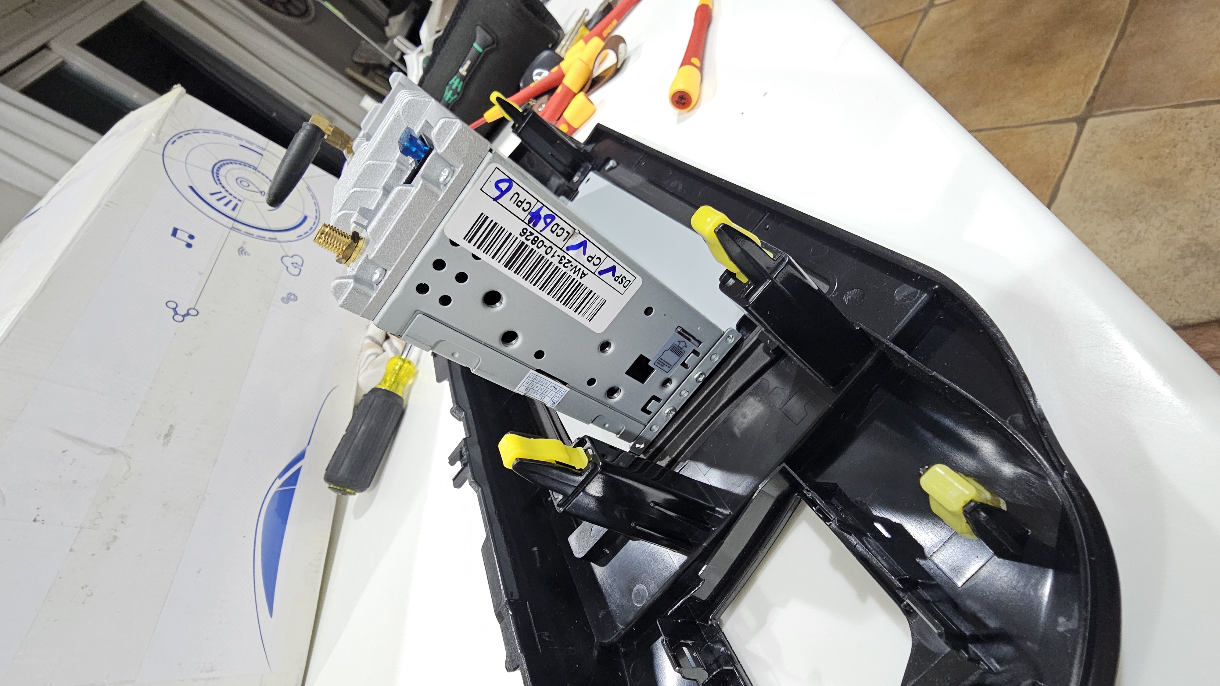

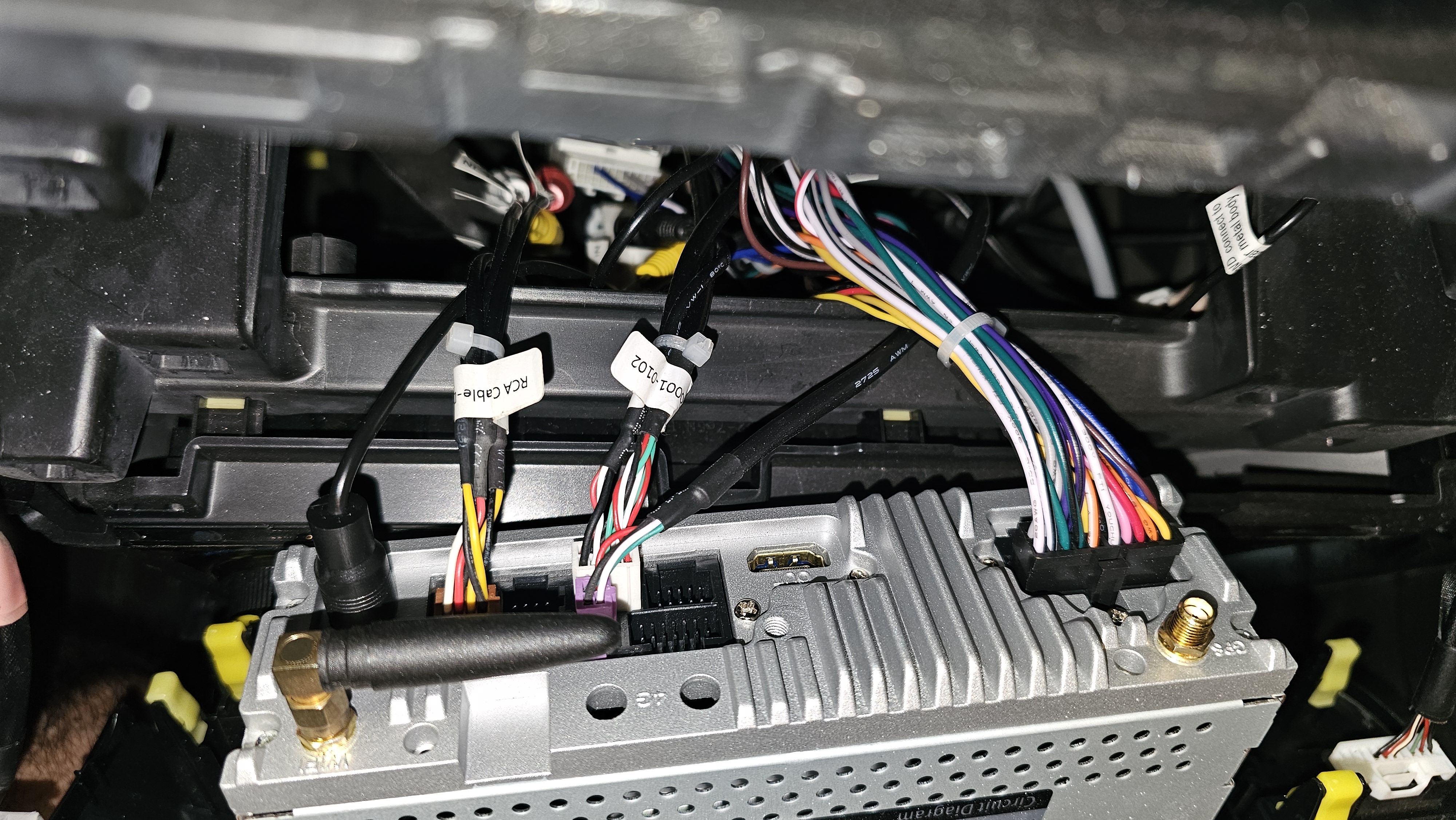

    Copy the VIVID 10 OTA update on it and insert it on the SDCard slot (it is on the lateral of the unit  - you must remove the unit from the car to access it)
    Reboot your unit (remove the fuse of the car for about 30secs) and switch on the unit. If the unit during boot does not go directly to the Recovery menu (with the sdcard inserted) , then try again the reset method for the recovery menu (with the sdcard inserted as well). finally you could access it and tyou could update your system again .
