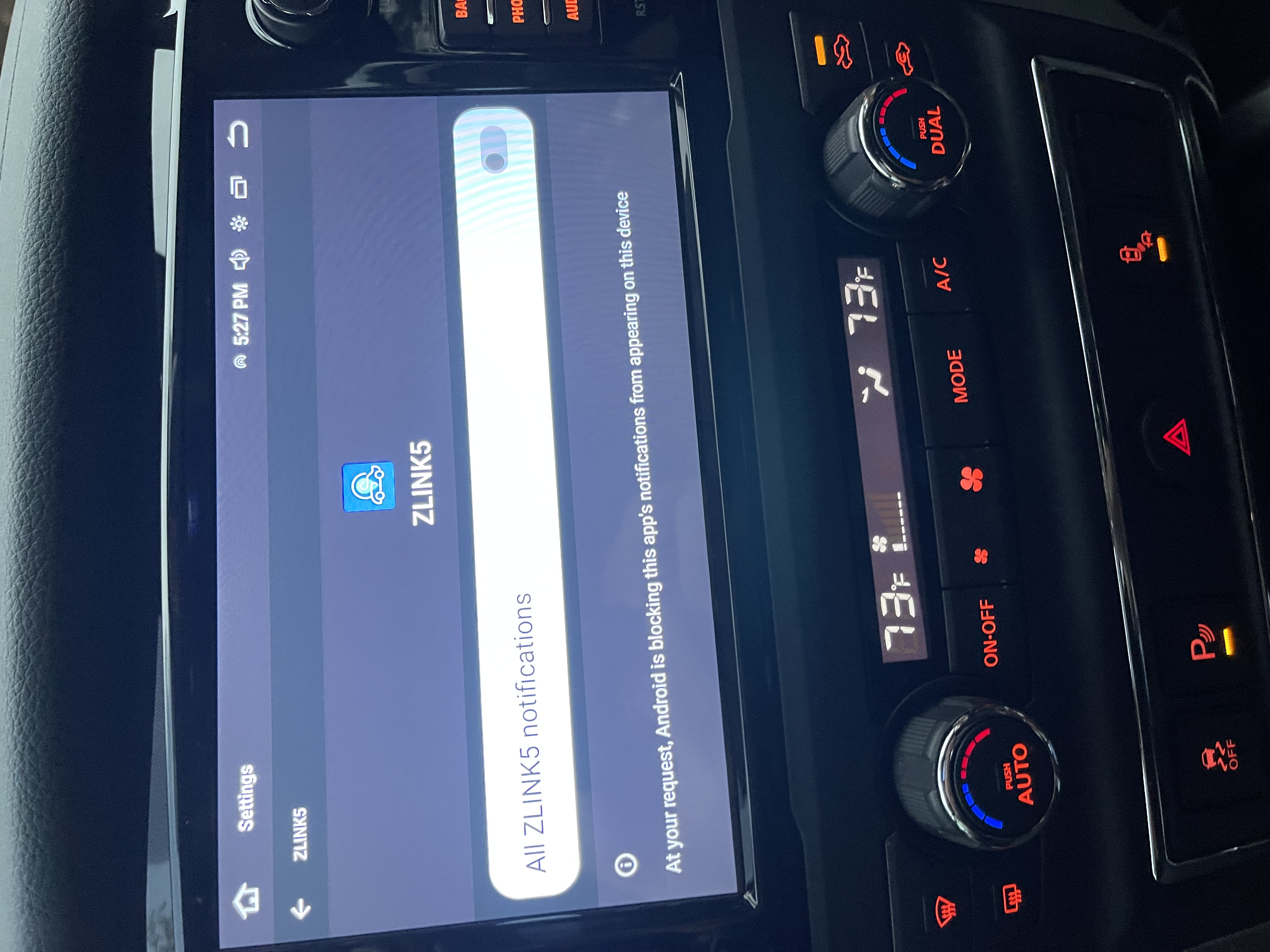

  • @Manuel Hermosillo Please go to Apps&Notification > Apps Notification to enable ZLINK's notification and check if the problem could be fixed or not.
  • Están desactivadas y no se pueden activar, aparece en gris y no deja activarlas!!

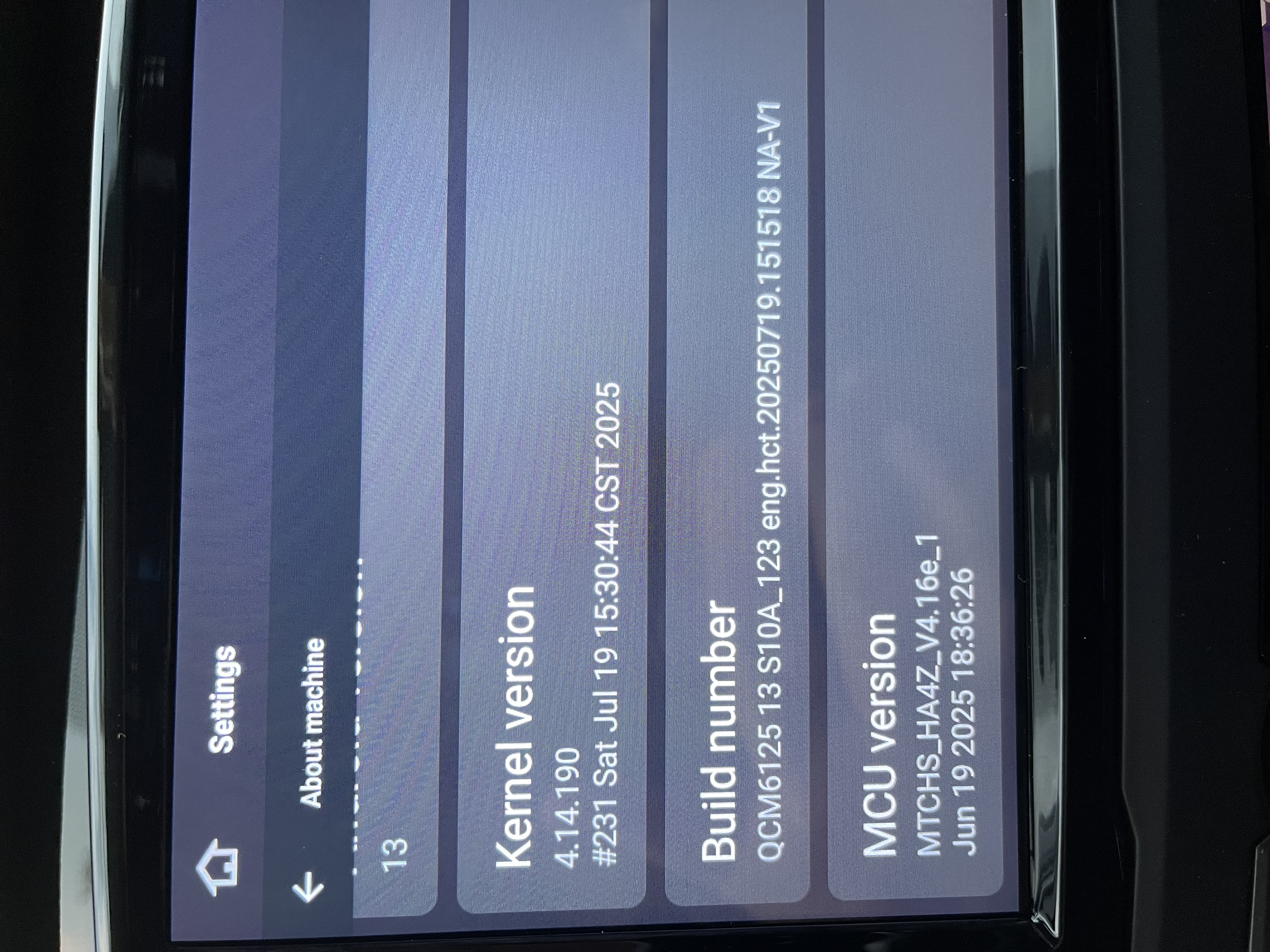

  • I am also having the same issue with not hearing Siri notifications. I just purchased Android 13unit for Nissan Titan (model QCM6125). Photo attached. Also tried going to  Zlink5 notification to enable but it does not allow to turn on. Please advise.
    Unit buildLink notification toggle
  • I am having the same problem. I just bought the Android 13 Unit for Nissan Titan 2016-2020 (build and mcu attached). I cannot hear Siri notifications. Zlink settings have notifications turned off, but I cannot enable (see attached).  Please advise.

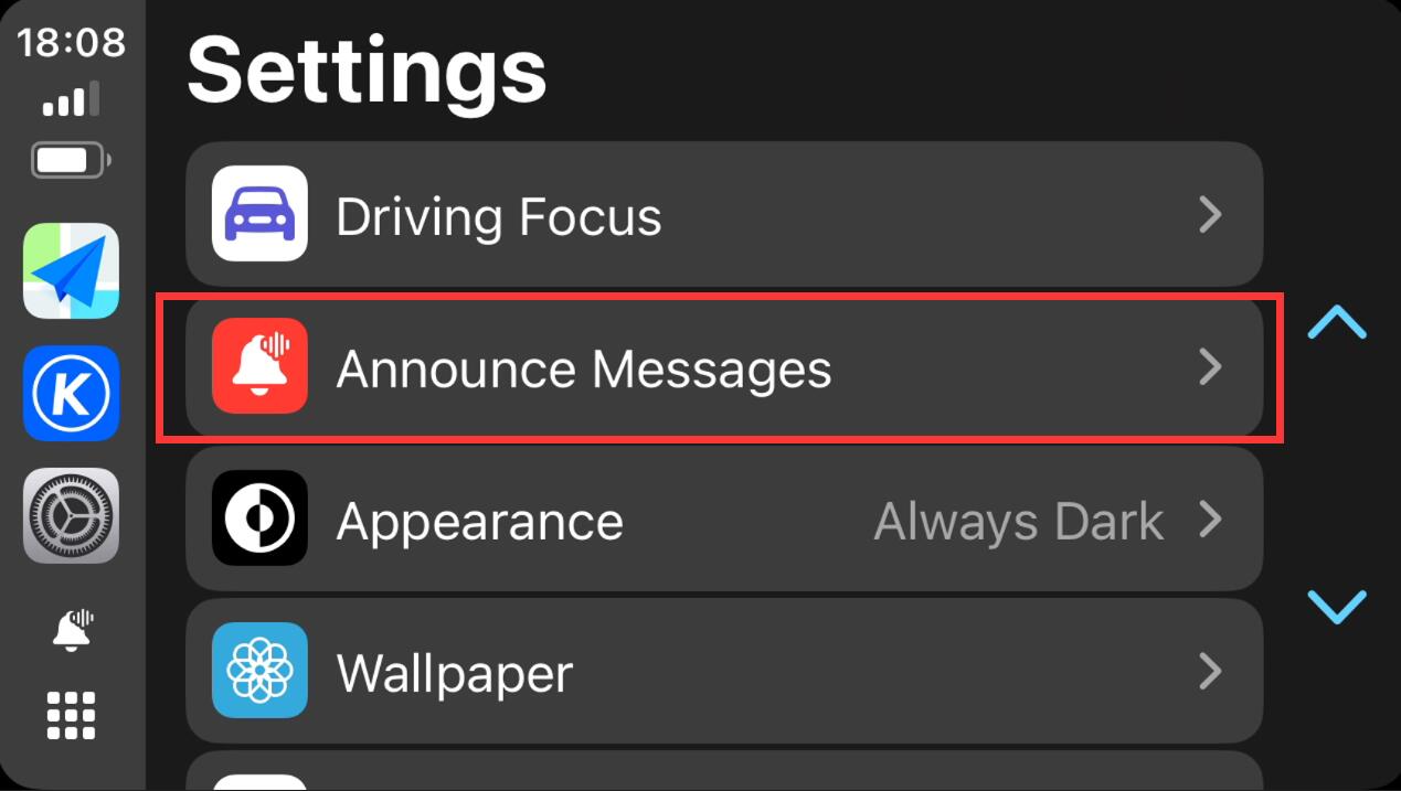

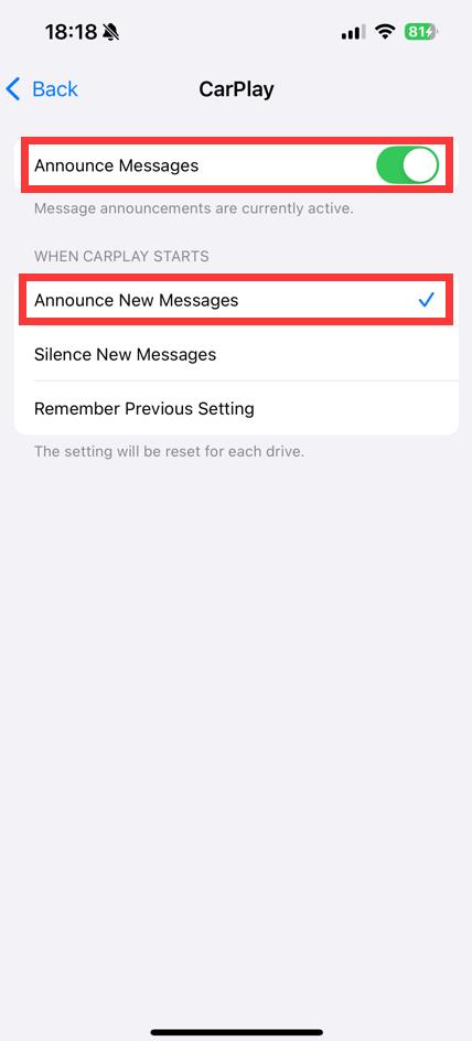

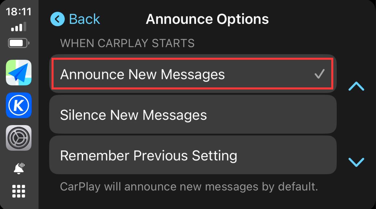

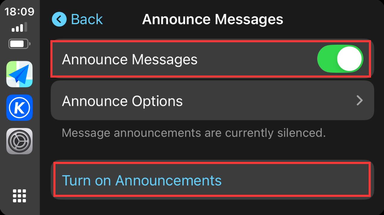

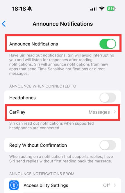

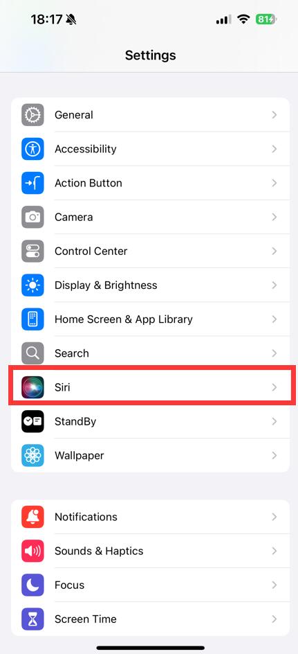

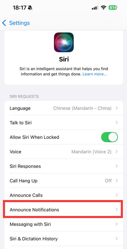

  • @James Molina
    Please try to turn on Announce Notifications on both phone and headunit.
