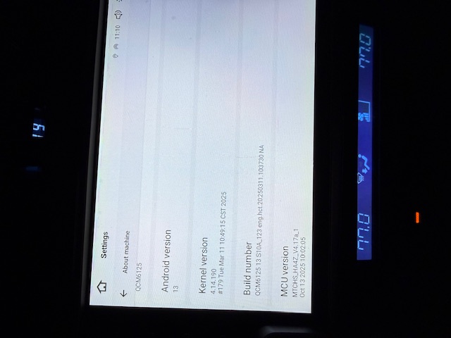

I have a G13 for a 2016 Toyota 4Runner Limited with JBL. I do not get notification sounds for text messages. I have tried to turn on the notifications for ZLink in the settings, but when I exit the screen, the setting toggles off again. I have tried downloding the firmware updates listed above, but I get the same result. Is there a firmware and/or MCU update that is specific to the unit for my 4Runner?
Thank you.
