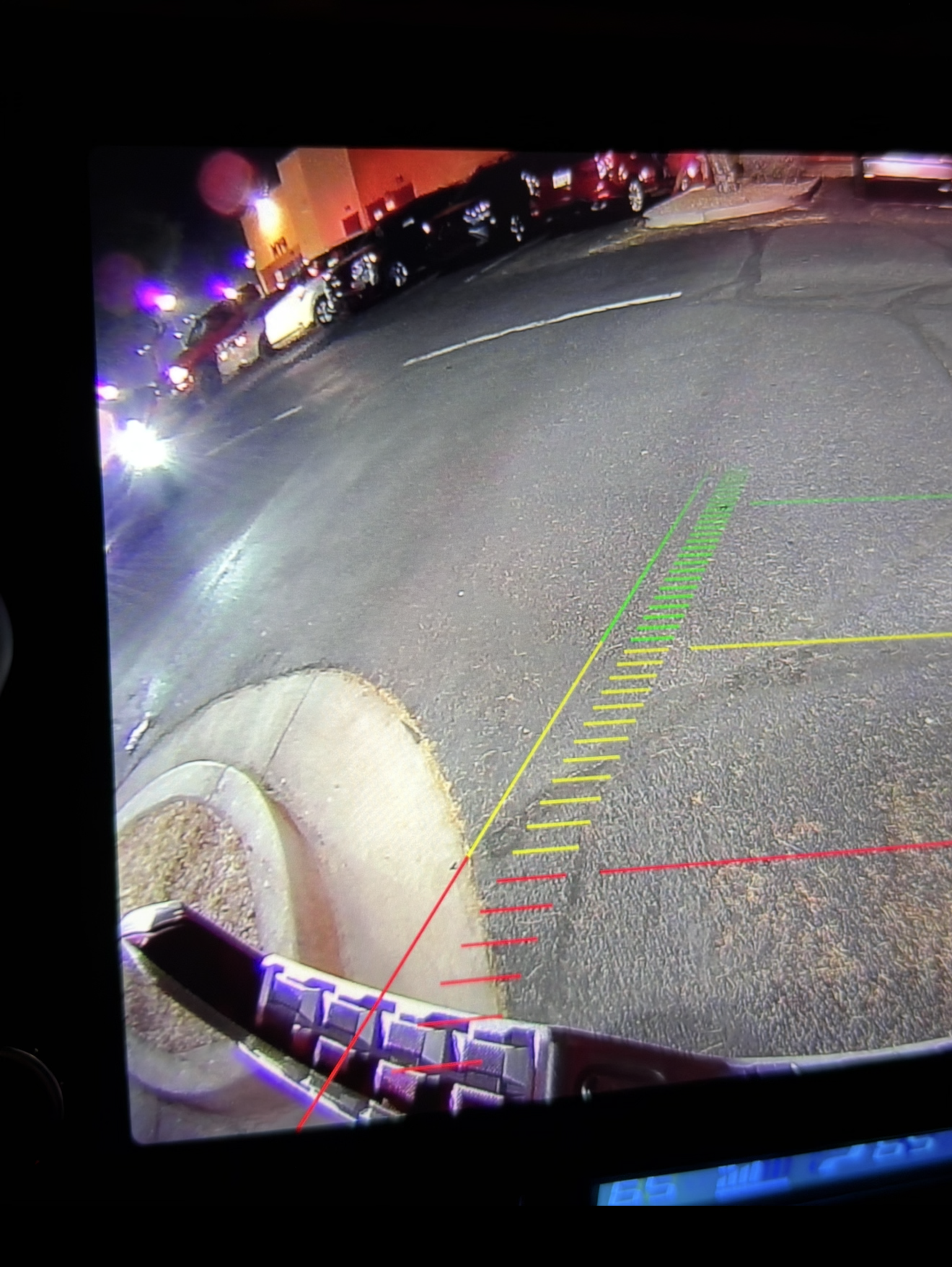

    I recently purchased and installed the Dasaita 1080p Backup Camera Toyota Tundra 2014-2020 Tacoma 2016-2020 in my Tacoma.
    I also have the Dasaita G14 11.6" Head Unit.
    The video feed from the backup camera has Ghosting and a slight red tint. In the photos you can see the ghosting/silhouette around objects. Almost out of focus. Is this a camera hardware issue or maybe wiring issue?
    I hope it's something simple as I have already run the power cable under my truck and up into the cab. Any info is appreciated. Thank you.

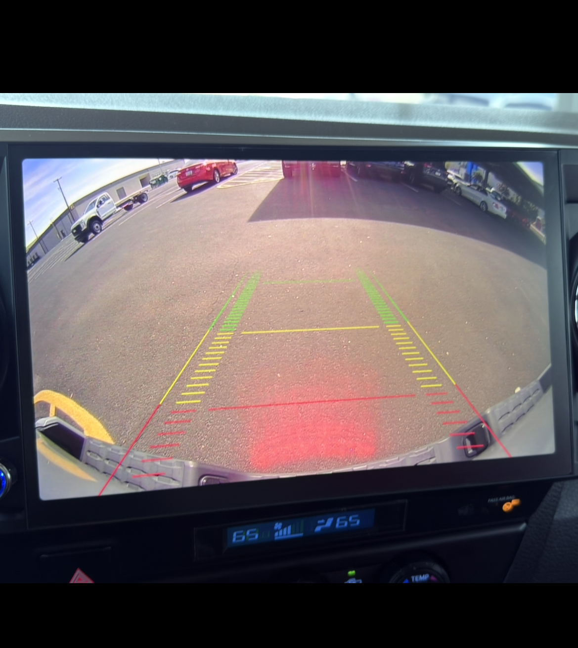

  • @Support Dasaita Hello, I believe I have solved the issue with the ghosting in the video feed. I will attach some new pictures. I will also attach a diagram I made showing the install/wiring method I used to get a clear video feed.

  • @Support Dasaita Hello, I've had the Dasaita Backup camra for about 2.5 months and the picture has been getting worse. There is now a reddish tint to the picture and any sort of light in both day and night cause a glare when attempting to back up. Is this a defective camera, lens or filter? Any information is appreciated.
