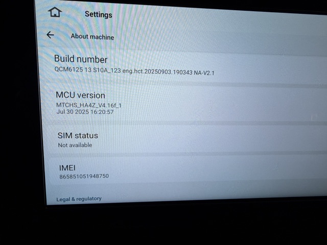

    Build # QCM6125 113 S10A_123 eng.hct.20250903.190343 NA-V2.1
    MCU Version # MTCHS_HA4Z_V4.16f_1 (Jul 30 2025 16:20:57)

    Build number: QCM6125 13 S10A_123eng.hct.20250903.190343 NA-V2.1

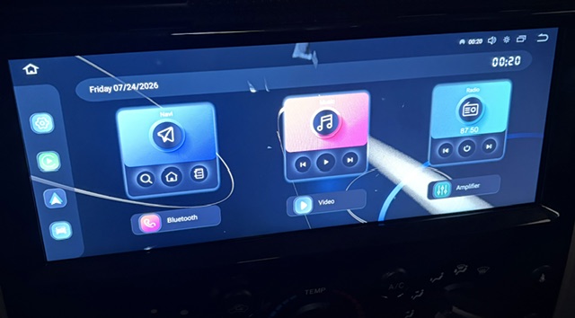

    I have sound only in the front speakers. Also, the radio does not detect when I go in reverse. Any recommendations on how I can resolve these issues.

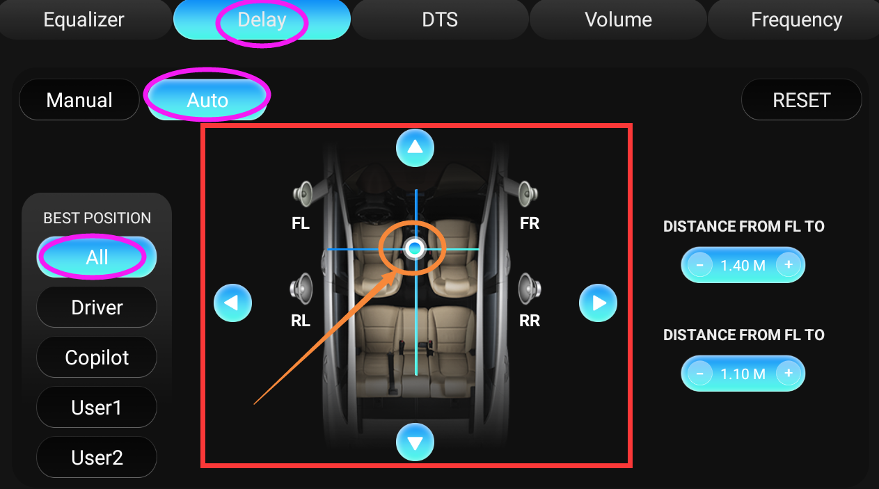

    Regarding to car with JBL, please try to go "Amplifier App > Delay > Auto > All" to move the crosshair to the center to check if all speakers have sound normally.

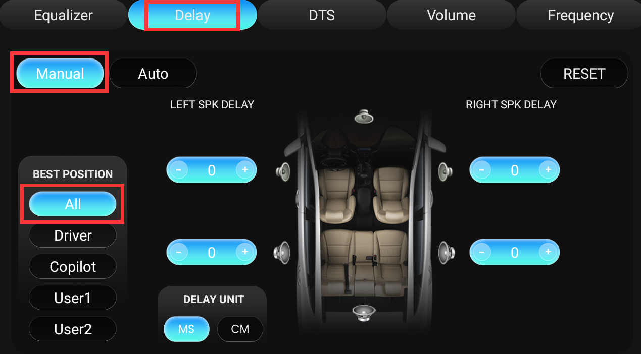

    If no luck, then please switch to "Manual > All" to see how it goes.
    To further confirm, please tell us what it shows on screen when you put in reverse gear.
    Is it an exclamation mark with black screen?

    Rear speakers are working, thanks for the assistance.
    Rear view camera: No black screen with an exclamation mark. If I have the normal boot-up screen loaded, when I place it into reverse, it changes the background. I hope that helps. I will also send this via email.
