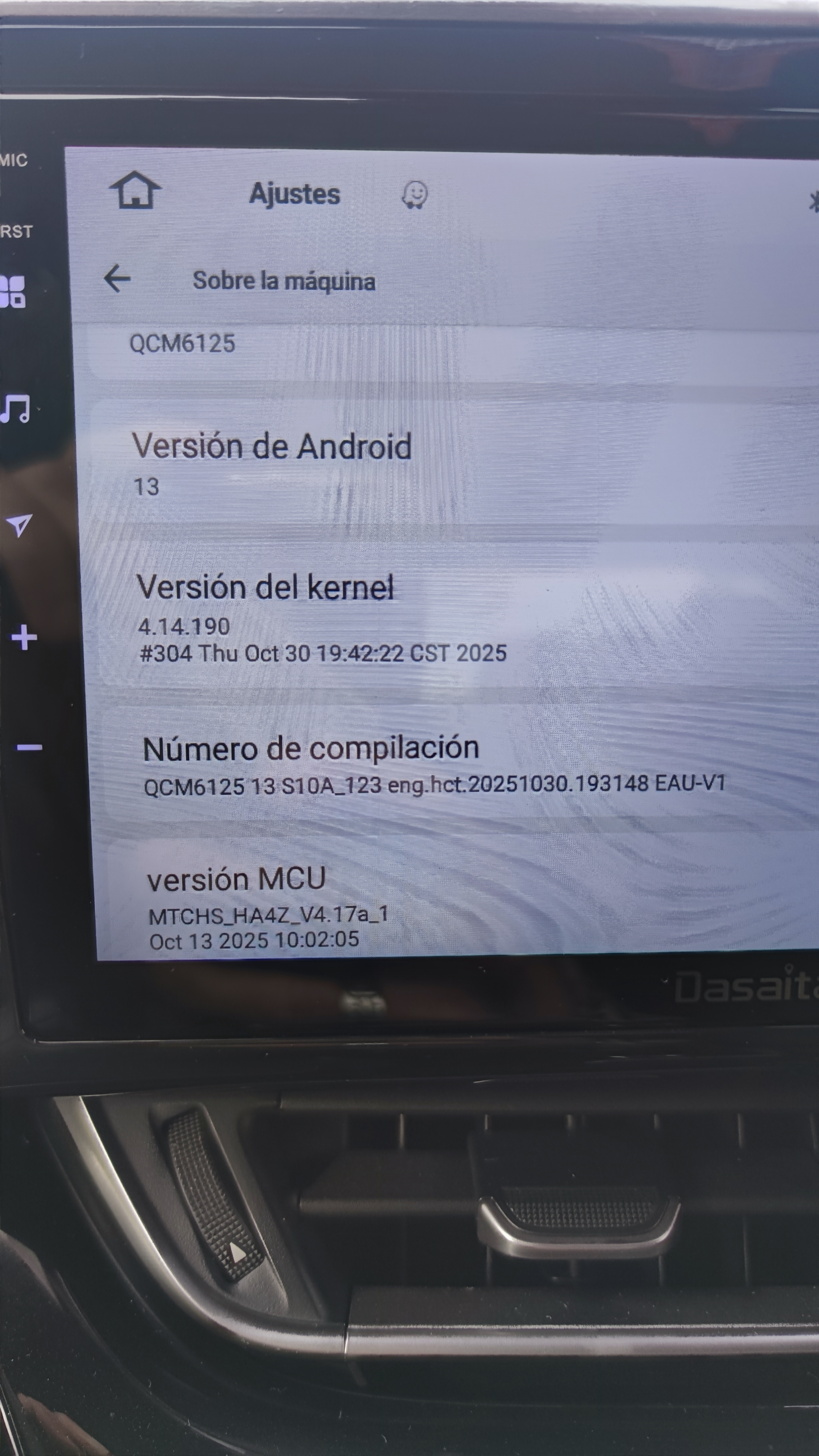

Upon checking, we notice that your photo still is the previous one.
Please go Settings > About Machine, then re-send the current Build Number photo to us.
So that we can confirm further.

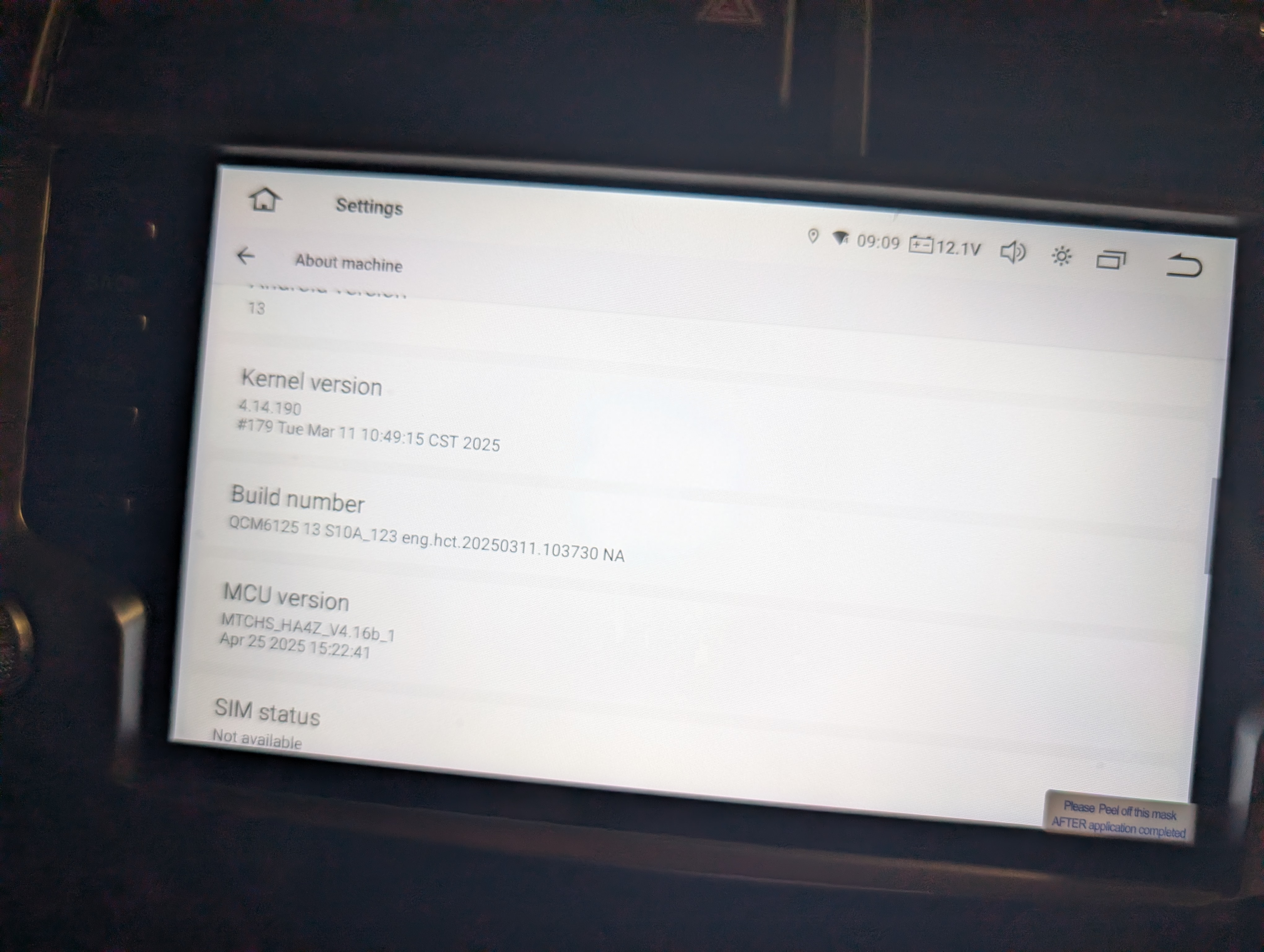

@Giovanni Carollo
@Support Dasaita
@info Dasaita
Good day, please see below screenshot after update.

@Javier Moreno
To further confirm, please go Settings > About Machine,
Besides, please send your Order Number & Purchase Date to us.

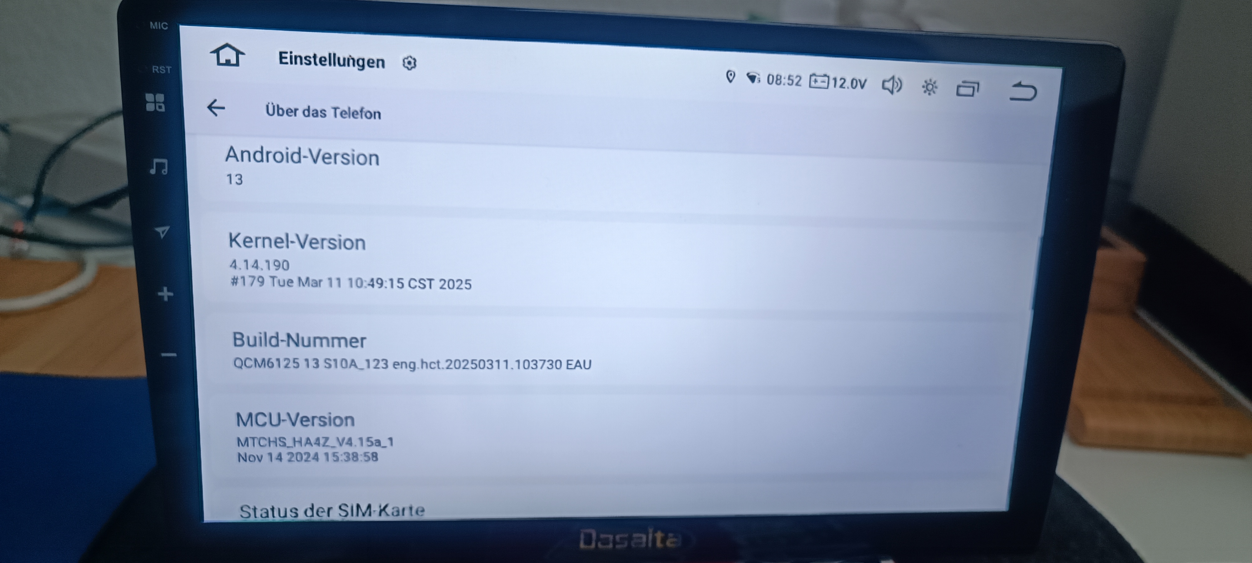

Welche Version muss ich denn laden V1 oder V2
@Javier Moreno
Thanks for sharing the pictures.
Upon checking, it is V1, and it already is the latest version.
@AO1967
Based on your picture, it is V1.
@Support Dasaita
Vielen Dank für ihre schnelle Antwort!.
