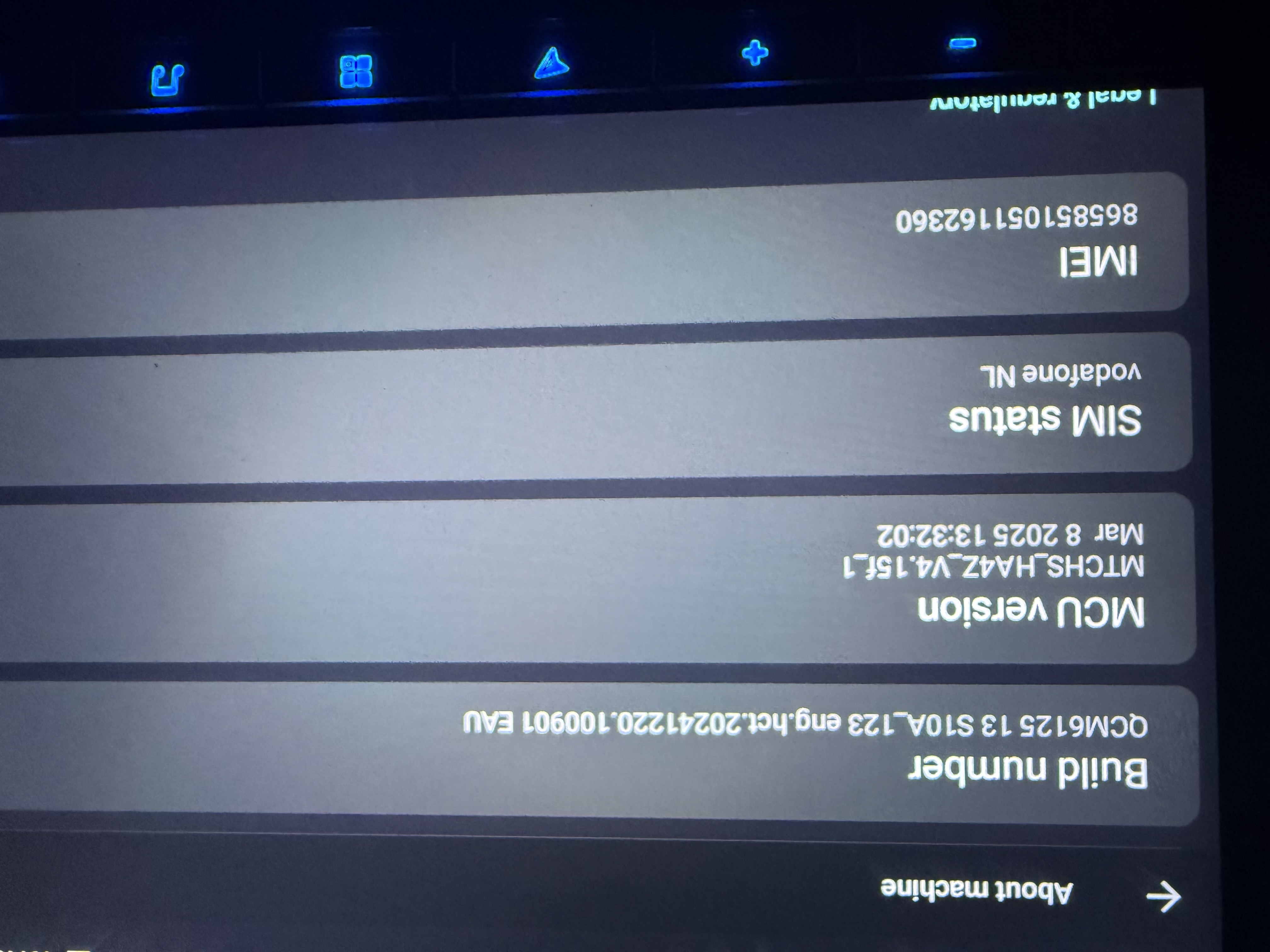

  • I’d like to update the firmware to Vivid 13 to improve the performance of the external microphone, but my build information doesn’t show a version number. My build number is: QCM612513 S10A_123 eng.hct.20241220.100901 EAU. Which firmware update should I download?
